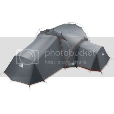

Update...More tent options
Just found this system from the North Face. ;) It is called the 'Docking Station'. It consists of the 6 man common area which can then have several 4 man / 2 man 'rooms' zipped to the 3 remaining panels...Pretty interesting to say the least...
Screen room with floor
2 person room attached...
4 person room attached along w/ a 2 person room...​
Quick dimensions:
Packed weight ~ 19 lbs. 4 oz
Floor dimension ~ 10 x 10 ft
uses 5 DAC 17 aluminum poles
Packed size ~ 12 x 29
Price point is very competitive...
The awning area is reported 79" tall...I bet I could put my Fold-A-Privy in the common area for my wife, as well as, the folding picnic table if we had too.
Very interesting...I'll investigate this system further...:popcorn:
