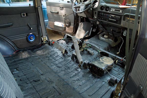

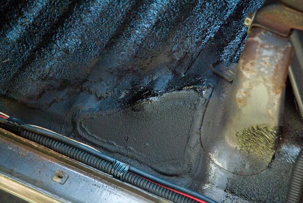

I had that rust spot in the floor cut out and welded closed this morning at Sunset Paint & Body, a place Randy recommended. The did it in a little over an hour and it cost just $35. Here is a pic of it afterwards, and then I a photo I took of the interior.
