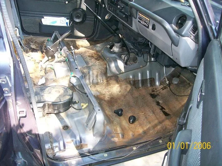

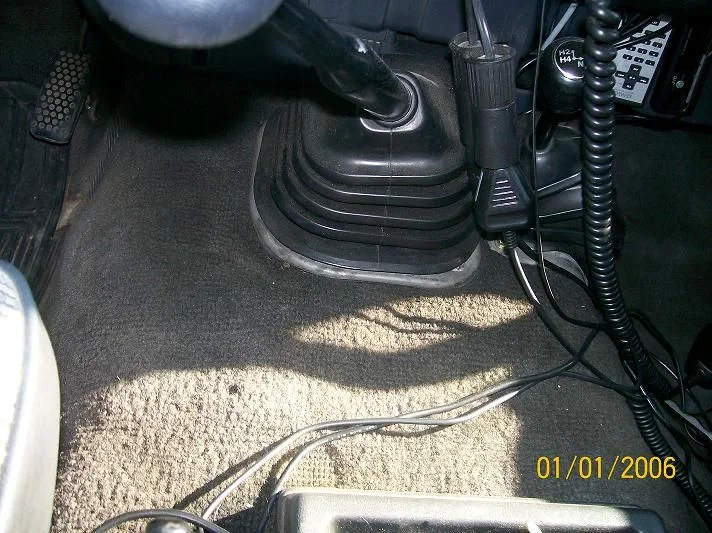

Ok Chris777 has decided he is tired of the old carpet. Part of this was due to the window leaking and a leak near the blower fan motor.

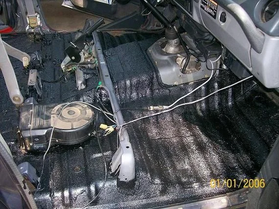

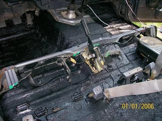

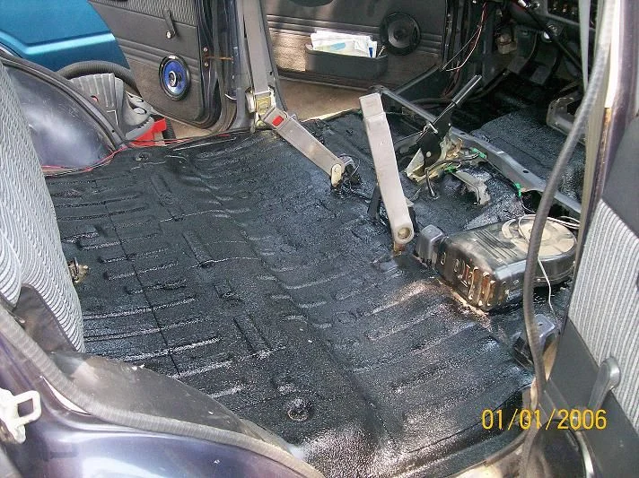

So, the plan is to remove the old carpet, Repair any rust that may have occured, Rhino line it and install sound deadner. Yes, there have been many threads on this but hey at least you know I am not sitting around doing nothing!:grinpimp:
It does both, It also makes for excellent adhesion for the new sound deadner going over the top off it. I used the HIPPO liner same stuff and it comes with everything you need and it only cost 78.00. the 1 QT kit did the whole floor board in 2 heavy coats.
so you put the rhino liner on there and then you're going to put some type of sound deadner? Then new carpet ? or just leave it at that? My front section of carpet really neeads to come out and hit the dumpster.
*&^% to many projects!!! Whats an idiot to do :)
You could leave it or put sound deadner over the top. We are using Secondskin Sound deadner for this. It is cheaper than the Dynamat. But the liner alone would stand up to anything you could throw at it. It would be perfect for someone who really doesn't care about carpet.

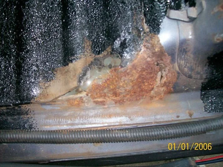

Next two things I have to do is have that rust spot he found, cout out and welded, and second, have some of the metal trim that holds down the rear carpet down, have it powder coated.

I would not count on the rhino to stop rust... unless all of the really correct and thorough prep and preventive measures were taken prior to Rhino application. I saw a 40 with it on the inside of the tub and the outside of the tub, that in some areas the Rhino was the only thing holding the thing together... it blew up like a baloon with the rust between the layers.
Just my 2 cents.
All the surface rust was treated prior to applying the rhino and the rusted through portion will be cut out and repaired. And yes I have seen the rhino liner hold a truck bed together that had rusted through underneath of it. Very good point srplus. Treat it now and no worries later:beer:
