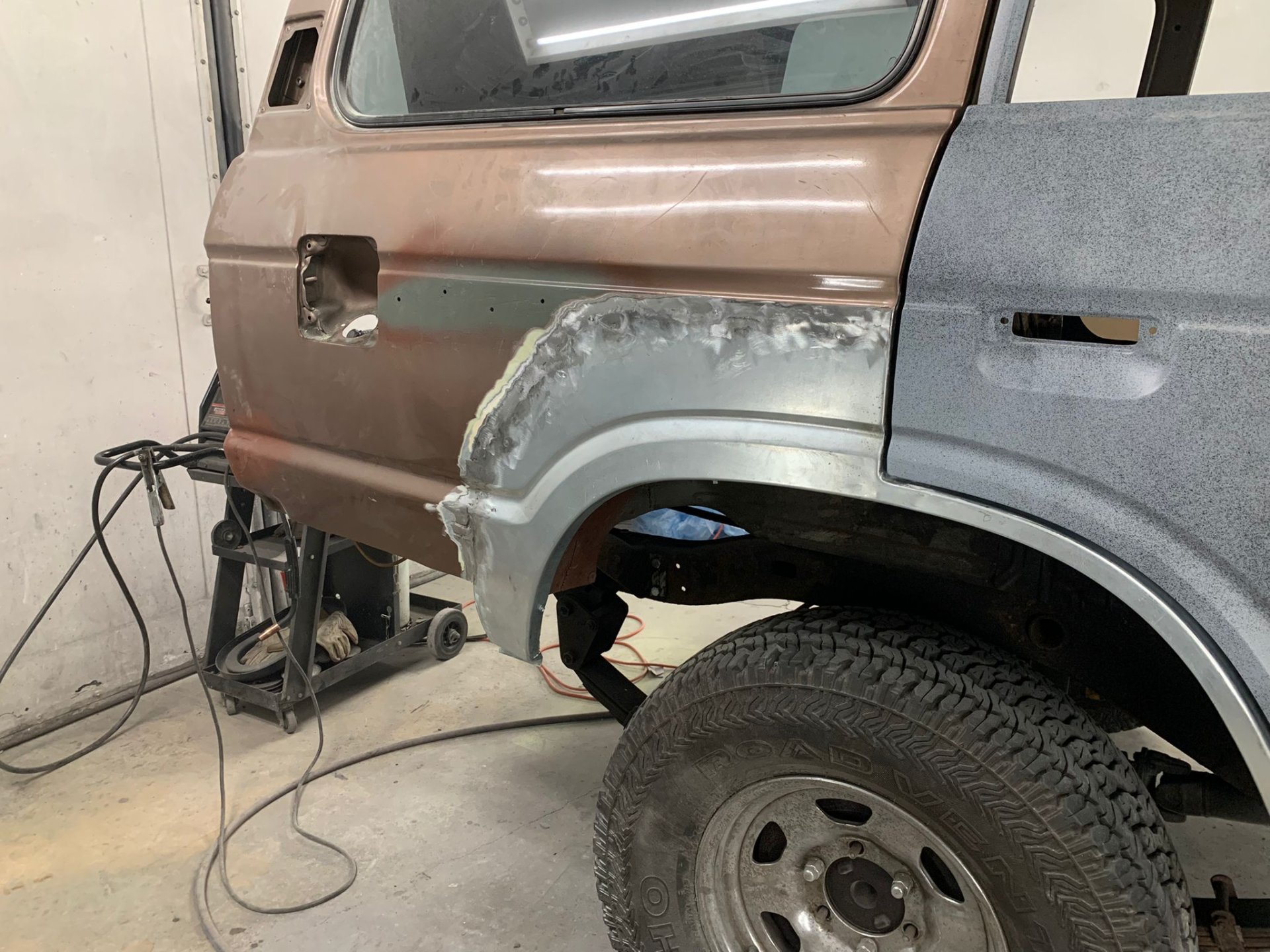

In the second pic you can tell that that fender had been repaired before. Twas a bunch of bondo and such on it.
Pass rear quarter needs to be entirely redone. So that's a setback, but hey, patience I have. Also, not sure bout the hood hump. I think I will paint my spare good hood and keep aside. Have the current one done in flat black and should I ever be able to source a turbo manifold to relocate the turbo down low, I will swap the hoods accordingly.

Been a but busy lately bu5 got a couple more updates. The trucks body work is almost done. Will probably be ready for paint by next weekend.
The trucks been at the shop since Feb 2nd. Almost ready for paint.
Little more progress, some things had to be undone and redone.
