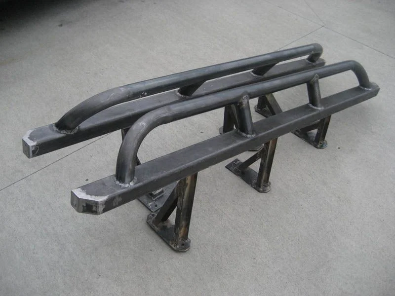

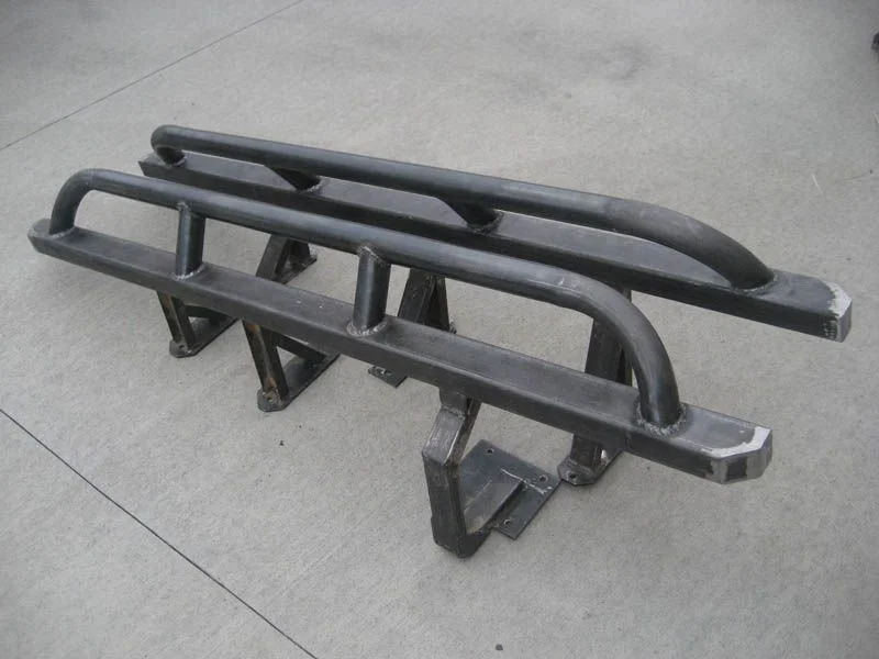

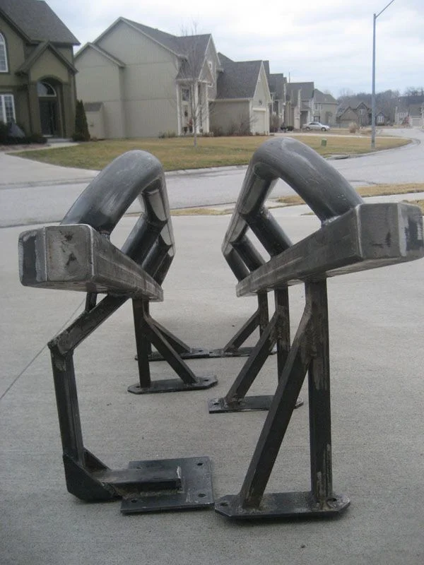

Well, Jason (MoJ) and I finnished up his sliders this weekend. I wanted to post them up and share with everyone. Would love to see what you guys did a the wrenching weekend at Chris's. Jason's rig has side by side cats on his 94' FZJ80 so his cat bracket is different than mine. But the rest is the same.

Nice work! What type of tube bender are you using? Also, what method did you use to notch the tubes...hole saw?
Thanks to Rob Ridgway for helping bend these with his 2" Die on his hydrolic tubing bender. Also used a hole saw with a jig that Rob had on his drill press.
