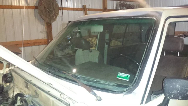

I used flexitrim for my 4Runner's windshield. Found a 16' roll of the 26mm thick trim at a local auto glass installer for about $10. The installer used the black windshield FIPG stuff to seal the windshield and used the flexitrim to replace the chrome rust trap trim. Looks a lot better than the old chrome trim IMO and was much cheaper than the seal from Australia.
Part number for what I used is: FT2630-SA

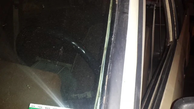

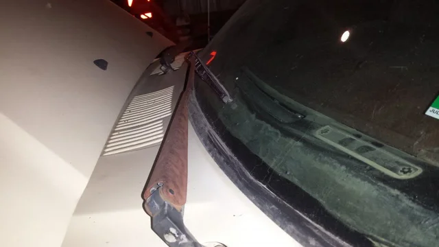

A little creativeness...
There was rust, but not bad really. So now to repair. It was every place there was a clip.

Anyone know the best way to remove all the old rubbery glue so I get to the metal? Wire wheel I'm assuming.
On the windshield frame? I was able to scrape almost all of it out with my MultiMaster and a scraper blade, then get the residue with a knotted wire wheel in a grinder
Yes sir the window frame. It's almost gone and I was thinking a wire brush for the rest. I just wanna be sure there isn't any rust under any of it.

Waiting to hear back on a seal to put around the windshield. Hoping to avoid using the chrome again, it's on hold for a week or so. I'll drop a diesel in it after I'm in Honduras for awhile and till then it'll be slow and steady!
