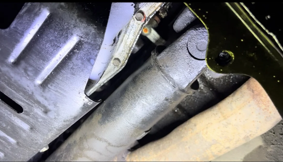

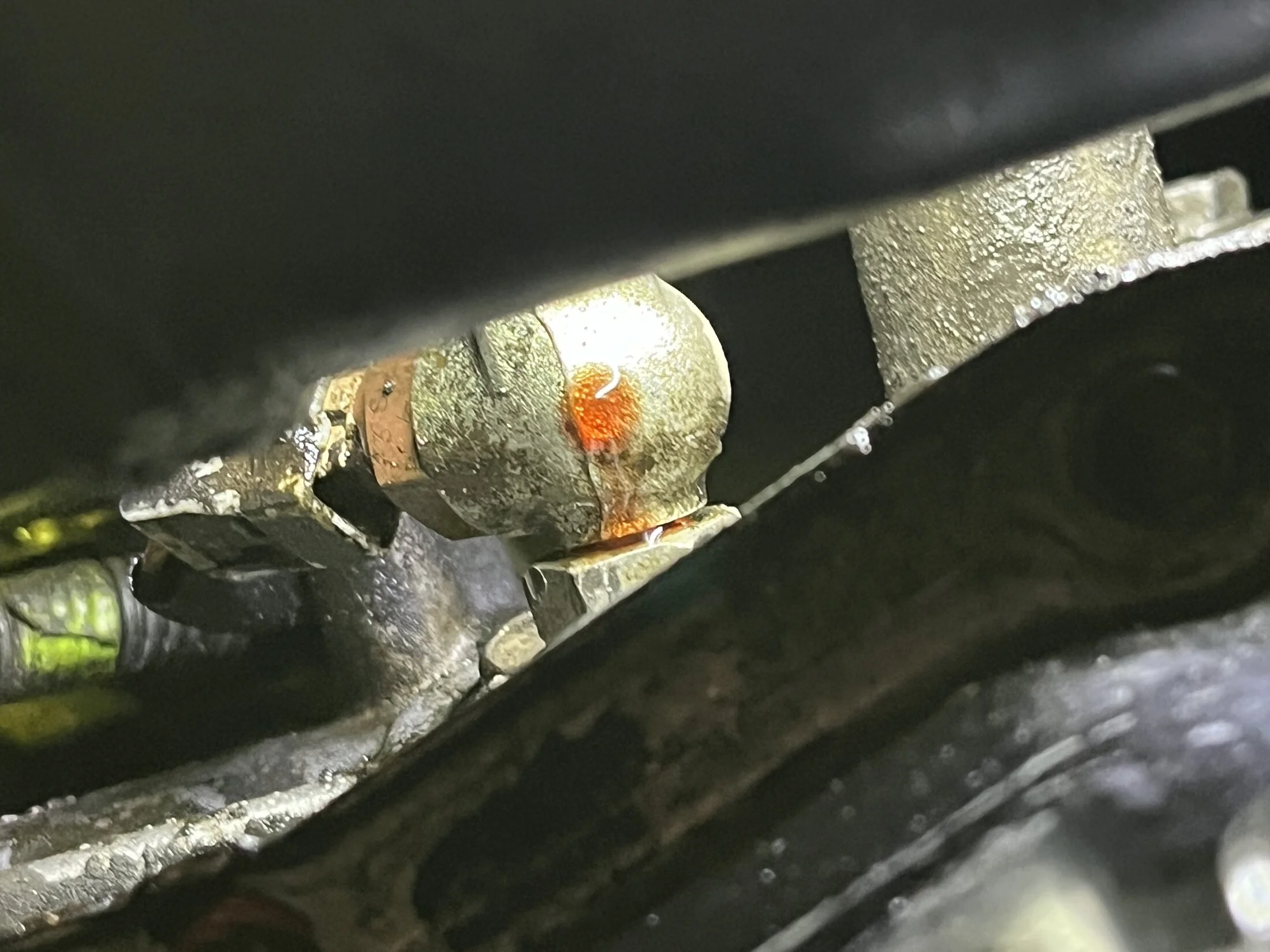

Ok, got back from the mechanics…it looks like a transmission line is gone and it’s leaking ATF on the ground. He was pretty honest about it and said he had to take the exhaust down and will fix it. Pretty annoying but what can I do anyway, maybe it was that old it broke when he pulled the tranny out.
Now what concerns me more is that although the truck seems to be shifting gears nicely when driving, the gear shift lever feels different than before and makes a pretty loud rubbing sound when shifting gears. I showed him and he said this was just the plastic rubbing against each other but it was never making this sound before and the reason it does now makes me think it’s not engaging gears as smoothly down the tranny.
I’m pretty desperate after spending all that money to find my rig like this. Do you think the leak of ATF could be making this sound and make the shifting a bit rubbery (although car drives ok), or is there something that’s not properly put back in place down the tranny…
Really appreciate your help with this, wish I could send a video of that sound
other than the gear shift lever feeling/sounding like this I can’t really hear any sound coming from the transmission itself and it really drives normally.

@jeanbono : it's a bit hard to follow, can you give us more information?
Which transmission line was damaged: location, hard line (pipe) or soft line (rubber), on the right side of the transmission (A442F) or??
Was the transmission pulled from the vehicle?
How was the line damaged??

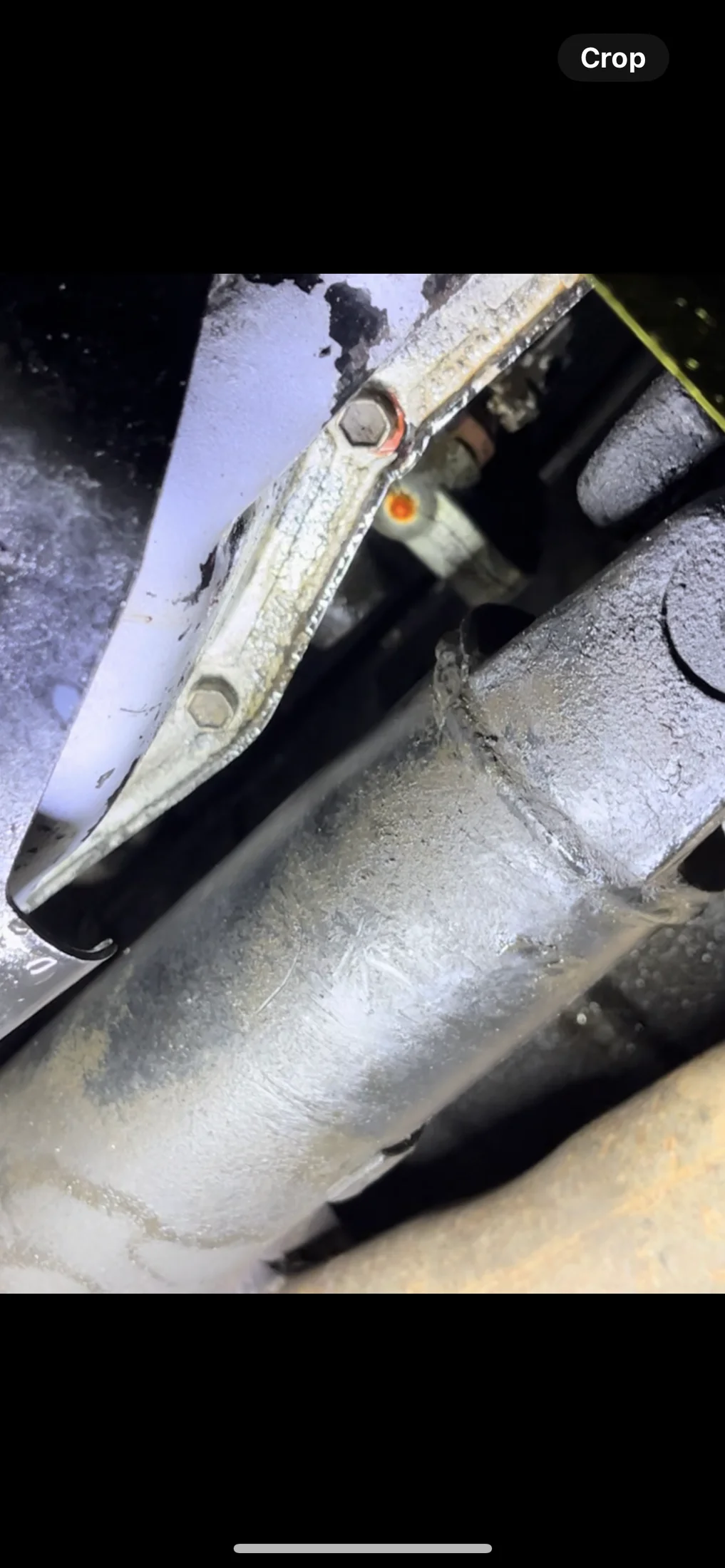

In post #34 what are you trying to show us (maybe take a photo from further back)?
About the noise, does the noise occur in all gears or just when you first move the shift lever out of Park?
Can you describe the noise; scraping, squeaking, squawking, rattling---??
Does the noise occur when you shift back into Park (or any other gear)??
Apologies for the confusion and thanks for asking:
-rear main seal was leaking so mechanic dropped transmission and replaced seal
-when I got the car back he told me a transmission ATF leak had developed. He said it was from a transmission line and he just needed to remove the exhaust to fix it but only next week as super busy. I unfortunately don’t have more info regarding what’s causing the ATF leak but he seemed confident it would be an easy fix, it’s dropping from that spot I posted a picture above, right over the exhaust line, I will send a few more pics.
-regarding the noise, I have uploaded a video on reddit (not sure how else I could share here):
The sound occurs for them all. I dont hear a sound coming from the transmission itself (grinding etc) but just shifting gear with the lever makes this sound and feels a bit sluggish (still shifts fast, just never made that sound). Is this related to the ATF leak or something bigger. Because we made sure the level of ATF was full before I left the garage to drive 15km and it was already making the sound

hey mate, definitely a hard line, it was right over the exhaust. Sorry it was not clear. He said he most likely needed to order the part to replace.
Took another picture from further away.
Most concerning thing for me in that shift lever feels/sound honestly.
