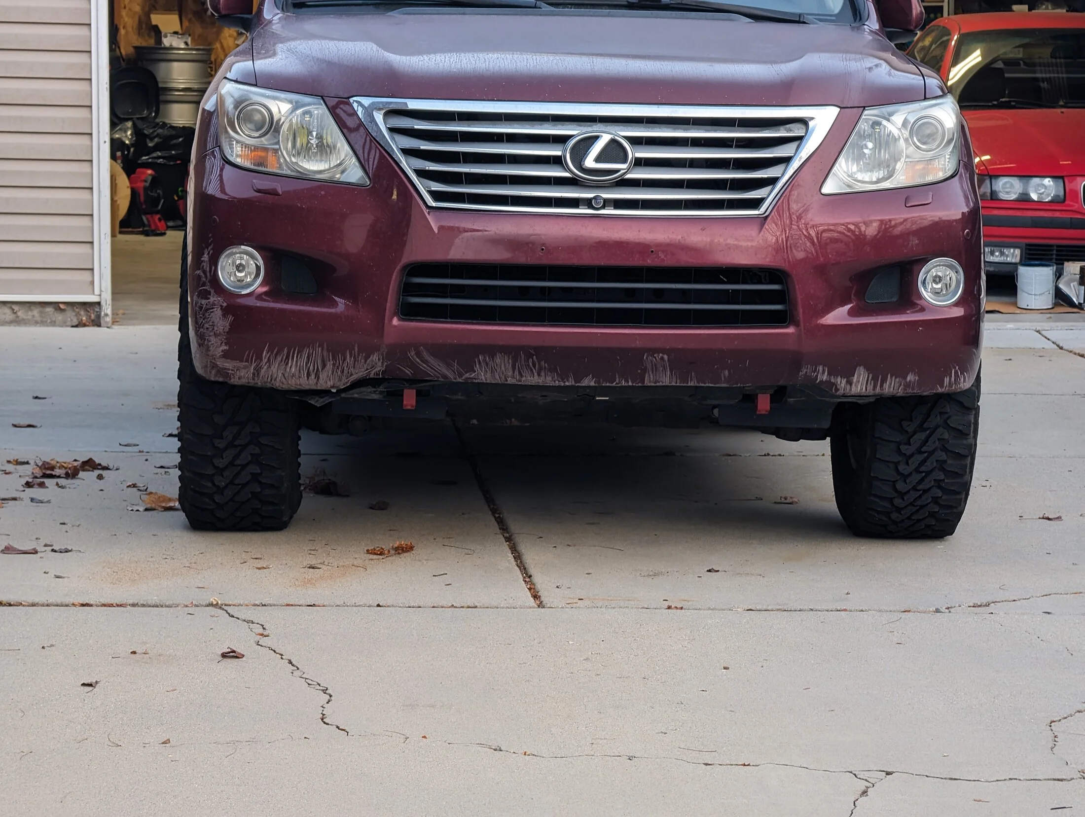

My policy is just let em scrape. Once they won't hold on anymore, I'll drop the gajillion dollars on a fancy bumper. This picture was from 2023, it's more scraped now and no closer to falling off.
