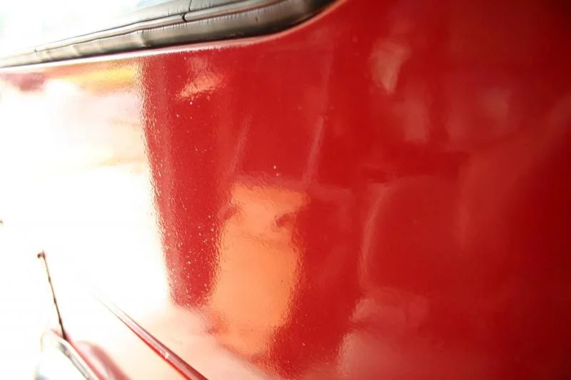

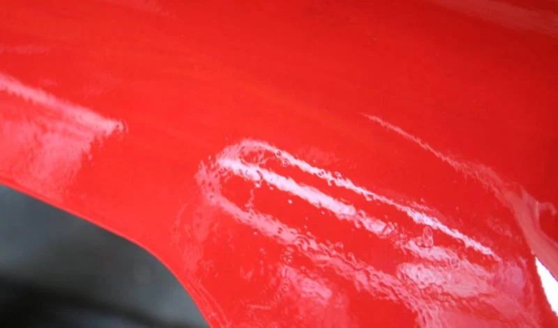

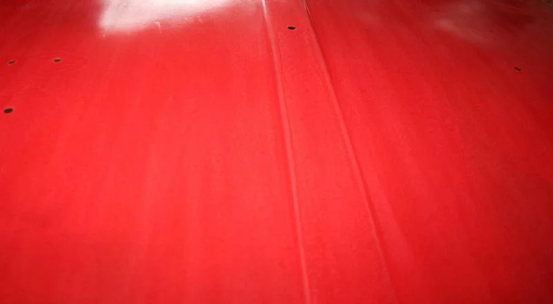

As promised, here are some updated pics of the progress on the hood and a couple before and after shots of the top.
Enjoy. :cheers:
The first pic is just after sanding the first two coats with wet 600 grit.. It appears to be rough, but it is actually quite smooth and level; perfect for the next coat.
The second is a view of the center section looking toward the front.
The third is the full view. You may notice that there are dents in the hood (discussed in another thread): I decided not to try to straighten it out since it is much better than what I have now, and I am not tooled up to do the job. :p

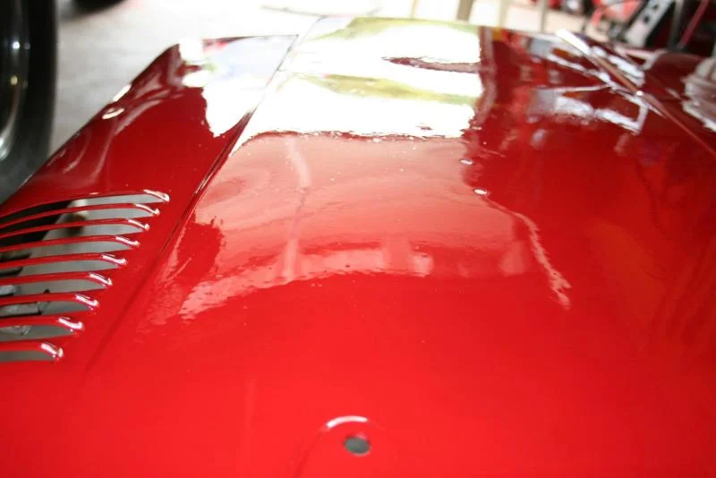

More...
The top picture gives you a good idea of the texture prior to applying a fresh coat.
The second is just after a fresh coat. Shiny!
The third shows just how rough a fresh coat will appear after rolling it on. All of the roughness settles rather quickly, which is due in part to the thickness of the paint. I used an approximate mixture of 1:1 mineral spirits / paint, which seemed like too much thinner, but ended up just right. If I had not thinned it as such, the bubbles would remain: too much thinner and the vertical sections would run. It is a bit tricky to get it just right, but ultimately I just started with 1:1 and added paint to thicken it.

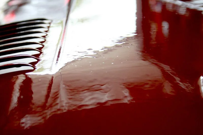

More...
The top pic is a better example of the texture after a fresh coat, all of which levels out nicely.
The bottom pic is also after a fresh coat - it too leveled out pretty well after about a couple minutes.
