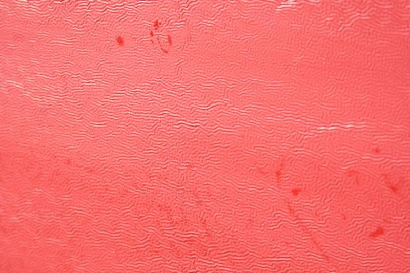

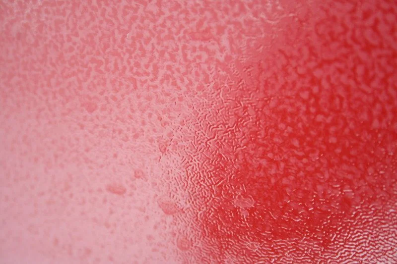

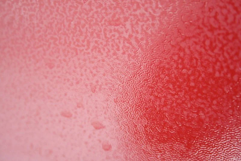

I just got finished painting the Ht on my 40. Everything looked good while I was painting it, then this morning I had a whole lot of orange peel. How does this happen overnight?
I used Rustoleum Regal Red over primer, which was wet-sanded and smooth upon application.
As the title goes, now what? I have wet-sanded using 600-grit to remove many of the spots, but is there by chance another way?
Thanks in advance.
Let me add that the paint does seem to still be soft - now 20 hours later. The paint seems to be reacting to changes in temperature: whereas one area did not have orange peel, now it does since the ambient temperature is rising. Does tempurature have anything/everything to do with it?
That is beyond orane peel, it is almost a wrinkling or folding. Did you use a catalyzed paint? Are you using acrylic enamel? Is everything the same brand, from the same supplier? Temp will normally not cause the problem you have, although the reducer should be keyed to the temp when spraying. No way it should be soft if you're using a hardener (catalyst). Once it's on there, you're toasted. Do not wet sand until the paint is hard. How great is the temp swing?
I apologize for not being clear in the beginning: I am using spray cans.
I figured it was beyond orange peel, but did not know what else to call it.
I used the same color, brand, etc. all the way through the job.
The temperature was 78*F when painting and is now 98*F in the shade, where it sits currently.

I did apply some thick coats - apparently too thick. The paint was going on so well, and without running that I thought it was OK to lay it on a bit thick. I painted the rest of the truck about a year ago, but had to use thinner coats since I was using a different paint brand.
I am not going to sand down and apply new coats since I used the last of the paint already.
I guess I have a lot of sanding to do to get it looking at least halfway decent.

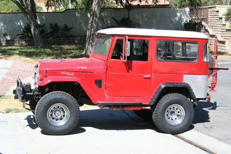

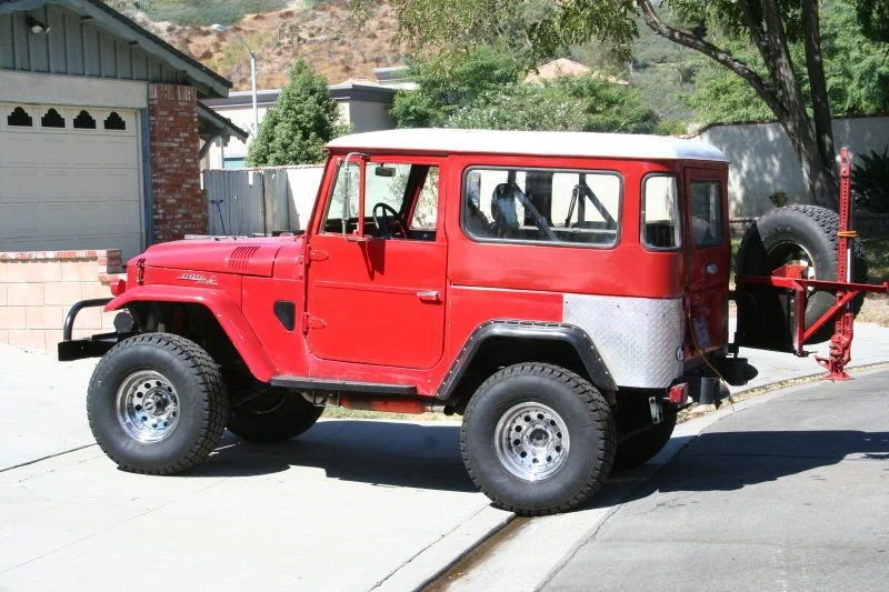

Might as well show the rest of it...
Here are the full pics of the rest of the rig the day following the job.
