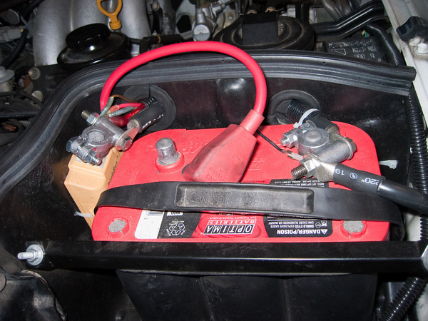

X2, I've been running a 34R in mine for years...you will need to have a spacer underneath to raise it, but the reverse post (R) will line up just fine.
You shouldn't have had to stretch anything that much and the stock retainers should be what holds down the battery. When I originally just had the yellow top that is exactly what I did w/o any stretching. The trick was to pull the black box for the fusible links through the grommet and into the battery tray.

Sorry to hi-jack the thread, but is that the stock battery tie-down shown in the pics? I just bought my LC and there was nothing holding the battery down. Really big Lexus battery installed.
I bought a generic kit and made it work. Eventually I plan on switching out for a Marine battery. Also those urban Cruiser kits look nice. I might as well go back to stock on the tie-down.

And yes, that is a stock battery hold down in all the above pics. Works with the Optimas, but not with the Platinum DieHard Group 31.

Yes. Call Cruiserdan and tell him you need the hold down, both J hooks and all 4 nuts. Odds are he has the part numbers memorized.
