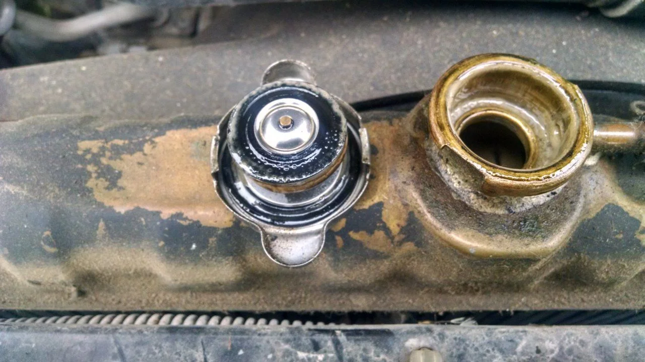

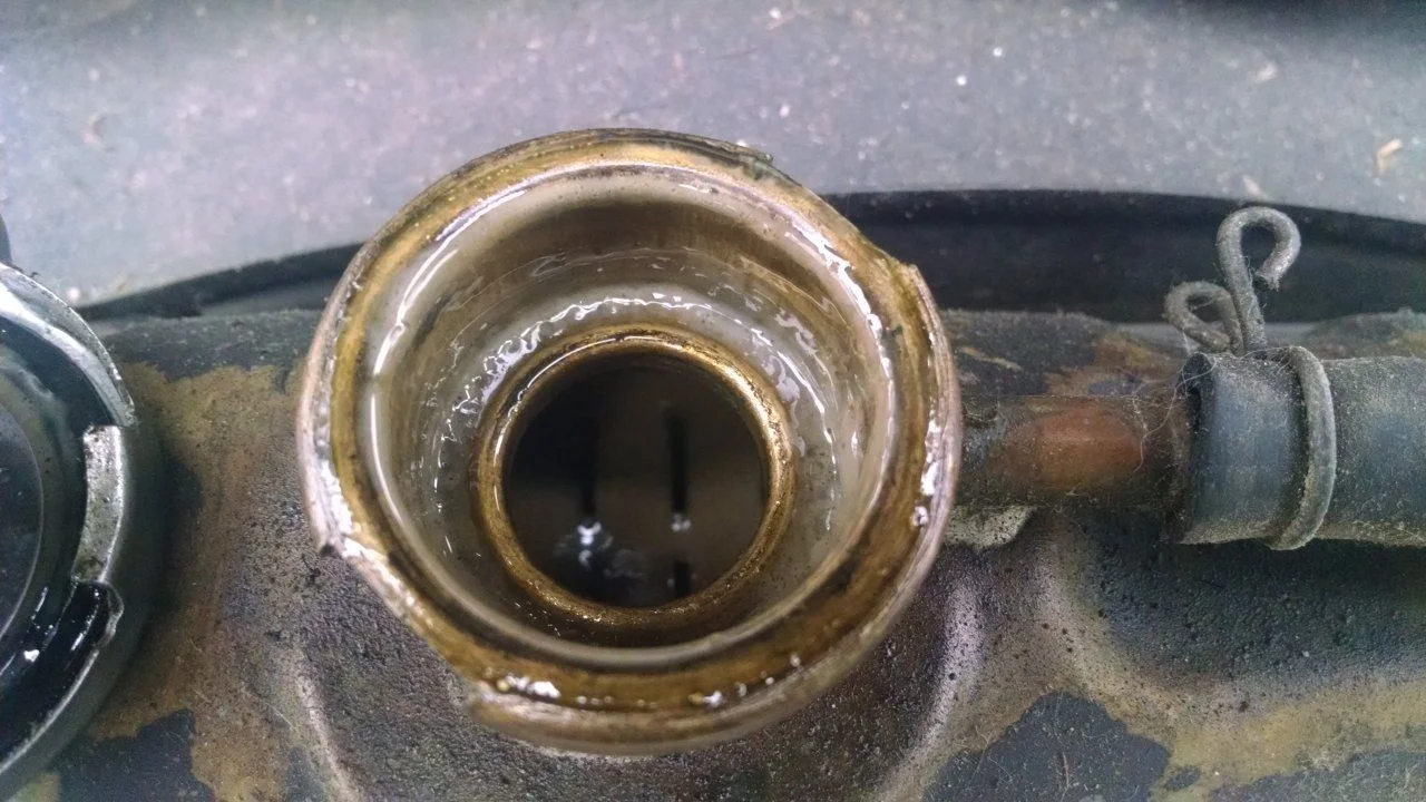

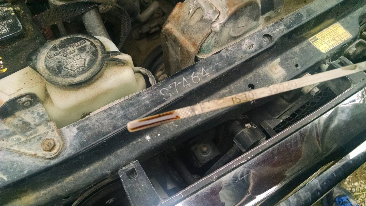

It's a 91 or 92, I4, 5spd, 4x4 but there is oil in the radiator. There is no oil in the pan. Guy wants $500.00 for it. I haven't seen it yet. I plan to look it over Sunday. How does oil get into radiator, but no water make it to the pan?
Well, 80 series have issues with getting oil into the radiator. Thought it was head gasket issue.
Bad headgasket or cracked head could cause this potentially. If hes wrong and there is coolant in oil, the most likely culprit is the timimg chain eating into a water jacket in front cover when stock guides break.

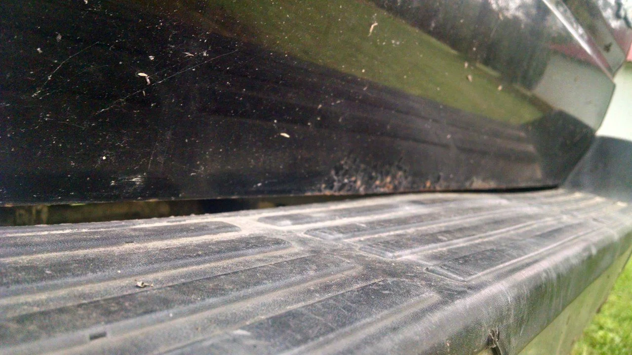

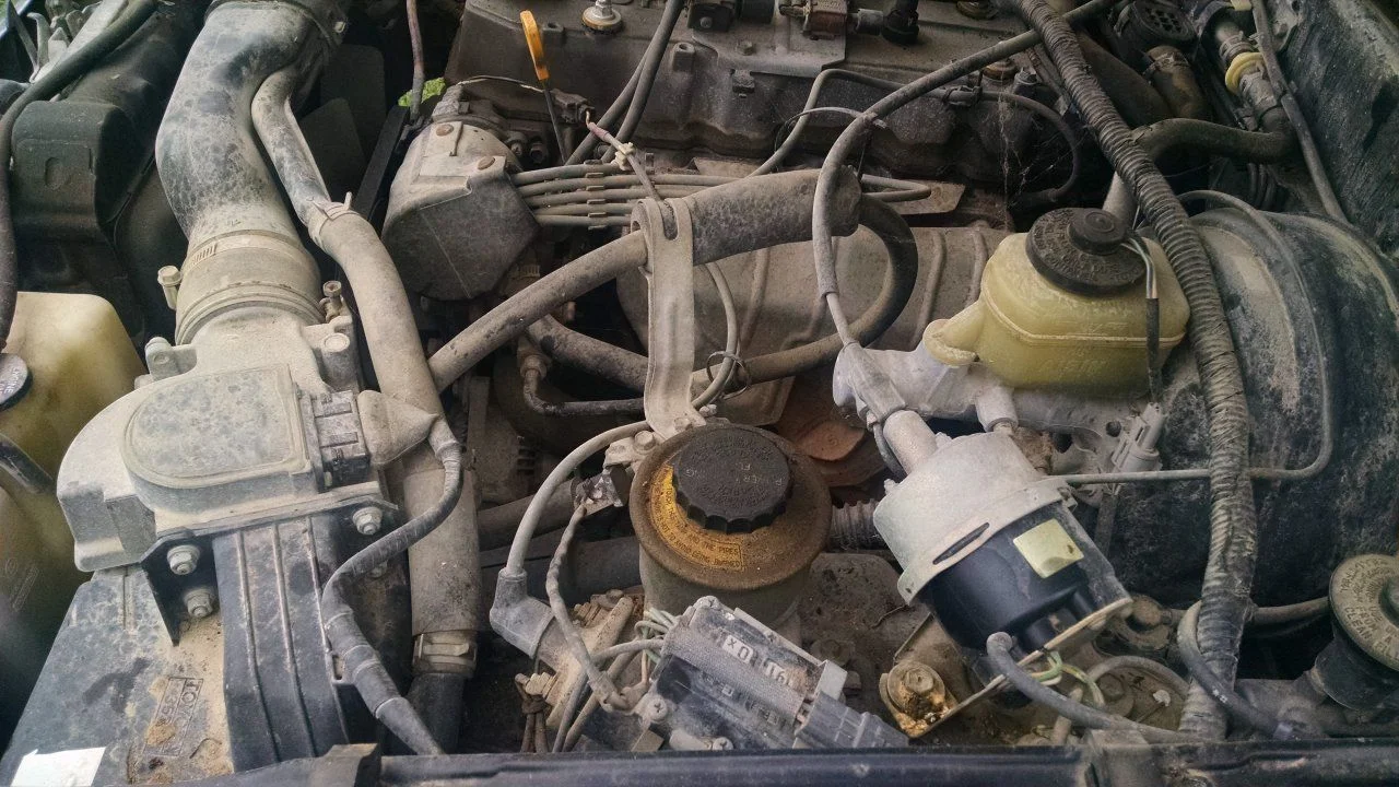

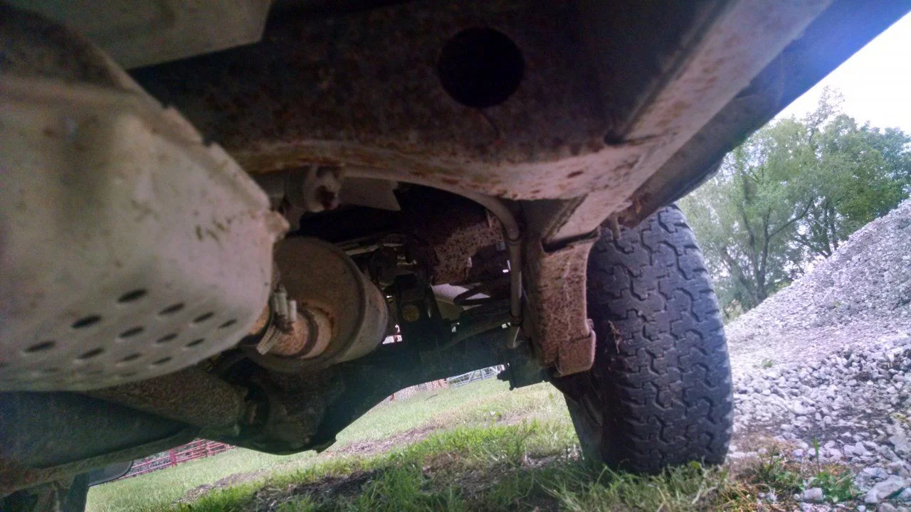

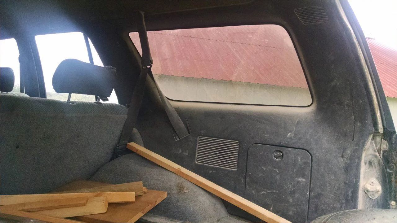

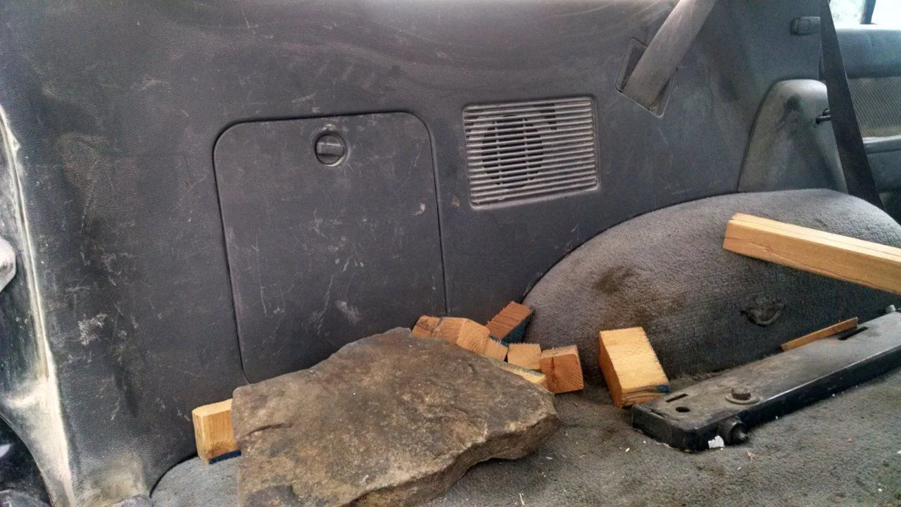

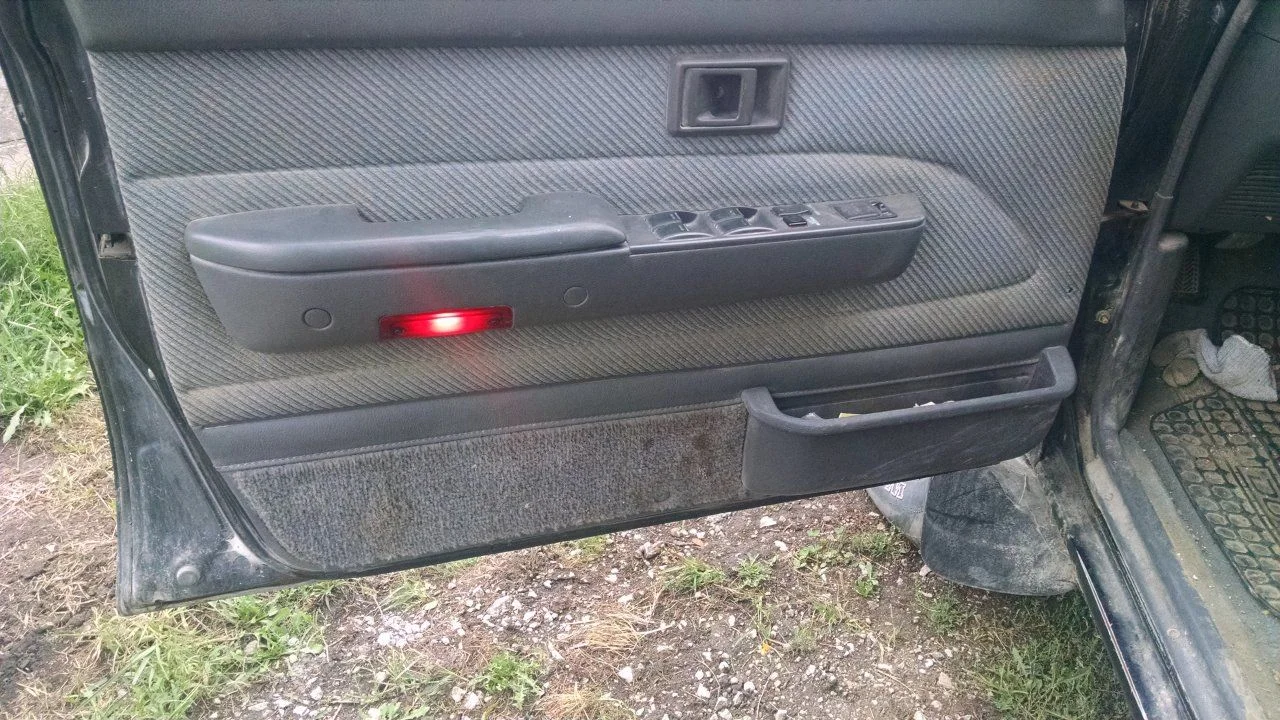

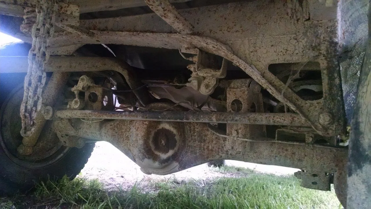

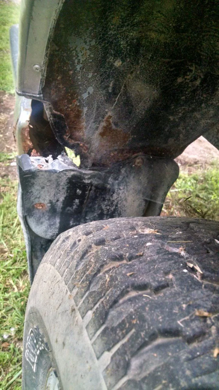

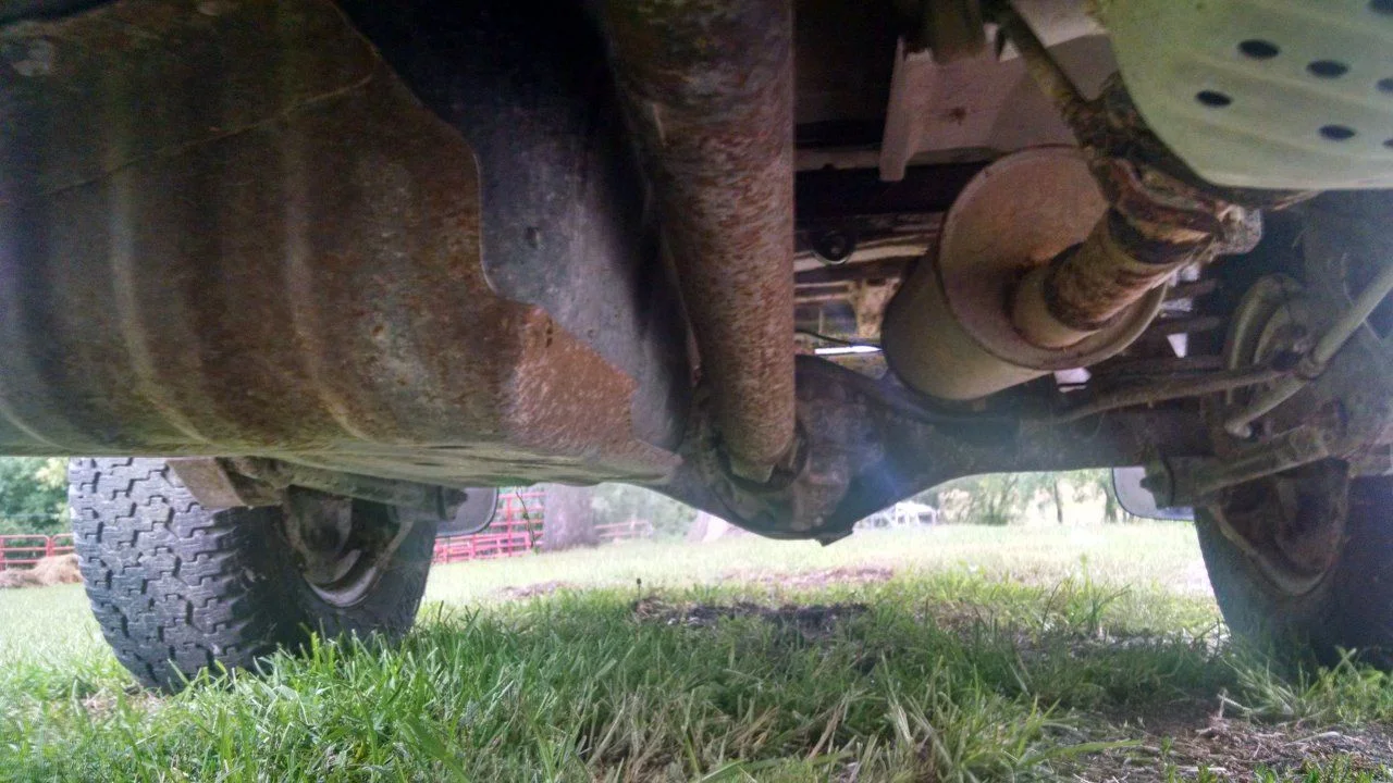

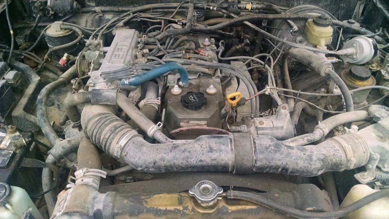

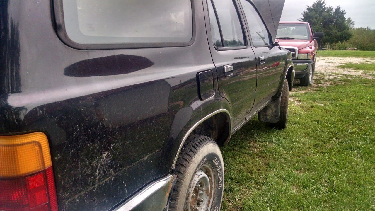

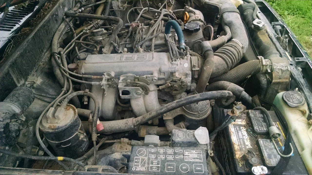

And some pictures. As you can see the interior is pretty bad. The engine does run but has issues as mentioned. I couldn't drive it because a break line ruptured. And yes it was rusty under the belly.
Some more picts
and some more
Last bit of them.
Did you look under valve cover cap for signs of moisture?
Dang it! Didn't look there. It is local to Odessa but the guy is out of town. I'll call and see if I can swing by there.
