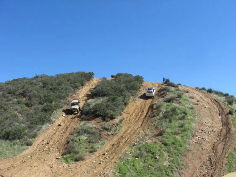

I struggled making it up this hill (right) at 30 PSI, before I lowered the pressure to about 15 PSI - on an all-terrain tire.
Even for expedition runs, I would highly recommend airing down, for the same reasons others have posted: traction, surface area, reduced footprint pressure/increased footprint size and a substantial increase in comfort.
