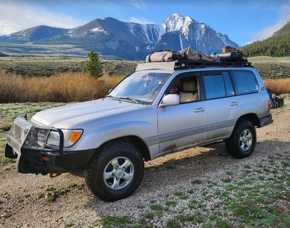

My build is as described above. Toyota OEM up front. Dobinsons coils + shocks in the rear. Weighing 7k lbs with more weight in my rear than front. I'm sitting a bit higher than I'd like in the rear but all and all it's a solid setup. Stock tire size. Front end is maybe 1 inch over stock whereas my rear is probably 2-3 inches over. you really only want like a 1 inch difference I think my coils are just a bit stronger than what they said they are rated for. The more weight I add to the rear the better it rides.
I can't tell in that picture, those may be my coopers but I didn't like them and sold em off quickly.
After testing a variety of tires the KO2 is the best tire for my use case on this particular vehicle, but that doesn't mean it's the best for you.
Those are stock size on 16" rims, I think 275/65-16

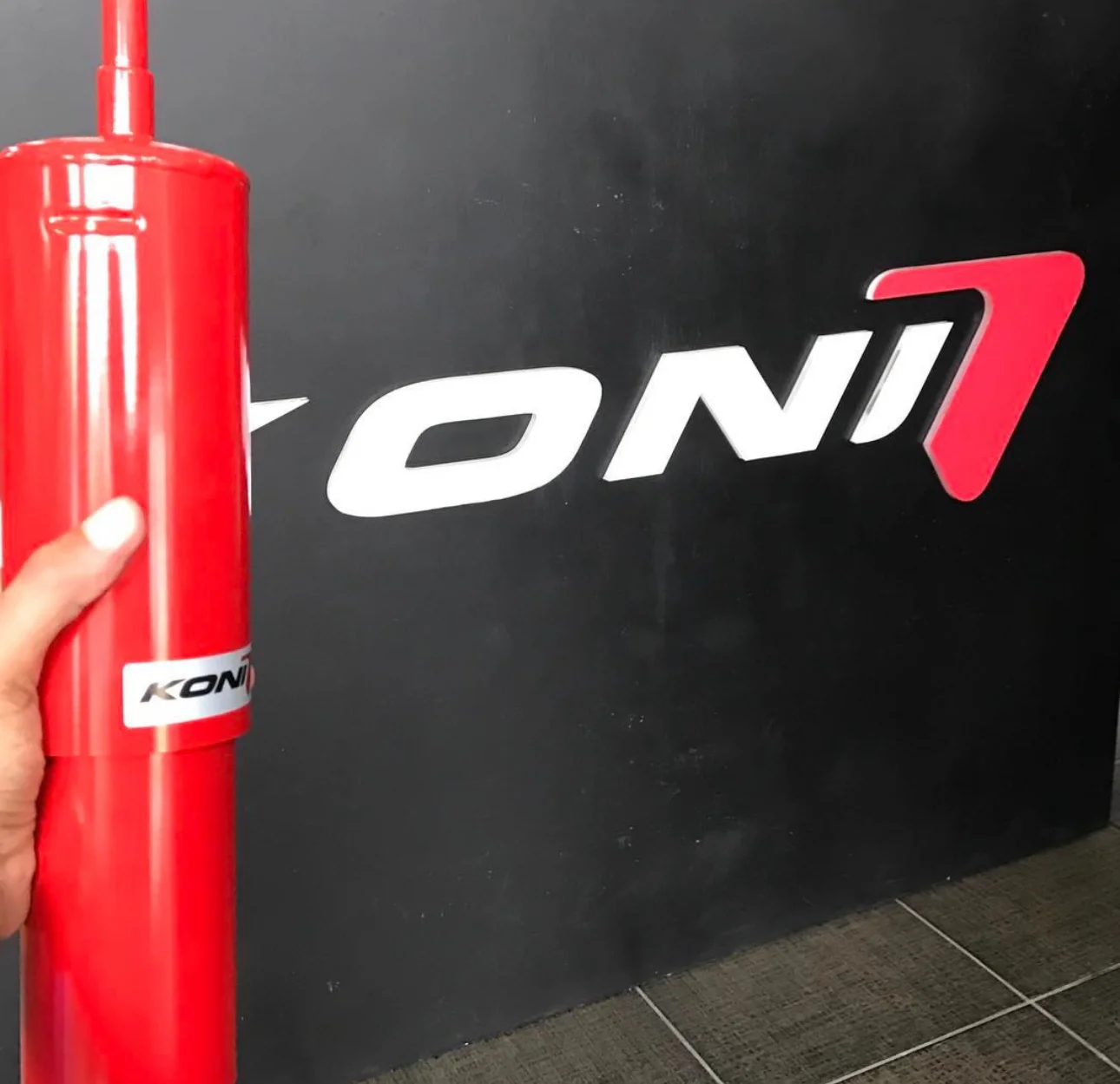

Look up KONi Raid. I have installed this specific model to numerous solid front axle and IFS 4WDs from Hilux, Rangers, LR1-4, Nissan Patrols, LC70s, 80s, LC100 and 200s and they all had excellent review from year one to-date (oldest is 7 years) from my old clients. More than half of them were mixed OME (regular nitrogas and BP51), Ironman and ToughDog suspension users.
Check out the girth of the Raid. Actual photo from several years ago.
Can one get the Koni Raids in the US? I have Tough Dogs - great but they're shot and don’t have a US vendor anymore.
