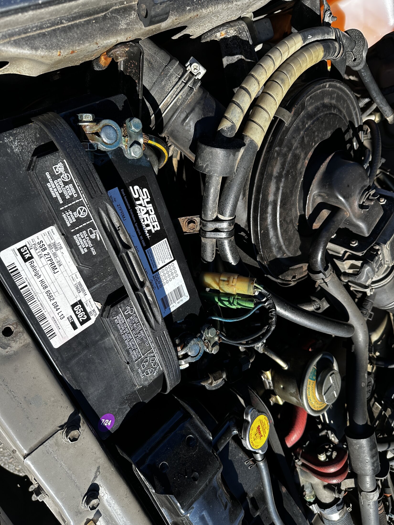

Well, I spoke too soon. More no start no clicks. Any ideas? Seems like the battery connection is intermittent but it charges ok and when I reseat the terminal, it starts right up.
Smack the starter??
That might be worth doing. A few taps and reseating the cables gets it moving. Think it’s the starter going out? It seems to engage out once it has juice.
I would clean the battery terminals as well.
If you look at the wires connected to the terminals….that blu-ish/green corrosion could be part of it. I had a 4Runner with similar symptoms a long time ago and it ended up being the copper wire corrosion at the end of the cables. I took a wire brush and cleaned it as much as possible. Hopefully it is something that simple.
I did just clean off each terminal disconnected to be sure. That blue goop is the terminal protector I sprayed on
For S&G's I'd disassemble the two hold down bolts on the terminal connector and just inspect the backside of the hold down. I've had it look "ok" from that angle but have enough corrosion on the underside to keep it from starting.
When you get home, maybe go at it with some baking soda solution and a wire brush on a drill. Knock that stuff down!
Confirm the baking soda idea before execution though.

Made it back to Raleigh with no further starting issues. I'll disassemble those terminals this week for a deep clean. Thanks all for the help!
You should also pick up a denso starter rebuild kit (contacts and plunger), (plenty of rebuild videos on the youtubes), and a Painless Performance Hot Shot starting relay kit. The relay kit has 4 wires. Red 12v +, black 12v - at the battery. The two purple wires get spliced into the smaller on the starter. Small purple- dash side of ignition feed, larger purple as close to the starter as possible. When you hit the ignition switch, the relay supplies up to 40 amps to engage the starter.
That sounds like a worth while upgrade. Thanks for recommending it.
I've done it to every toyota I've owned in the last 25 years. Well worth the time and effort.
