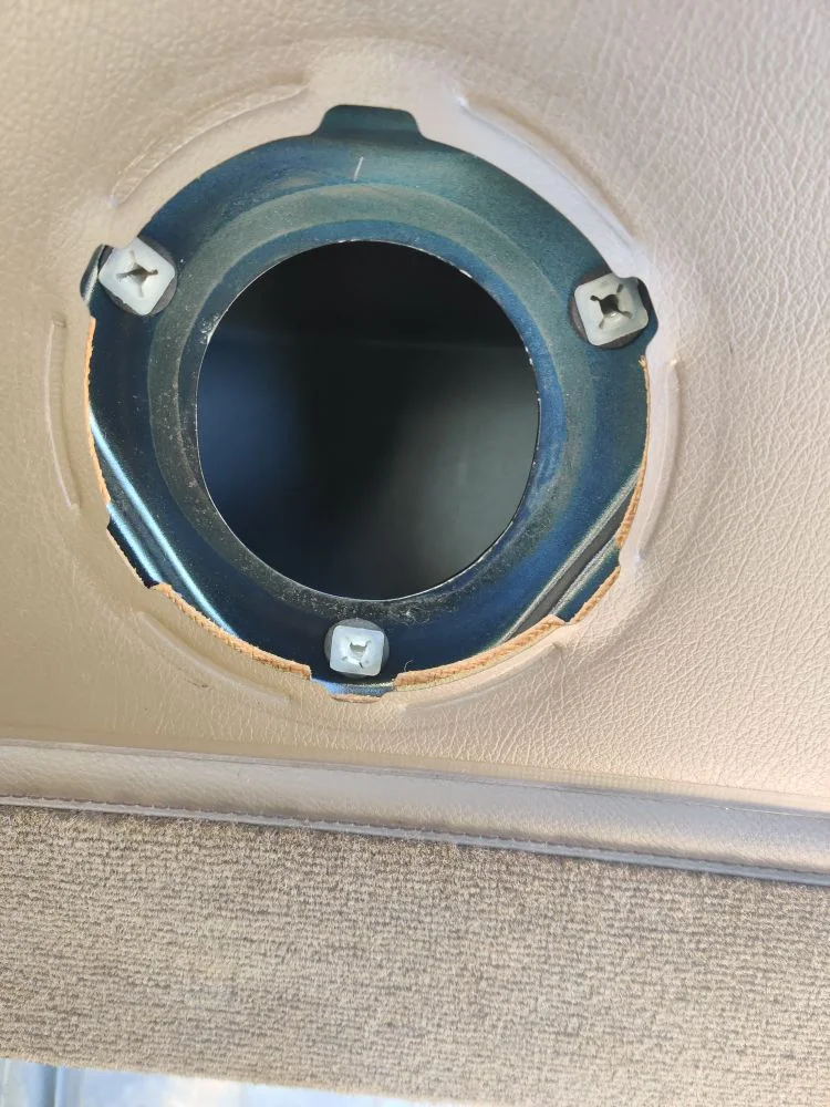

Yes, the woofer goes in the front door and acts as the normal speaker for mid/low range. In the systems with 2 woofers they can go anywhere you can fit them. I've seen set ups with both in the door, just have to be willing to cut the holes.
trying not to cut. I've problem keeping brittle plastic together already lol

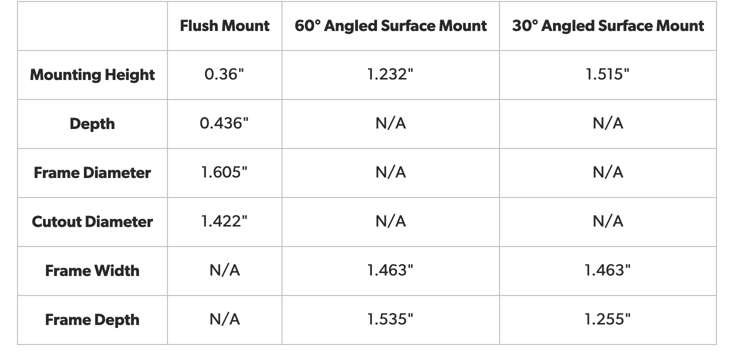

Tweeter has following description:
How do I judge what size do I order from SolveFunction?

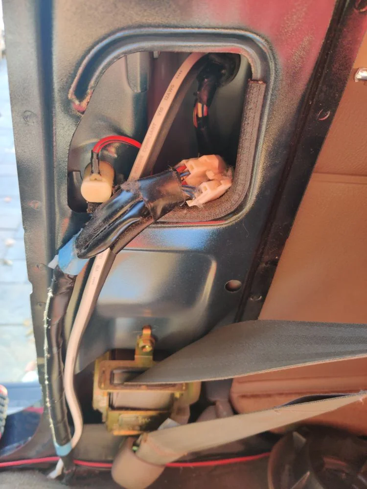

Running speaker wires from center console is relatively easy. Getting wires through door / body gromet is hardest part (especially front doors)

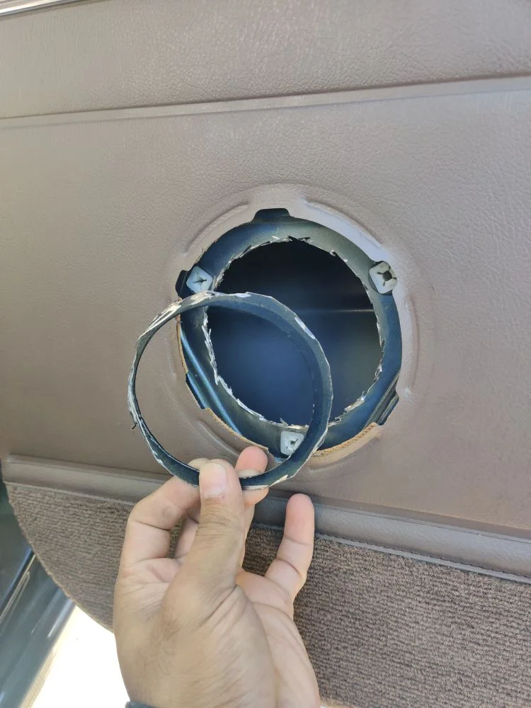

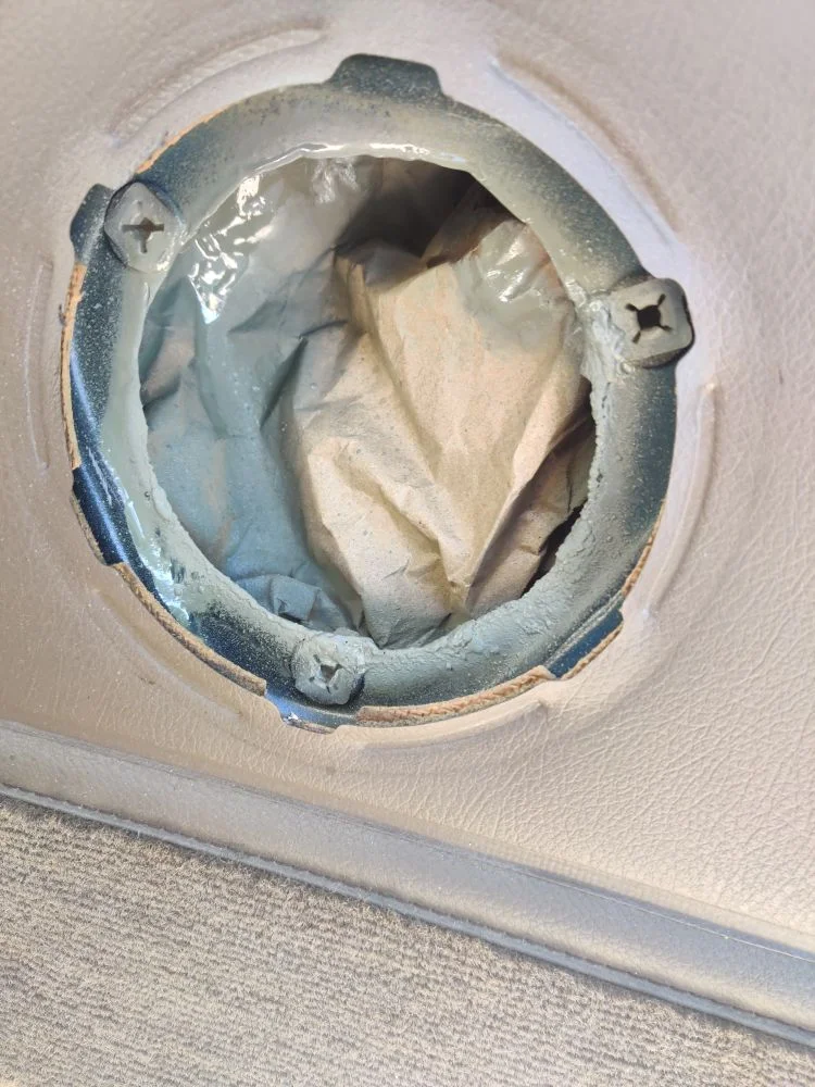

After running wires you will need to think of door hole size (Dremel cut and fine works + anti rust spray)
Yet to make new screw holes etc.

It's easy to get wires from center console to edge of car without lifting carpet. Use fish hook wire (in my case, I used old laundry basket wire) to get under carpet and pull speaker wires from center to rear door frame and then from there to each door.
Getting wire through door frame in to the door was hardest part of whole process, if there is suggestion to get this done easily please reply (for now I'm done)

Rear: Polk Audio MM 522 - https://www.crutchfield.com/p_107MM522/Polk-Audio-MM-522.html , requires making holes bigger - dremel can be used for this, i didn't find drop in replacement. nuserts can be used for new holes for speakers to be mount.
Front: Hertz K 170 - https://www.crutchfield.com/p_301K170/Hertz-K-170.html with FJ80 Tweeter mount Landcruiser (Tweeter Mount: Focal TKMX) - https://solvefunction.com/shop/ols/products/tweeter-mount/v/TWT-MNT-FCL-TKM Speakers are mount just with self driving screws. Tweeters cables needed to be cut and re-soldered.
