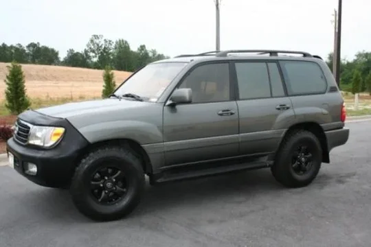

I say sell the old tires on ebay and upgrade to 295/75-16's Terra Grapplers. I just did this to my stock '99 TLC and they look great and handle great. They are also pretty affordable.
Do you have any pics?

Here you go Subspd!
Sorry they are a day late but the rain prevented me from putting them up sooner.
