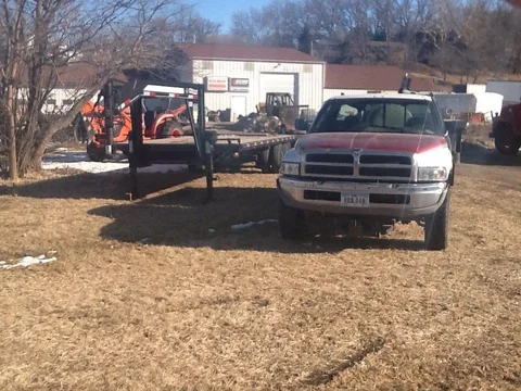

Im on the fence about buying a Gooseneck trailer.
New ones in California are insanely overpriced. Used ones in California are the same price as the new ones out of state.
I found this Titan that is a bit overkill for hauling any of my rigs but it is priced right. It is only 2,000 miles away.
What say the trailer guru's?
I asked the owner to park his Kubota and his dodge next to it for size reference.
Has a 24' deck
The 5' rear dove tail moves up so it is level with 24' deck.
The ramps flip up and are level w the deck as well.
Has 38" deck height
Looks like a nice trailer. Ask for pics of the frame to neck corners/welds. Dual tandems that are used to haul backhoes, skidsteers etc.. get twisted and the structural tie points are the first inspection point.

I've been thinking about a deck over, to haul my big tractor. I don't need the dual wheel axles, though. That four extra tires and bigger brakes adds up when replacing. Do you need that heavy of a trailer? It is a great looking trailer, always liked the pop up ramp.
I do not need a trailer that heavy duty. I don't own anything that would overload it.
He sold his Case Dozer so he no longer needs the trailer.
The owner has the receipt of when he bought it new in 2007 for $12,800
It has new tires on it and just serviced.
But for $6,500 can I really pass it up?
What is the heaviest load you'll haul? Typically just a wheeling rig? 2 rigs with a trailer long enough? A tractor? What are you pulling with? Does higher capacity come with more red tape in California (annual trailer inspection? Upgraded drivers license?) that looks like a nice trailer if you need the capacity, but if you are only intending to haul a single rig I think it would be overkill for length and weight, and the deckover is going to lead to more wind drag.
I ended up with a 20' (18' + 2' beavertail) deck between with 5200# axles. <$4000 lightly used. I really like it for my uses.
