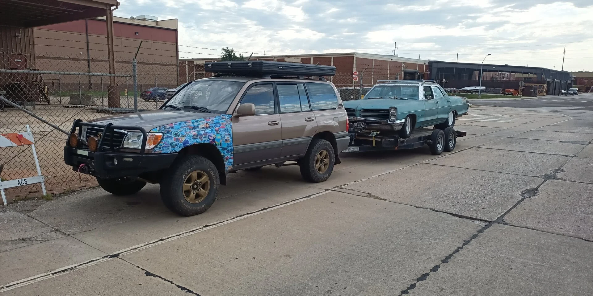

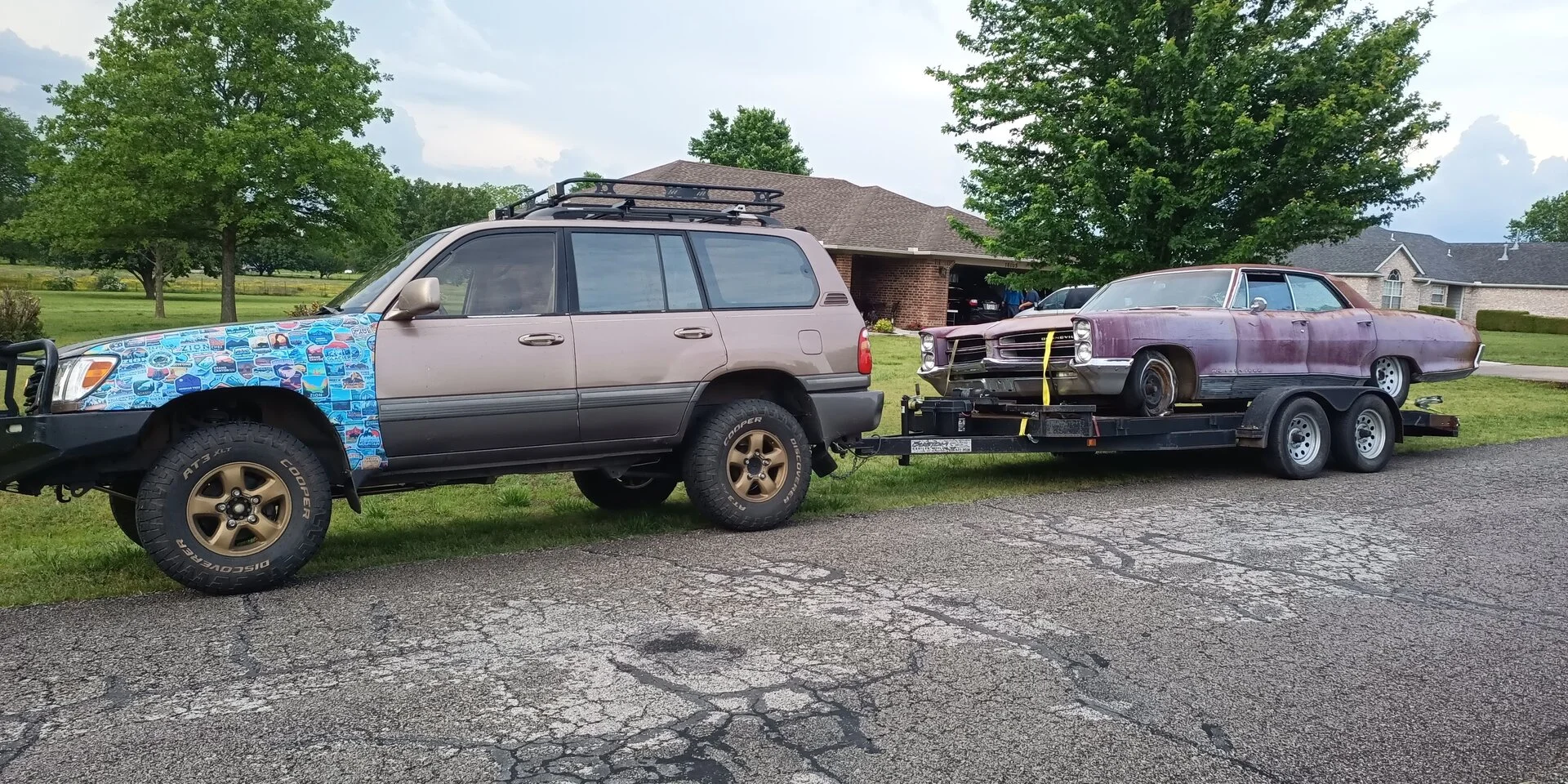

I have 1800lbs car hauler and pull my 2 4400lbs 66 pontiac around with it when I need to.
Yes it tows fine.
I have about 3"lift ... OME T-bars, 864x 400 kg rear springs, 60002 rear shocks. 33" E-load range tires. It tows pretty darn good despite what a lot of people will say. My Land cruiser is a 1999 so admittedly it's a little down on power but as long as you are aware of this it does just fine.
I noticed my sway bar end links we're loose and would chatter. So I went ahead and removed my rear sway bar and my front sway bar for the very first time. There is a little bit more noticeable body roll. As long as I'm not trying to treat the 6970lbs beast like a Miata or a Corvette I feel like it's actually improved the ride quality this could be because my sway bar end links had 200,000 miles on them and after the lift were pulling the rear sway bar up at a non-optimal position.
I haven't tested it yet but I am curious if anybody on here tows occasionally with their Land cruiser and does not have sway bars installed.
