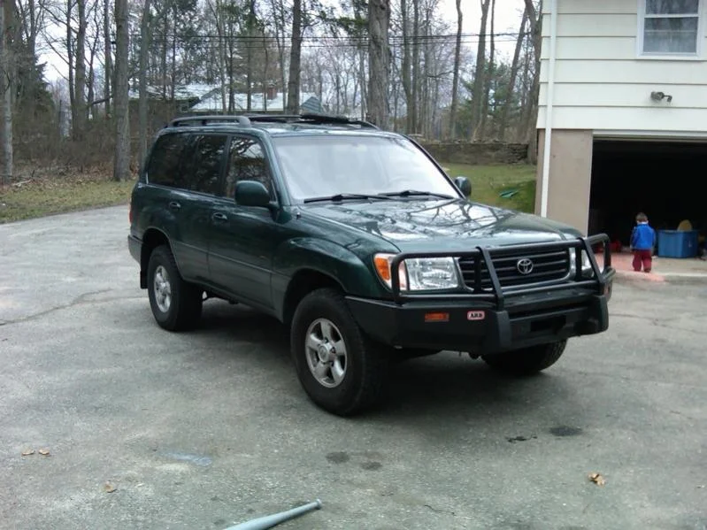

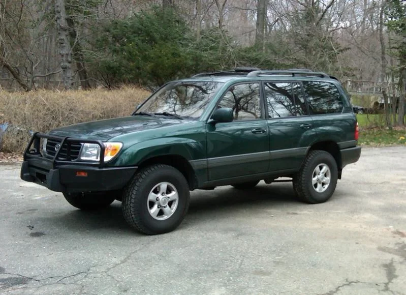

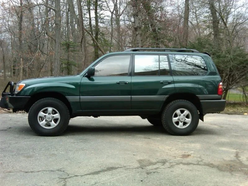

Ok, so i put my 2" rear springs in today and went to crank up my OME T-bars to level it out. Pictures below.
My question/problem is on the DS i ran out of threads for adjustment and it seems like it needs to be pushed up a tad bit more. The PS still has a little over 1/2 of threads left. Am i missing something? Did the DS Tbar get put in wrong?

No, not reallly. One could have settled more than the other, it could be a spline or two off, or someone could have had them out (one of them) for a repair.
I think you just need to re-index the bar that's coming up short.
X'2! Do this by lifting the front end so the tires are off the ground. Release ALL tension on the bars and the threads are down even with the adjuster cam. Unbolt the torsion bar anchor plate from the lower control arm and slide it back over the torsion bar.
Now twist the bar so the rear end is tight against the adjuster arm, and then slide the anchor plate forward back onto the lower control arm.
You might have to clean the splines to get it to slide easily and apply some white grease to the splines.
Should take around an hour in your driveway or garage.
Have fun!
