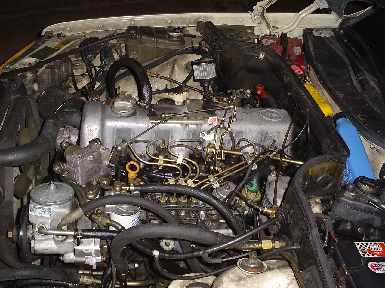

This is from an old, defunct, never finished thread here. I didn't read the whole thing - to see if he attempted to cut the firewall, etc. But you can see the lack of longitudinal room. I'm still looking for the thread where the guy had the radiator in the bed.
OM617 1st Gen
YouTube vid linked in an old YotaTech thread. I can't see the pics in the YT thread - maybe the Photobucket thing. In any event the guy in the vid did the same thing - cut the grill support and pushed the rad forward. Just not much room..
