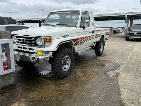

TRUCK DELIVERY
Flew Boise to Jackson Sat 5/9 to collect the truck. Collected from airport parking.
TRUCK DELIVERY
Safe travels and looking forward to hearing about this adventure back to Boise.
Flew Sat 5/9 from Boise to Jackson.
4am departed house via Uber
2pm found the Old Man 79 per @wngrog directions - all in good order - many white trucks, but hard to miss
Inspection results more than satisfactory
Exit to highway and off to Monroe, LA. Several gas/food stops which produced significant local interest. One fella (looked like he had means).
Him: "What would something like that cost?"
Me: "In this condition, between $50k and $60K, landed in US, local title."
Him: "I want one."
Me: "No but I know a guy."
Younger fella in a 2nd gen Tacoma trails off my left rear on the freeway for a bit. Figured he was a fan and sure enough, he pulled up slowly while filming with his phone. Dropped it on seat, waved and gave a thumbs up. I waved back and had a great view of a very wide smile on his face. He drove off, no doubt to tell his wife he needs a new truck.
