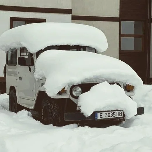

hi all! i recently got my hands on my third 40 and she's a wobbly old girl. i live in bulgaria where i think that between myself and two, maybe three others, we own all the 40's in the country. i'd like to sort out the suspension in a way that is the best job i can do and that improves the handling by as much as is feasible. i think i have settled on choosing one of these kits: https://www.offroadattitude.fr/s-10...sse+suspension&orderby=position&orderway=desc mostly because these are what i can find in europe and ome seems to have a great reputation in general. there's not much i can do about recommendations for other brands that i can't get here. do any of you know how i should think about the differences between the various ome skus (OMESK0606, OMESK0607, OMESK0608, OMESK0609, OMESK0610, OMESK0611, OMESK0612, OMESK0613)? do i just pick one at random or is there something i should take into account? the only difference i see in these skus is weight ratings of either 50 or 150 kg. since i want to put a roof nest on the roof, i was leaning towards the heavier ratings.
