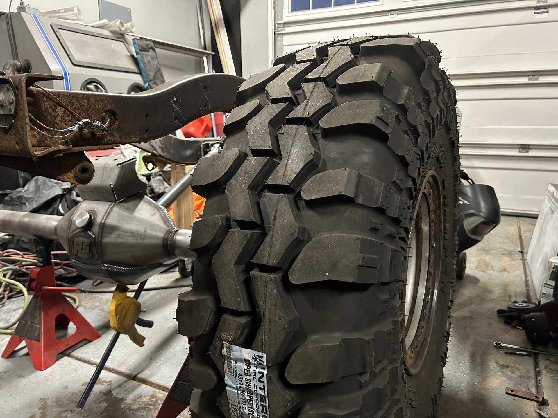

Pulled the old axles out tonite :oops: I was a little worried that the frame would be to heavy for me to lift but its not to bad . Now i can flip it over . I am also welding up all the useless holes

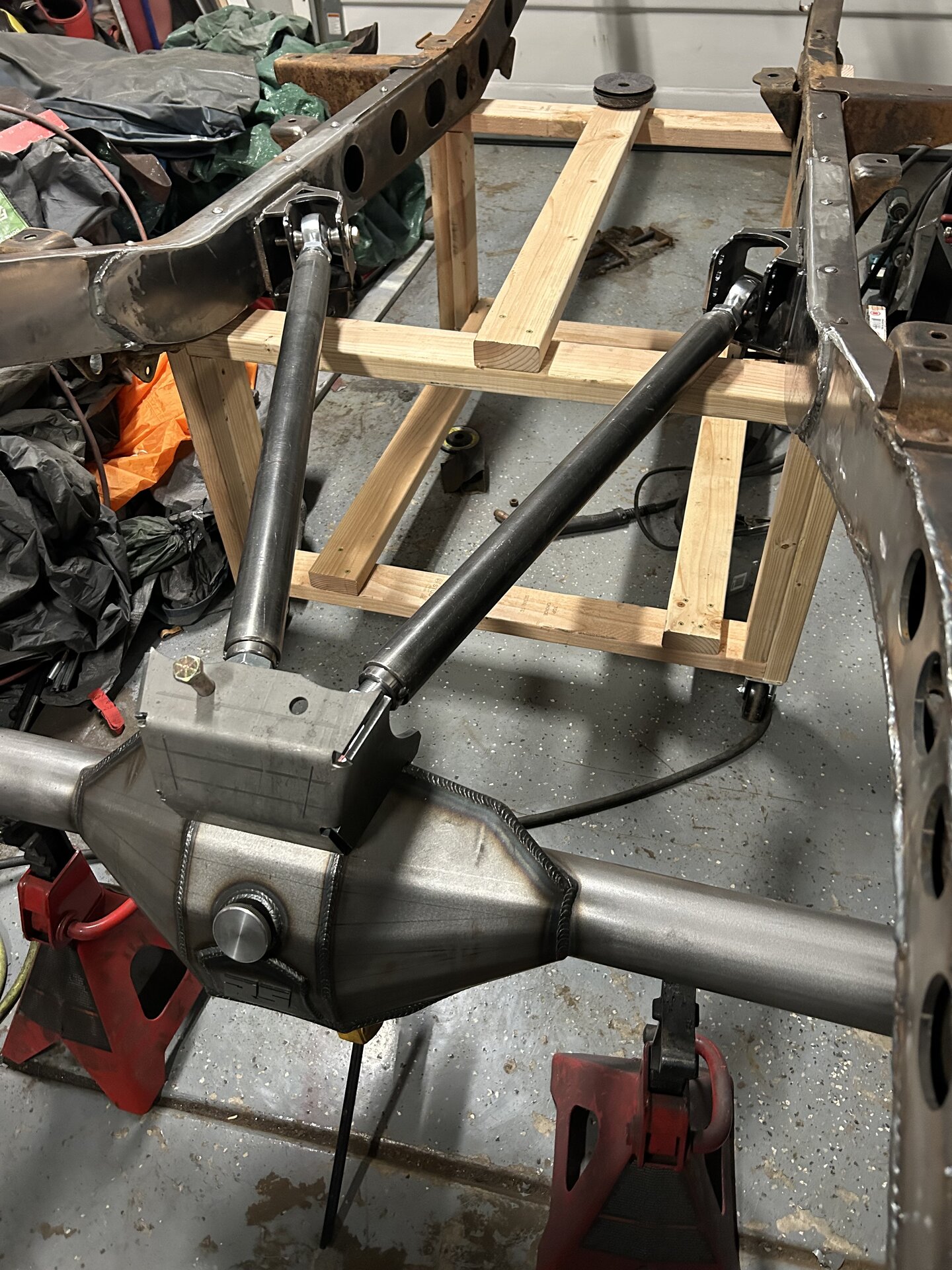

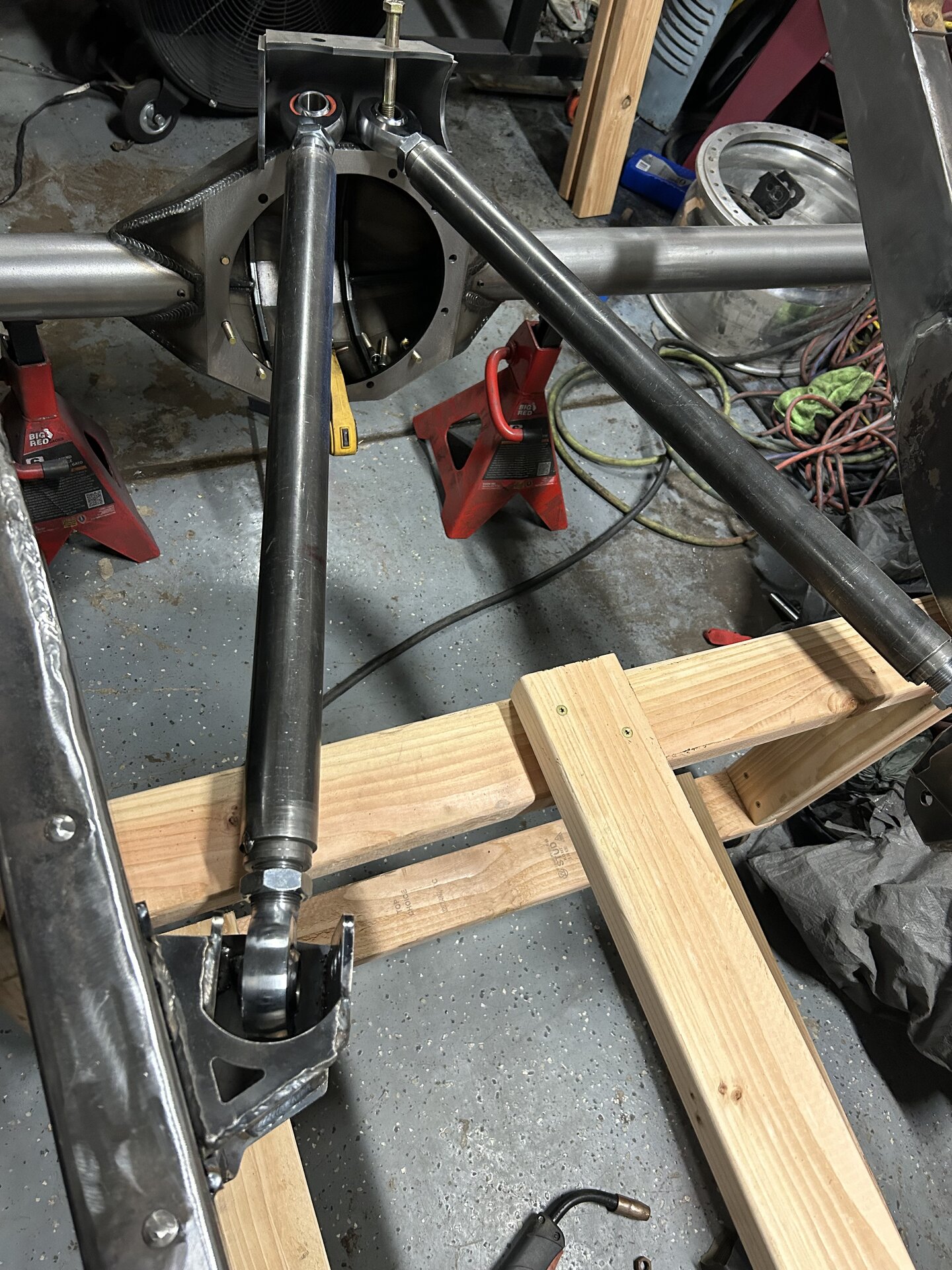

Well tonite my goal was to get the axles off and out of the way 🙏. I needed to make something that I could put the frame on and be able to move it around . The hardest part was getting the rear axle out because 1 rear wheel was locked up 🤬. So I had to just drag it. Ugg But it’s gone ( well it’s in my driveway for now ) With that crap out of the way I can really get to work on the frame now and get all the old brackets removed and holes welded up . Just to get an idea I threw the new rear axle under 😃. I swear I spend more time getting rid of old 40 junk than I do anything else .

I love those wheels. What are they, 2”? It’s looking good!
4" 2 swivel and 2 are stationary . got them at harbor Freight . I made the stand so the frame is pretty close to ride height . 25 " to the bottom of the frame . I have 40s on the black 40 and the frame is at 23 . i figured with 43s 25 would be a good starting point .
That’s way better than jack stands, and 43s will look amazing on that. My ride height is still settling as I add more stuff. I’ll hopefully be between 23-25” with 40” tires when it’s done. It’s sitting at 20” on 31s at the moment.

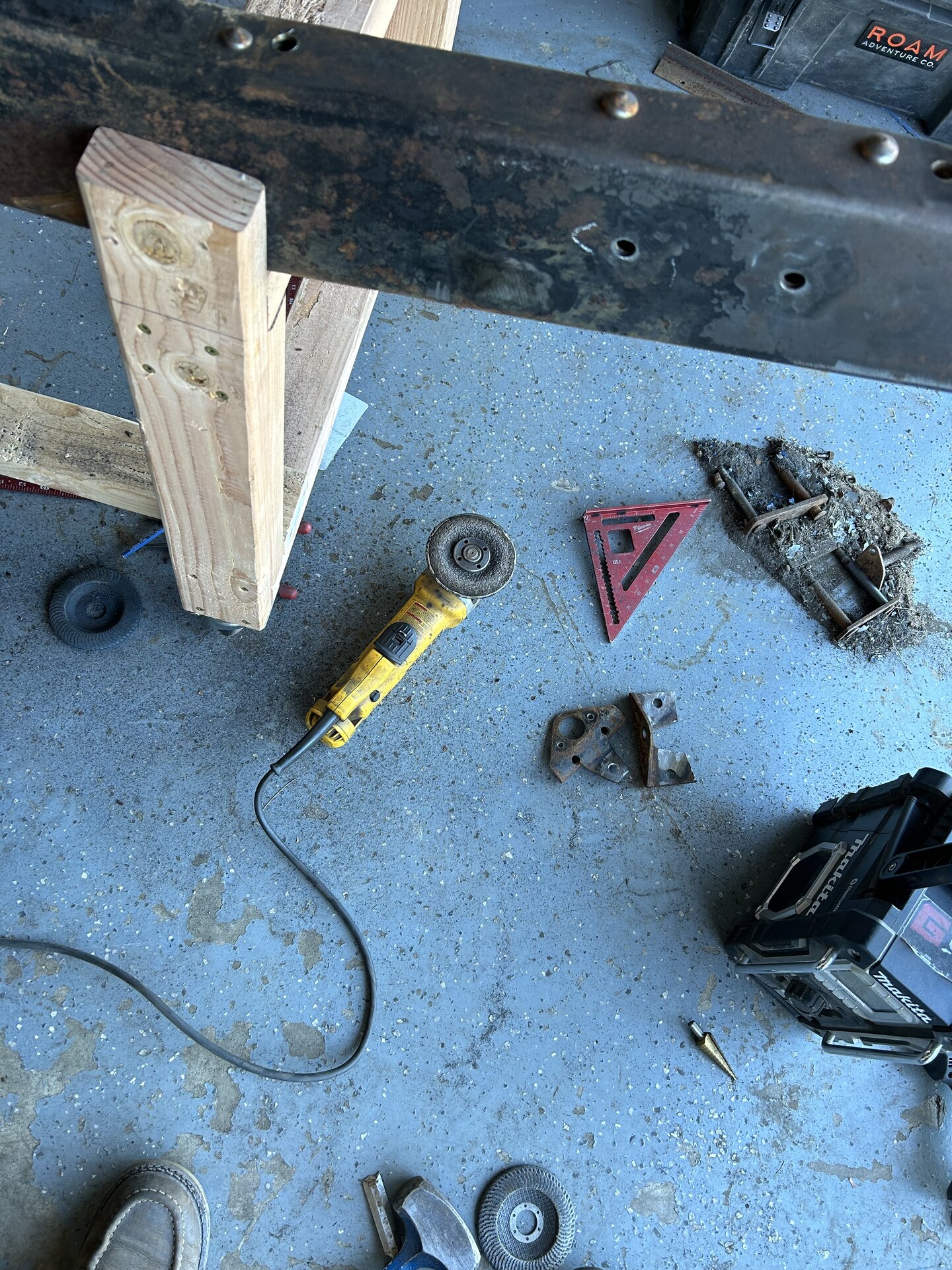

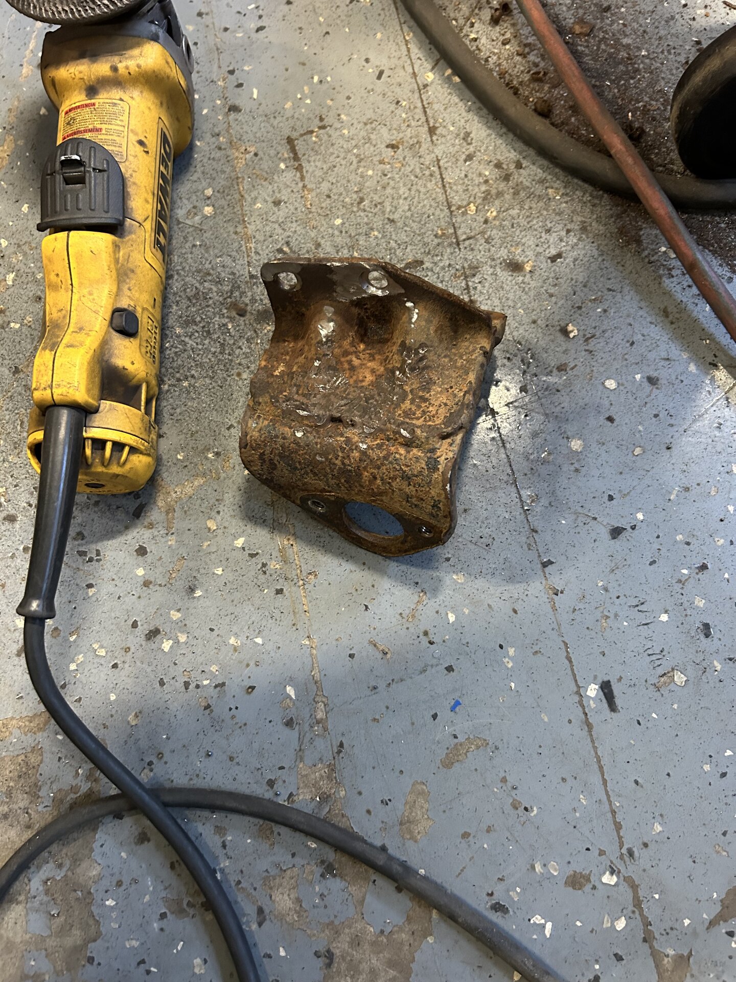

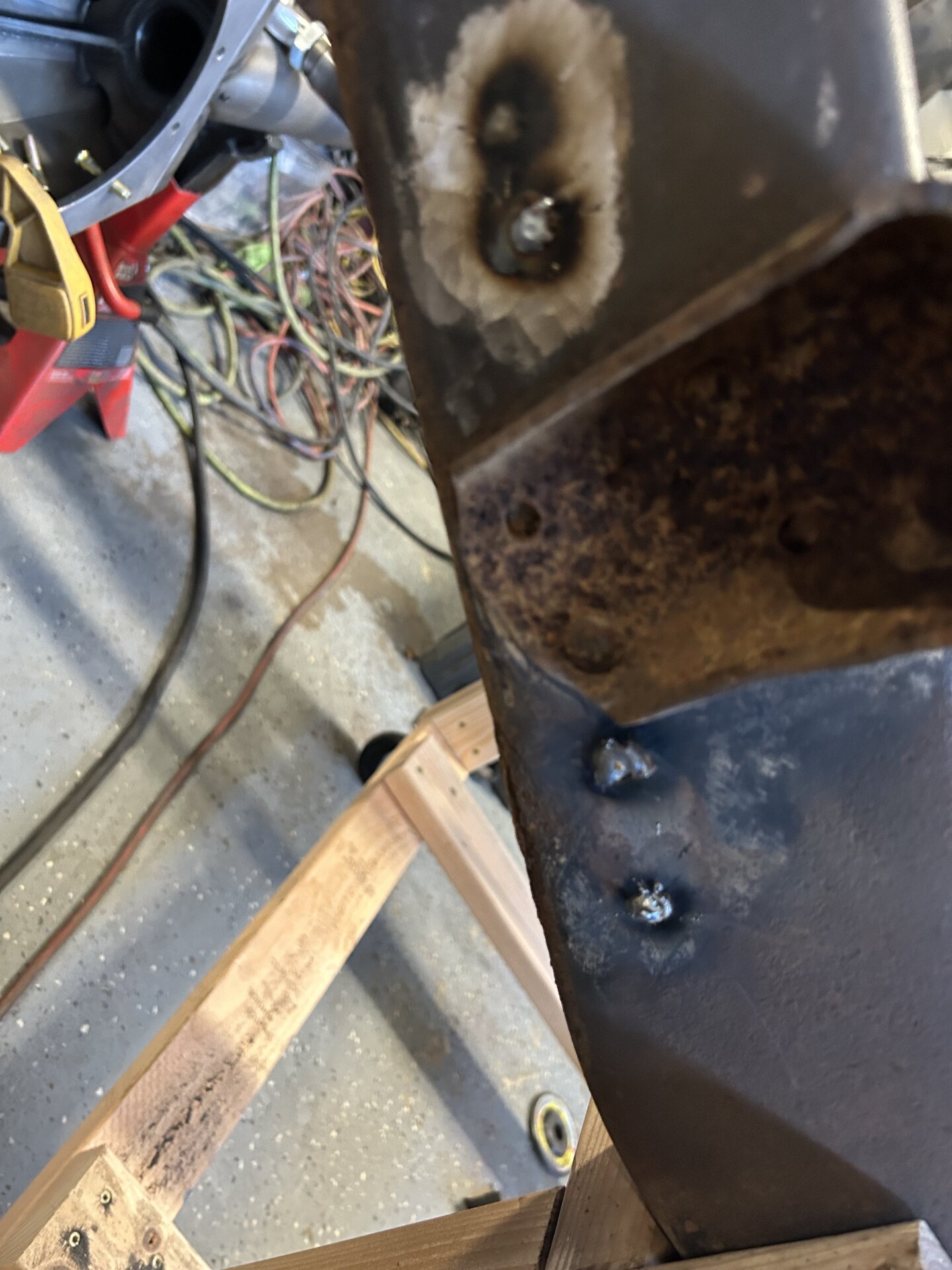

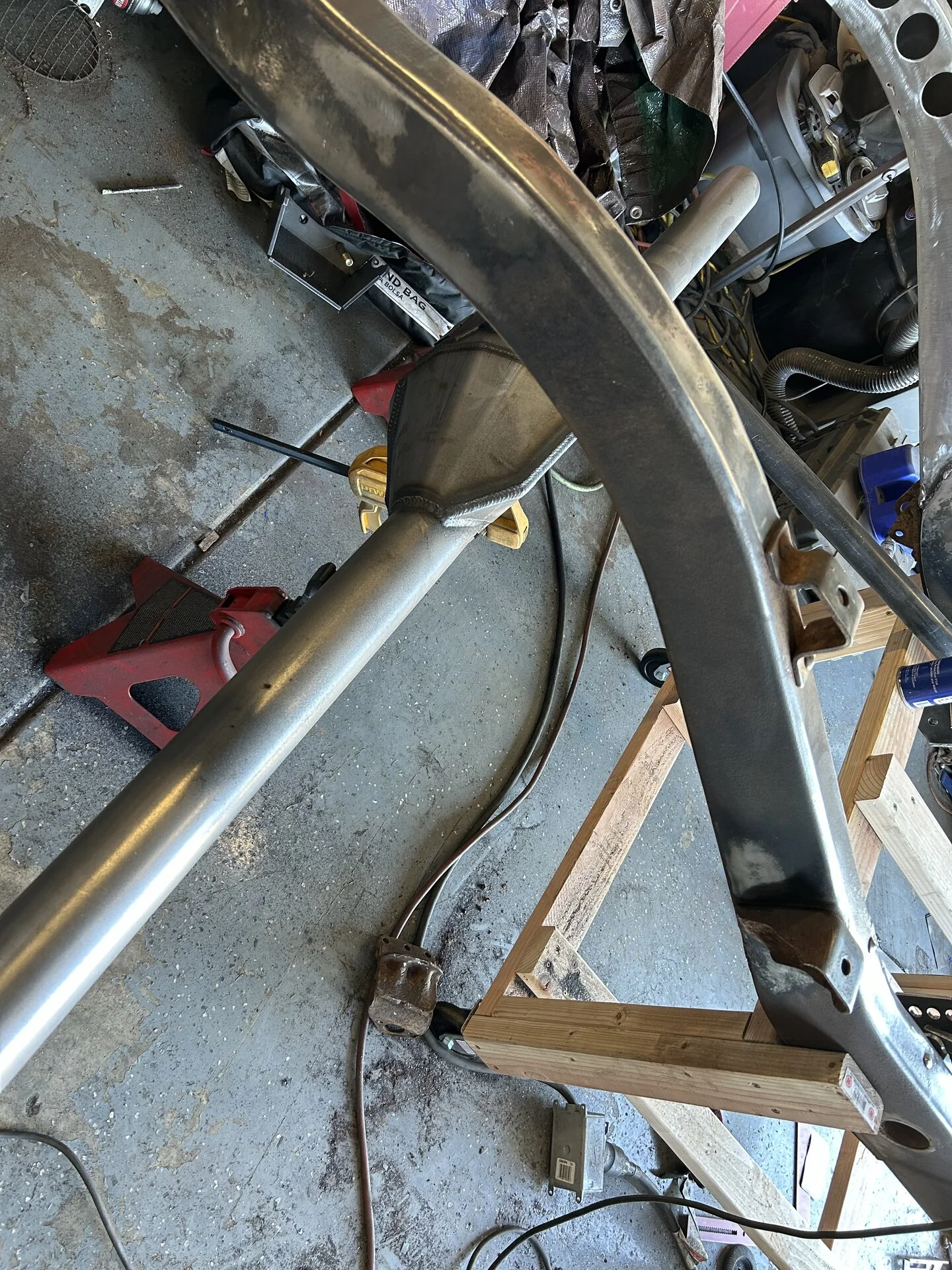

Spent a few hours on the frame today. Got 1 side done 😃. Brackets are off. Holes welded up 😎.
Looking good, man that grinding dust is awful stuff tho 🤮
Agree

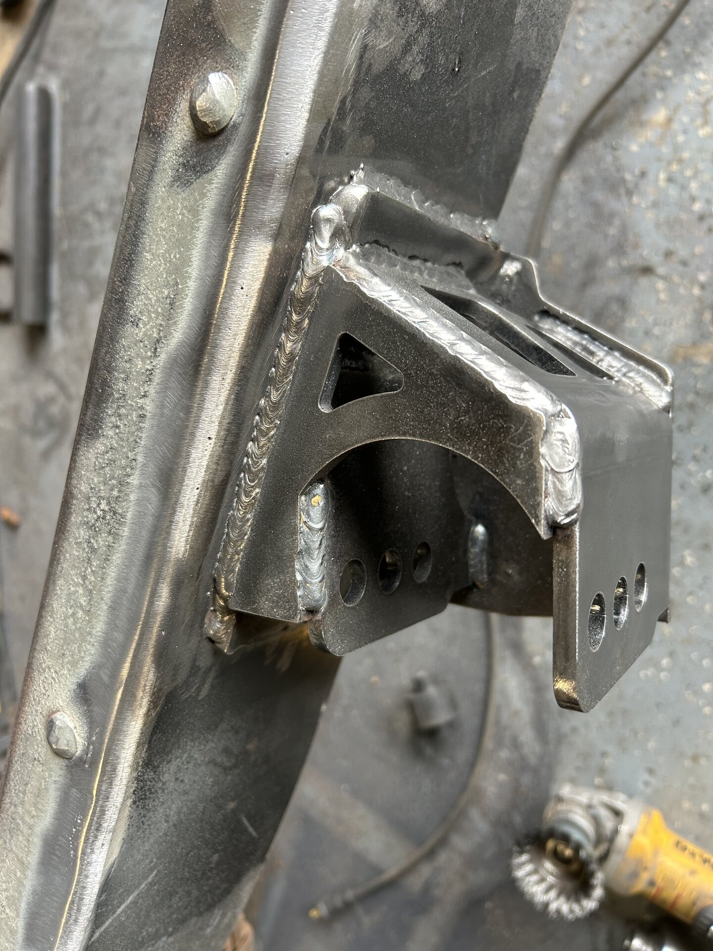

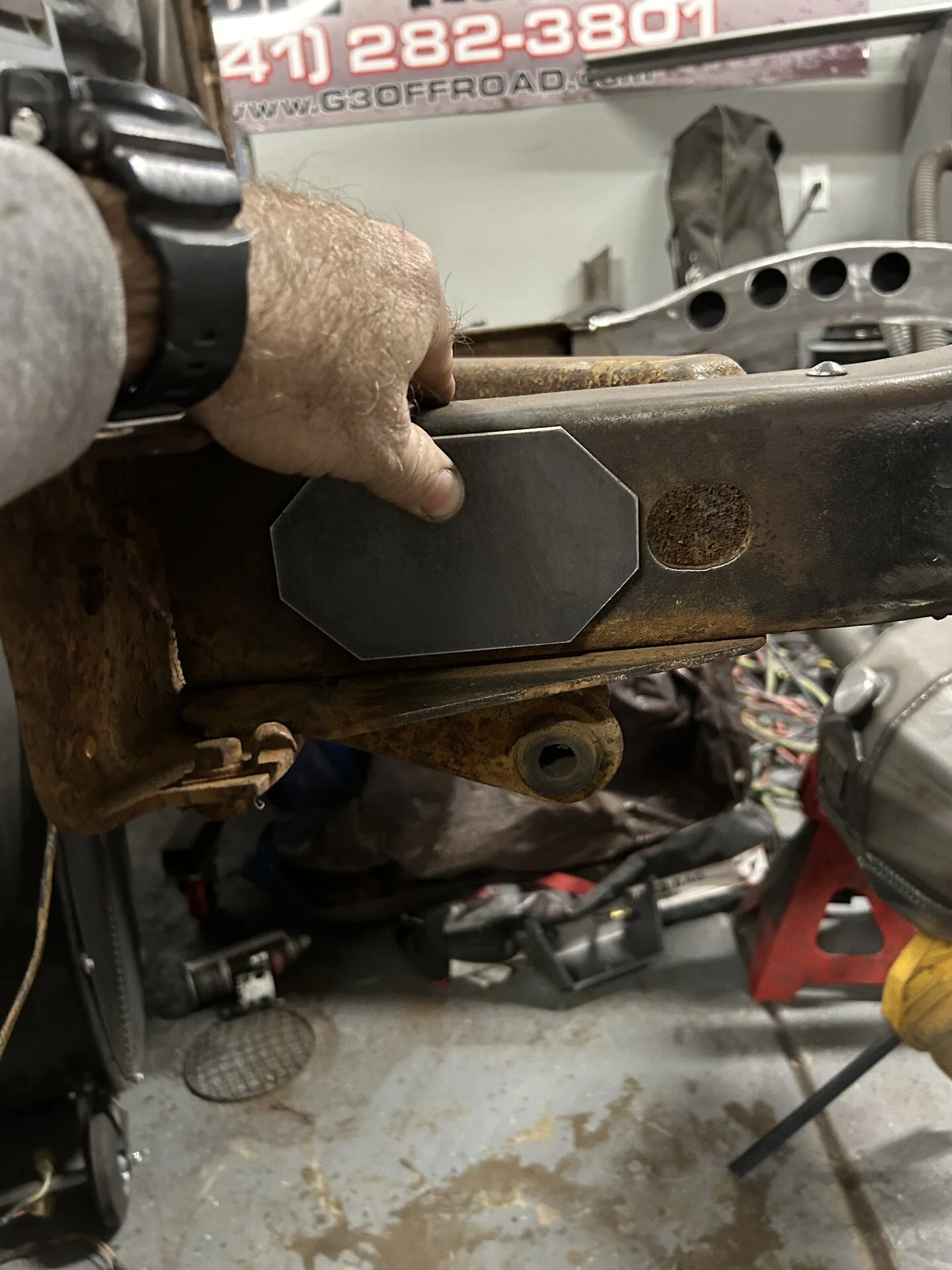

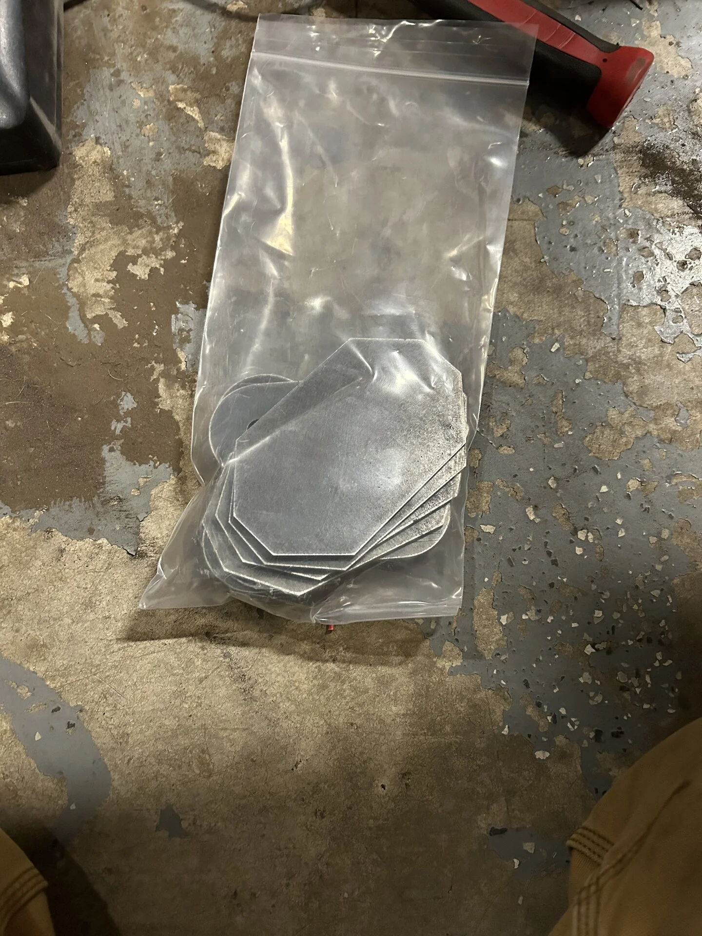

When I made my cage tie into my frame I made extra plates in anticipation of old blue
Nice plate tie ins 👍
Any reason you didn’t blast the frame before doing all the fab work? It would weld SO much better if it was clean, up here there’s a place that would charge about $200 for it

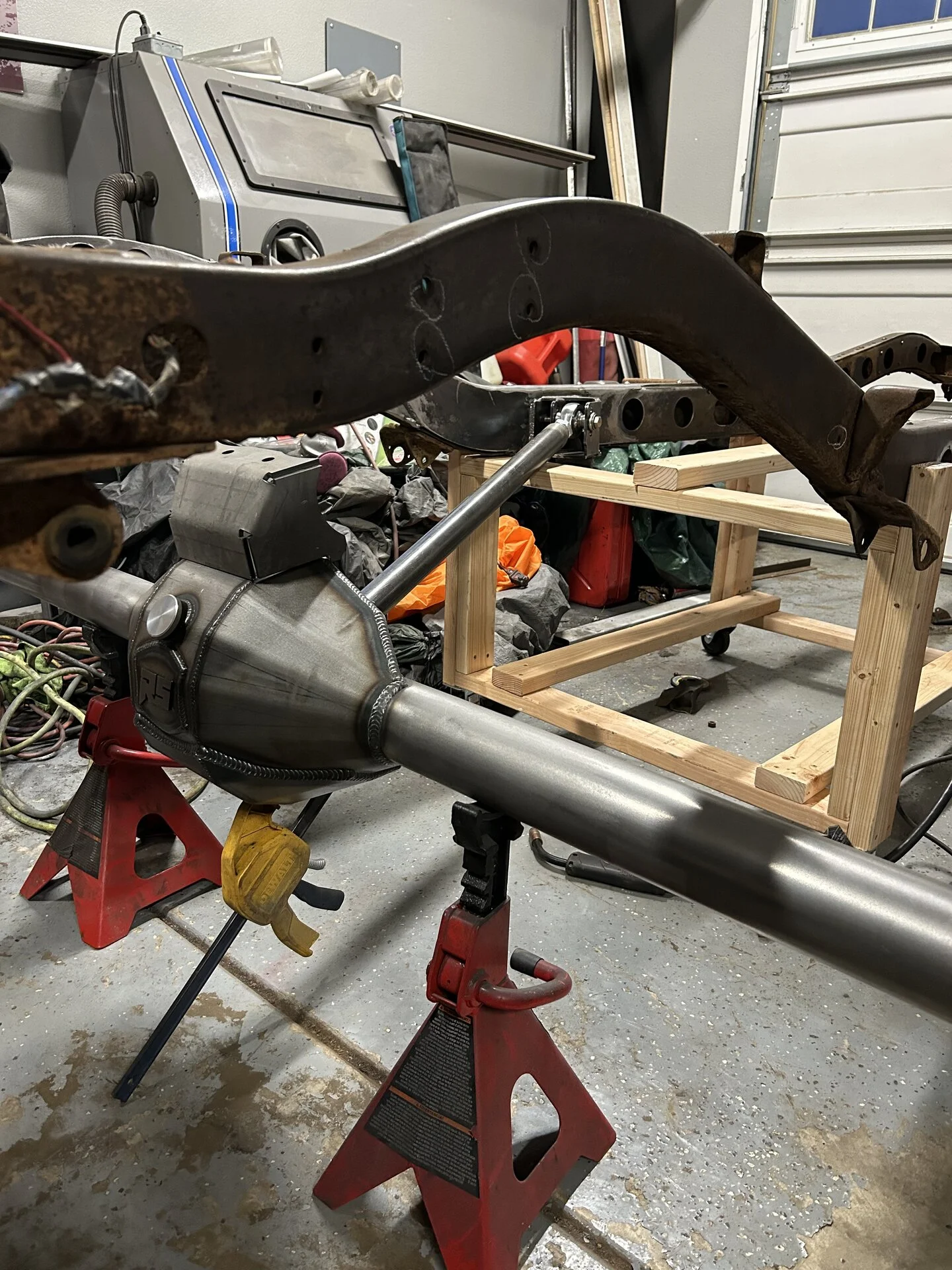

Everywhere i weld i wire wheel and sand clean first . I was going to blast it first but then i figured just do it after i have the fab work done The frame looked bad but really that is just dirt . when its done it will look better than new . But i agree would have been cleaner to start for sure . I have access to a dustless blaster down at NIC ( cerakote ) but will probably just take it to who i have powder coat for me . Up until just what 3 days ago this has been sitting in my driveway so it would have been all rusted if i got it blasted . Now i have it in the garage so i can get it done .
Cool, if there was ANY chance it would have gotten wet after blasting I would have held off also.

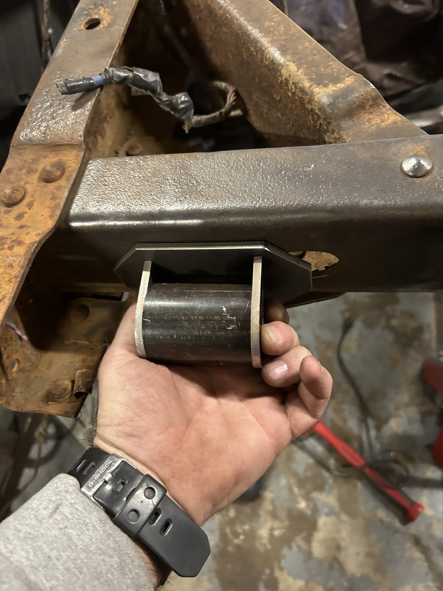

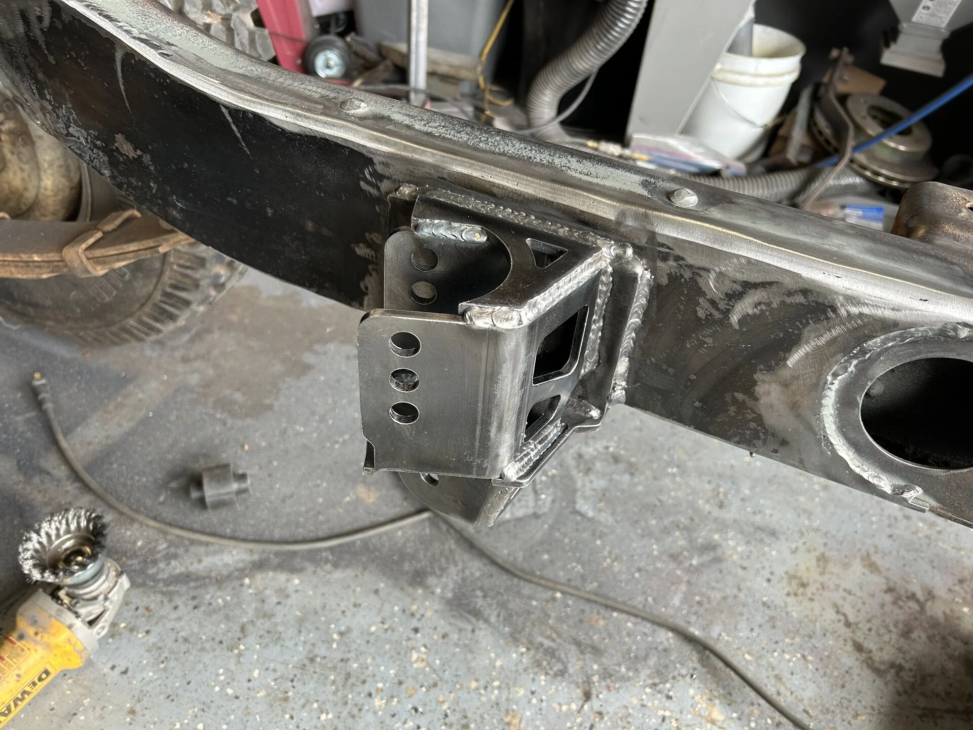

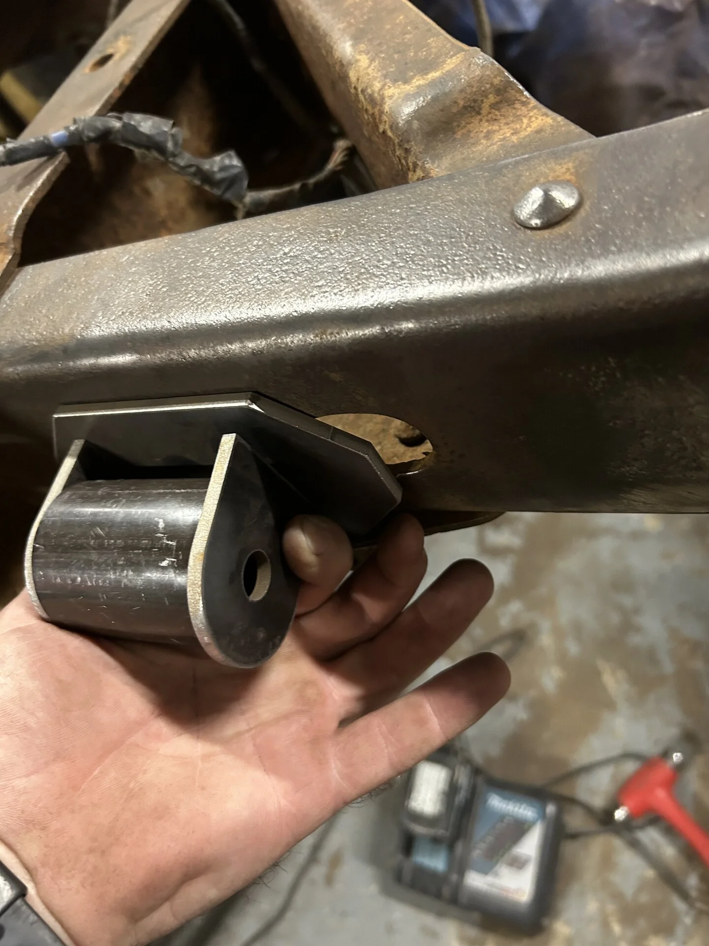

Slow and steady I only have 1 more bracket to remove ( rear drivers side leaf hanger ) all the other are off and all holes have been welded and ground . I have been dragging my feet on cutting the stock trans mounts off . But since the 2f is not going in i guess i should just do it . The Upper link mount needs to go there anyways so they have to go
