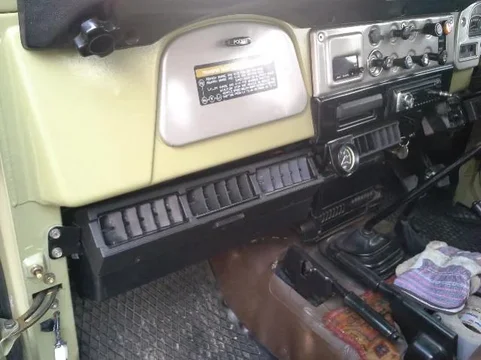

I could not get that link open, but here's a pic. Bear in mind flatland, Florida is a bit like Darwin but to be just like Darwin, wait until mid summer, then close all the windows in your house, cook a turkey in the oven with a humidifier in each room and start a roaring fire in your fireplace. Summer on Darwin is called the silly season for good reason; it's over 100 most of the time and nearly 100 percent humidity. I've never felt heat like they have-not even July in New Orleans, Orlando or Atlanta can compare.
Here is how it looks at current.
Need to finish the dash and install 2 more vents in center and make new gauge cluster.
Get there eventually.

You guys crack me up. I concede Darwin is worse than Florida. Short, I'm curious as to the plumbing you have. Cold stuff comes from the compressor to the center console. Makes humans less cranky. I think I get that. How does cold stuff get to the fan under the dash to push air out of the circular dash vents?
The Unit I have is the Hurricane IP-1100.
The fittings exit on the top side through the firewall.
My shorty is 1978 and had a grommet for the wiring harness on the firewall exactly were these pipes go.
Matched the existing hole with a hole saw and then attached that to my new hole saw ( larger) as a pilot bit. Sparky trick when you drill the wrong size.
My unit has the electronic heater and vent controls via the billet dial you can see in the dash on a previous pic.the 4 pipes come out directly next to the rib on the firewall and behind the accelerator cable, but do not interfere at all.
If you use the 3100 I think which has the fittings from the bottom and mount it similar using the existing grommet location you have to cut out the glove box to raise the motor assembly up under the dash. As my luck strikes again Aus had no 3100 available and were on back order at the time.
If I was to do it again I would build a cradle for it to secure a little better and use the 3100 so it is not so much in view.
hope that makes sense ..
I also installed the firewall Insulation barrier after I noticed the unit would condensate big time while idle at the lights as the engine bay temp are at there worse when you sit still. This made a huge improvement with the condesating.
