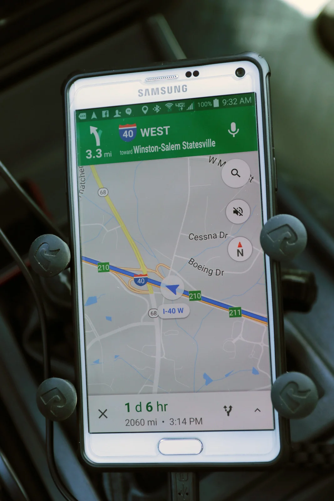

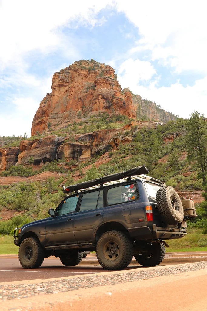

We did 4700 miles from NC to AZ and back in 2017 on the original headgasket. The only "issue" was stock gears and 35's didn't play well on the super long climbs at 7K feet. At one point, I just wanted to give the Cruiser a rest and pulled over. The exhaust manifold was glowing cherry red. During this same trip I got 15.17mpg.
My advice, Send it and enjoy the scenery.
