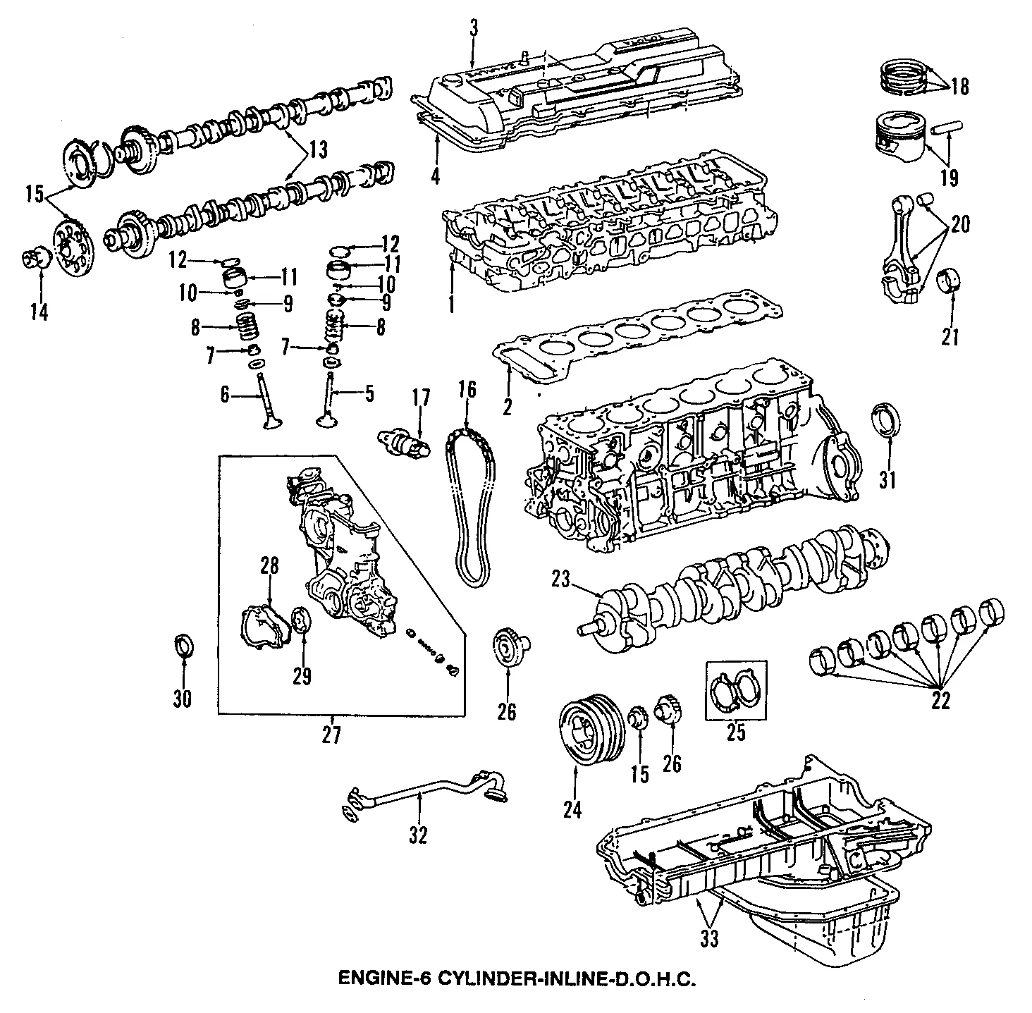

Hello mudders. A buddy and I are working on the rear arch seal (among many other things) on an 97 Land Cruiser I bought recently. I’m having a hard time identifying the proper name (and how to search for) this o-ring located in the block facing the upper oil pan directly behind the oil pump. I’m assuming this is an o-ring that should be replaced but the FSM makes no mention of it (or I’m looking at the wrong blow up diagrams). I haven’t tried to pry it out yet in case it shouldn’t be messed with. Any help with the name of this o ring and a replacement part number would be greatly appreciated!

Oil pump O-ring :doh: # 28 oil pump gasket
Yes, so I was aware of the o-ring for the oil pump cover. I ordered one of these 15188-66020 and it will arrive in the mail today. I'm talking about a different o-ring that goes between the timing cover and oil pan 1 (please see the picture linked in first post). Note this o-ring is much smaller and rectangular in shape.
Found it... 11328-66020
GASKET, TIMING GEAR OR CHAIN COVER
Google search of mud forums worked better than mud search. :)
