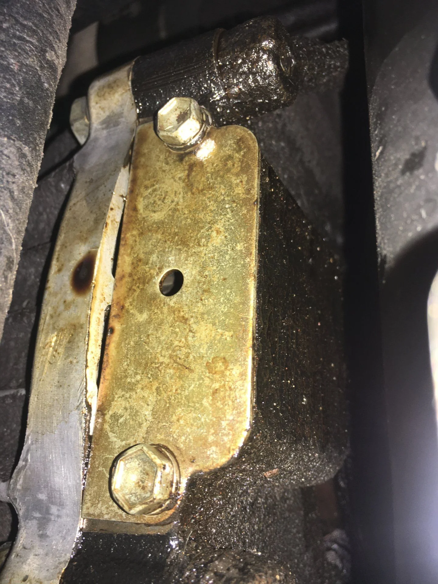

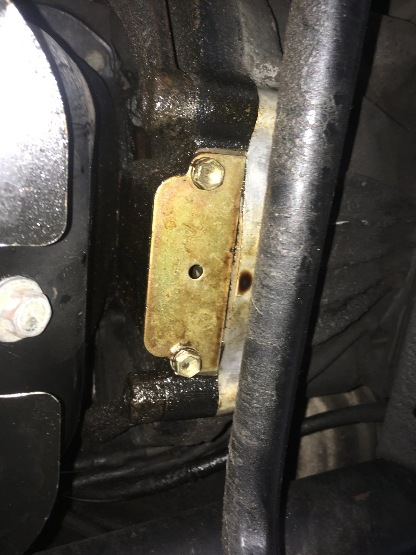

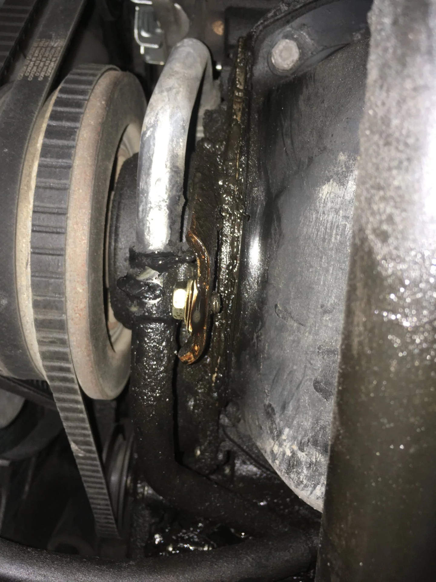

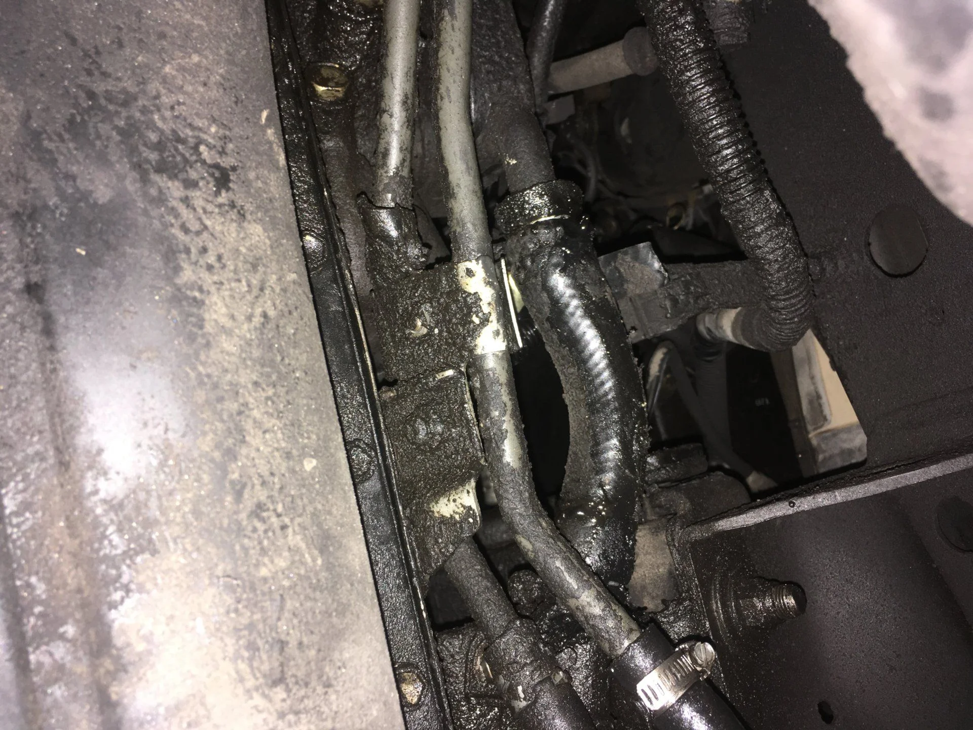

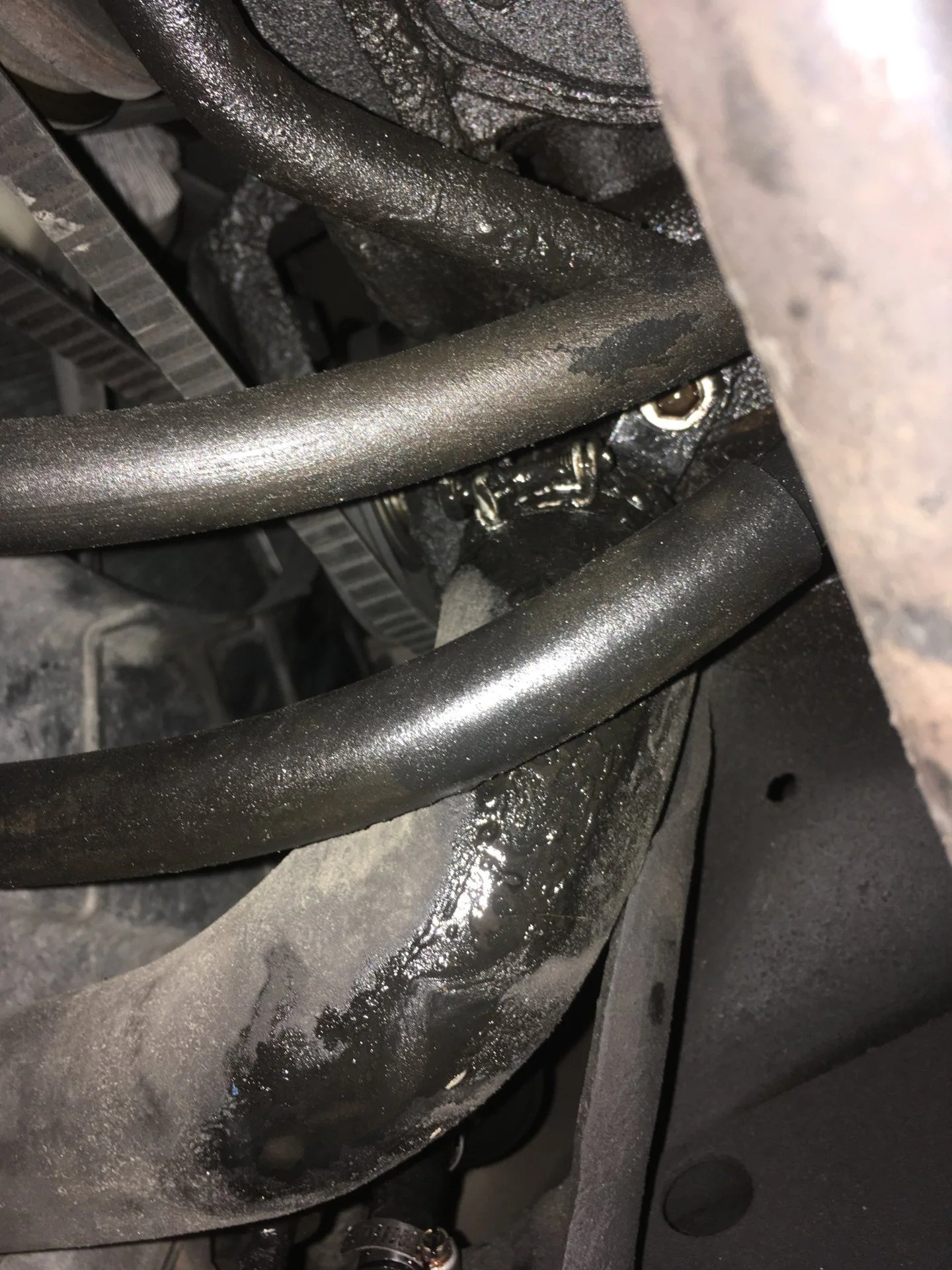

Here's some pics I'll try and get some better ones if these don't help.
