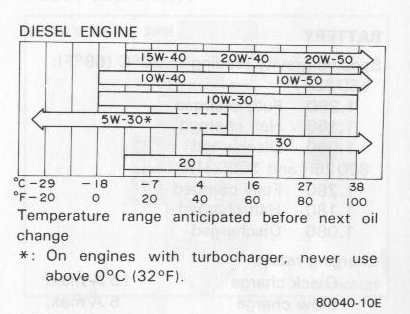

w40 is good for most climates worldwide but there are other options. Toyota publish the charts you can see in this thread:I believe it just has to be a 40w and has to be CL4 certified for diesel. But that’s it.
Nice information; thank you.w40 is good for most climates worldwide but there are other options. Toyota publish the charts you can see in this thread:

if you're in a cold climate you can run -10c and lower
0w40
5w40
10w40
as long as a 40-weight oil you are ok
I run a 15w40 all year round with no issues
