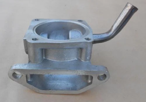

FWIW - I recently installed an '86 FJ60 rebuilt 2F motor into my '77 FJ40. The FJ60 2F motor originally had an oil cooler, but my '77 FJ40 2F didn't come with one. I opted to keep the same '77 oil routing design, and did not reinstall with the oil cooler. But that was my decision.....Here in GA with over a 1,000 miles on the rebuild and very good oil pressure, thus all appears to be well.
There is a port/nipple on the water pump and thermostat upper housing that will need to be plugged, welded shut or install a new water pump and/or thermostat housing without the oil cooler port/nipple.
Also, if your 2F currently has the oil cooler and you want to remove it, I would suggest installing a new oil filter bracket that doesn't have the oil cooler appendage. It will look like the item on the right:
Notice the upper thermostat housing without the oil cooler port:
My new water pump without the oil cooler port.
HTH

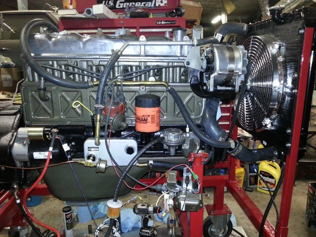

You can make the metal hoses using malleable copper tubing and never worry about them again. Go to Home Depot and get a few feet of the rolled copper. The brackets can be soldered on using regular old solder and flux. I would not eliminate the oil cooler if it were mine.
