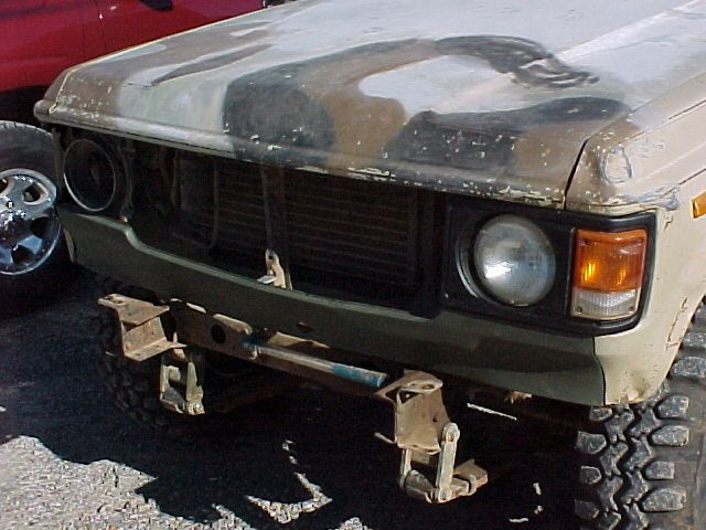

And, while I don't have any pics of Josh's rig, for your viewing pleasure, here's what it might have looked like a long, long time ago, before all of the "loving" ;p :
This truck was bought in S. Ft. Worth, one of the LSLC members found it, looked at it, passed and I bought it for $500 with bad motor........yes it has the engine from the rusty blue/silver Chicago FJ60 in now, it was a damn clean FJ60 at one time.........

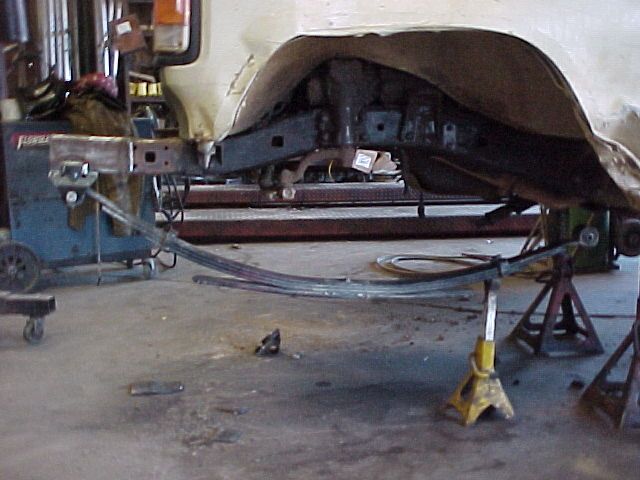

A little progress made
Got the left spring mounted on the front, still got to make the shackle and sink it into the frame. Extended the frame-rail 8" to make the 58'' springs fit, looks like a lot, but still less than a 40. The tire will set 2" forward of the stock location, so probly get to cut some off the front of the fender:D Josh
