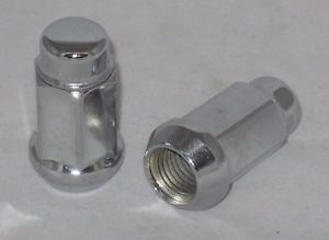

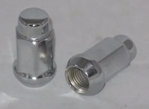

Here is a cute bit of trivia: my 80 came originally with the forged alum wheels. So the stud holes were straight and the nuts had the straight cylinder base with a big flange. But, it turns out that Toyota also put a conical end on those very nuts, and the cone angle on the nuts matched the one on at least some of their steel wheels, so the nuts can be used for both aluminum wheels with straight stud holes *and* steel wheels with conical holes. How is that for thinking?

60 deg (inclusive) cone is the most common type IIRC. And matching aftermarket nuts are relatively inexpensive I think. And you won't have to worry about having the hub hole be just right. All cheaper and easier. (Well, if you don't feel strongly about having hubcentric wheels that is... :) )

One more word of caution for folks who may not have been exposed to all this before: be careful that you don't mistake radius base nuts for conical base nuts. The former has a spherical shape to the taper rather than straight. But from far away if you don't pay attention they look the same. Yet, you really don't want to use the wrong one for the job.

The lug nuts all depends on what type of spare wheel is installed. A vehicle with aluminum wheels on the ground needs to have lug nuts that are compatible with a steel wheel if the equipped spare is steel.
For example a 2007 or newer Tundra will have the mag/shank style lug nut but with the conical end for the steel spare.
The mag/shank style nuts (without the conical end) should never be used with a steel wheel. The only examples I can think of right now that had those nuts are the Isuzu Rodeo aka Honda Passport. Maybe the Mitsubushi Montero as well...the ones back in the 90s.
Bottom line is that if your spare is steel, then most likely the lug nuts will work. May not be pretty though.

our 100 series have mag/shank with conical tips. as for these wheels, though, we need to make sure they're 60 degree angles or else get new lug nuts (which i would do anyway considering the mag/shank will look silly on the steel wheels).
