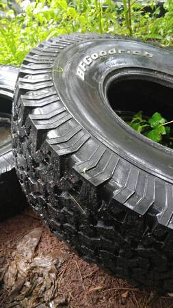

Wow, sorry this is the wrong size. Posting just in case someone is looking for a 35" spare. (... Not my tire .... Just saw it on CL)
35-12.50-15 BFG NEW!!
Lordy I don't think my FJ could bring me anywhere close to that guys price
