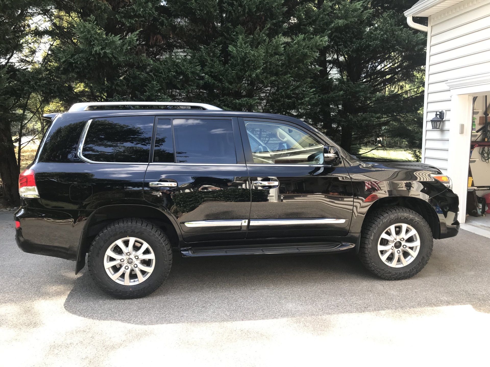

That is exactly my intention, to roll with stock 20s while I'm hunting for wheel/tire combo.
Do you think you'd have any fitment issues if you had stock bumper?

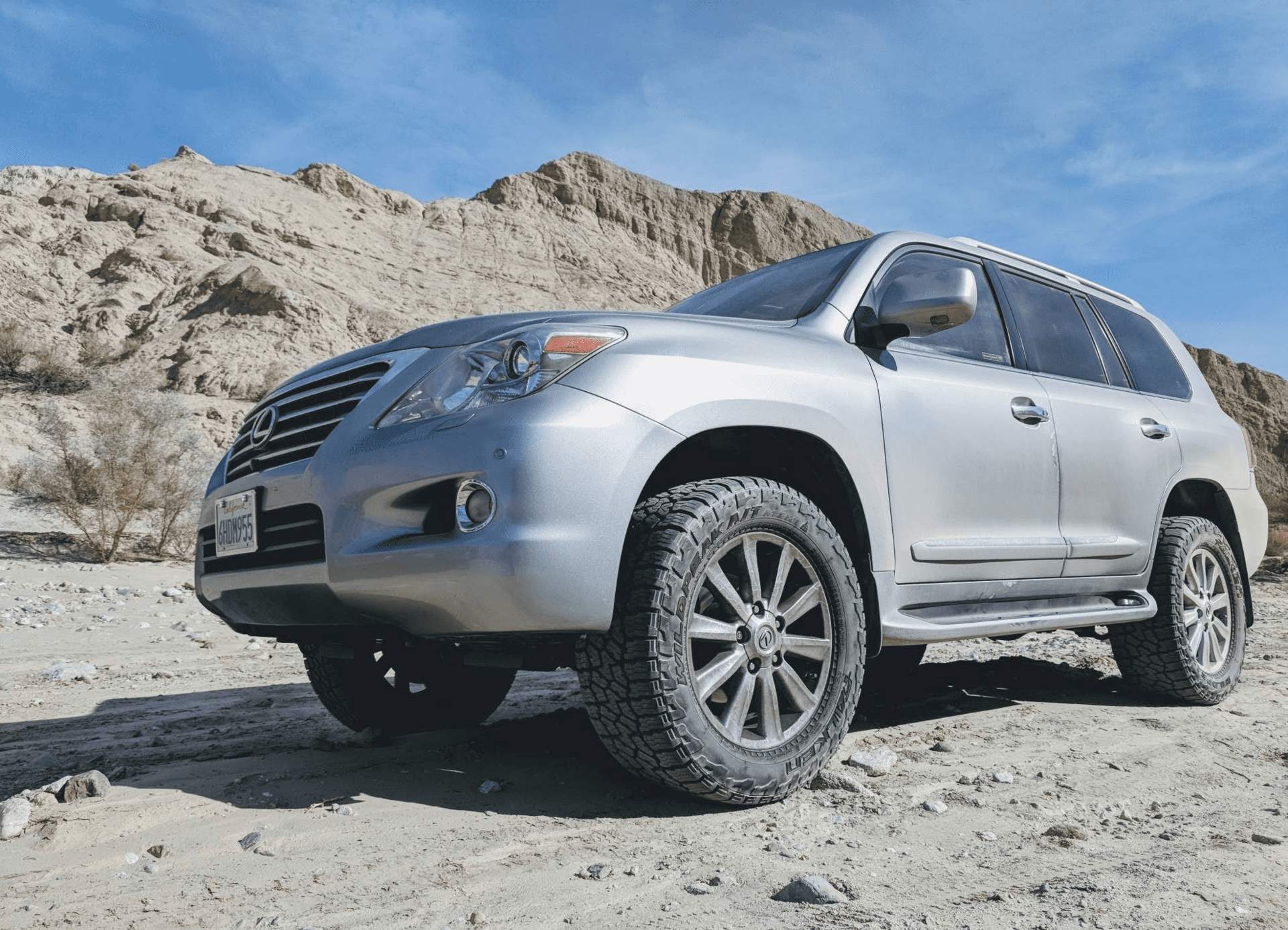

Yeah, when I picked up my LX, I drove it directly to the tire shop to get these KO2s installed. I wasn't prepared to do a full wheel/tire upgrade so these were a temporary fix. The tires that were on the LX were possibly the worst tires I have ever experienced. I don't remember the brand but nobody at the tire shop had ever heard of it and I remember googling them at the time and not finding anything about them.
In any case, they are great tires. The only downside about the combination is the additional weight which is about 15 lbs over and the ride on 20" wheels isn't great (that's true even with high-end touring tires though). One other downside is that this size is D rated.
There are no fitment issues. This is a pretty conservative size and there is plenty of space (too much empty space for my tastes). Here is a pic with the stock bumpers:
You may want to consider looking at the 285/60/20 instead. It is E rated and is 33.5" (versus 32.4). While I can't say for sure that you wouldn't encounter rubbing somewhere, if you can find a shop to check the fitment for you, it may be a better option if it works. Of course it adds another 10 lb per tire.

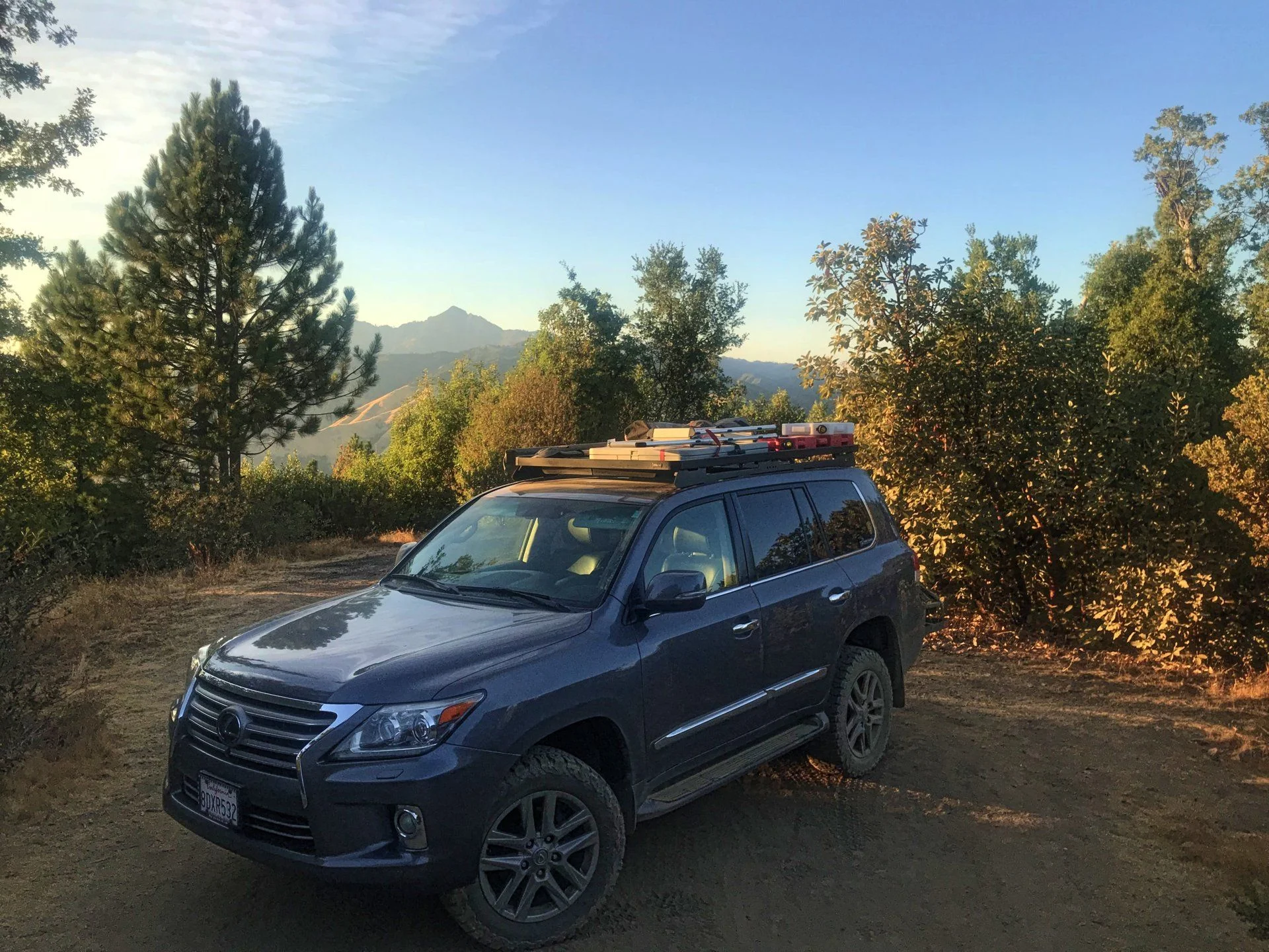

Went up to the Bowman Lake area for the weekend. That area simply amazes every time I go. So many trails leading to alpine lakes, meadows, old homesteads, and remote campgrounds. There just isn't enough time and every place you go seems better than the last. I did a loop starting at Yuba Pass on I-80, down 20 to FS18/Bowman Lake Rd to Meadow Lake Rd Around Bowman Lake, to Jackson Meadows, to Webber Lake, to 89, back to I-80. Camping stops at Lindsey Lake, Faucherie Lake, and Webber Lake. Here are a few shots:
