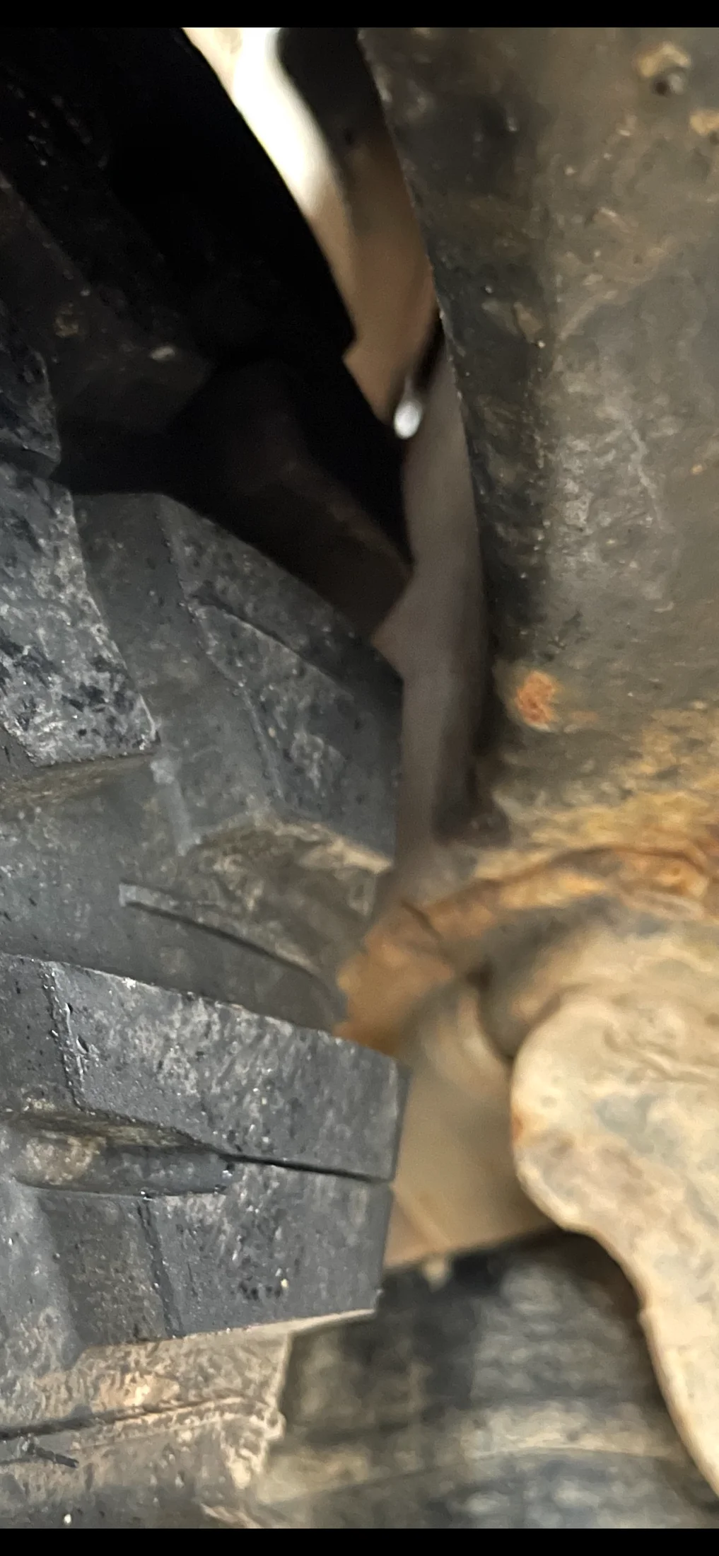

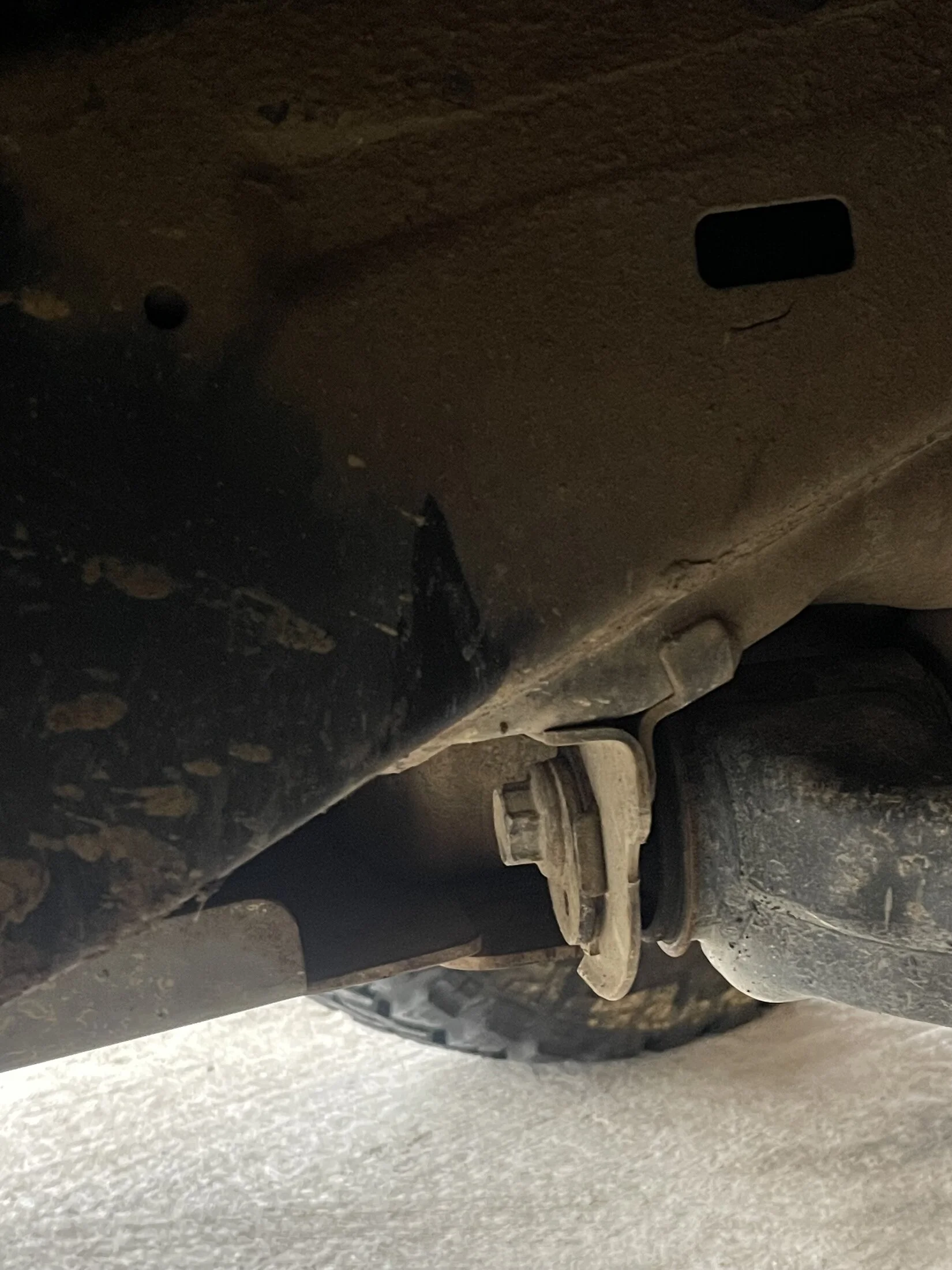

I just got under the LX after light wheeling yesterday, where it was flexed decently a few times and a few full lock with compression situations.
You can see where the tire contacted the frame in the first picture. While stationary at full lock, it doesn’t come too too close to the frame. I am on 35offset wheels, and just want to be sure 25 offset will be enough to clear. As others like @Killacaviar do.
In the second picture it looks like it is just the outer corner of the innermost tread block Maybe it is the alignment too as I have the SPC UCAs?
Seems to miss the body mount unless going downhill and fully stuffed, where it barely kisses the BM. I am going to do the more aggressive BMC as advised by @MTKID so not concerned about that.
Any suggestions or feedback is much appreciated.
Any suggestions or feedback is much appreciated.View attachment 3819459View attachment 3819462

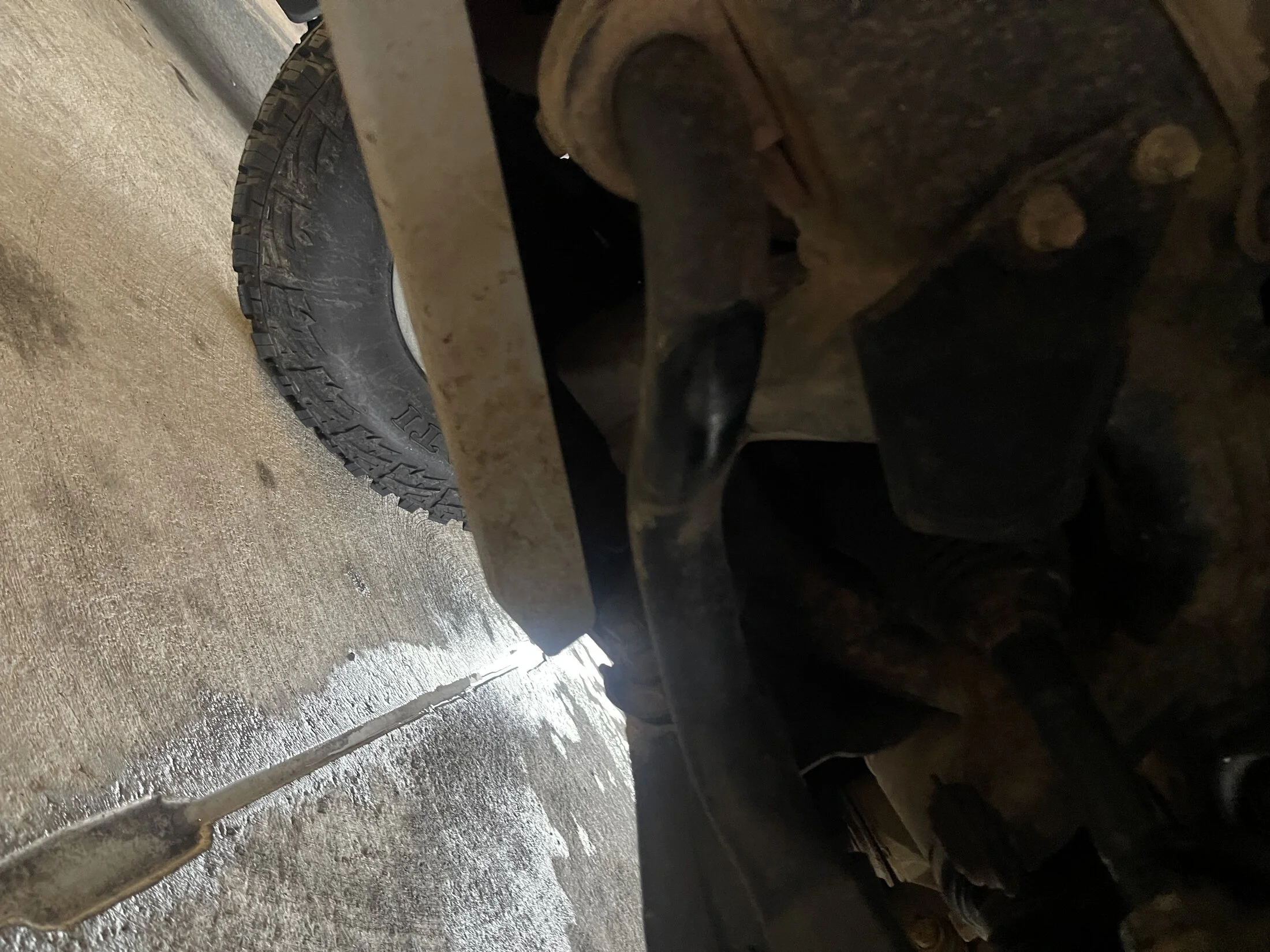

Surprised you rub there and not the sway bar. My 35x12.50s on 25mm rub sway bar quite a bit but not enough to worry about.
Clearances are super tight.
I'm at +28mm and don't have issues with contact of the frame. It is close enough that I've had to reshape the plastic engine shield though. Sway bar too.
I have always just checked BMC and I saw the frame once and just stayed focused there. Never bothered to look at the sway bar until your comment. And I definitely do run on the sway bar. Not too bad with the sway bar I take it?
Glad to hear you all are good on the frame at 28/25 offset.
How bad is your rubbing on the sway bar?
I wonder if I push the wheels forward I can avoid the sway bar some.
