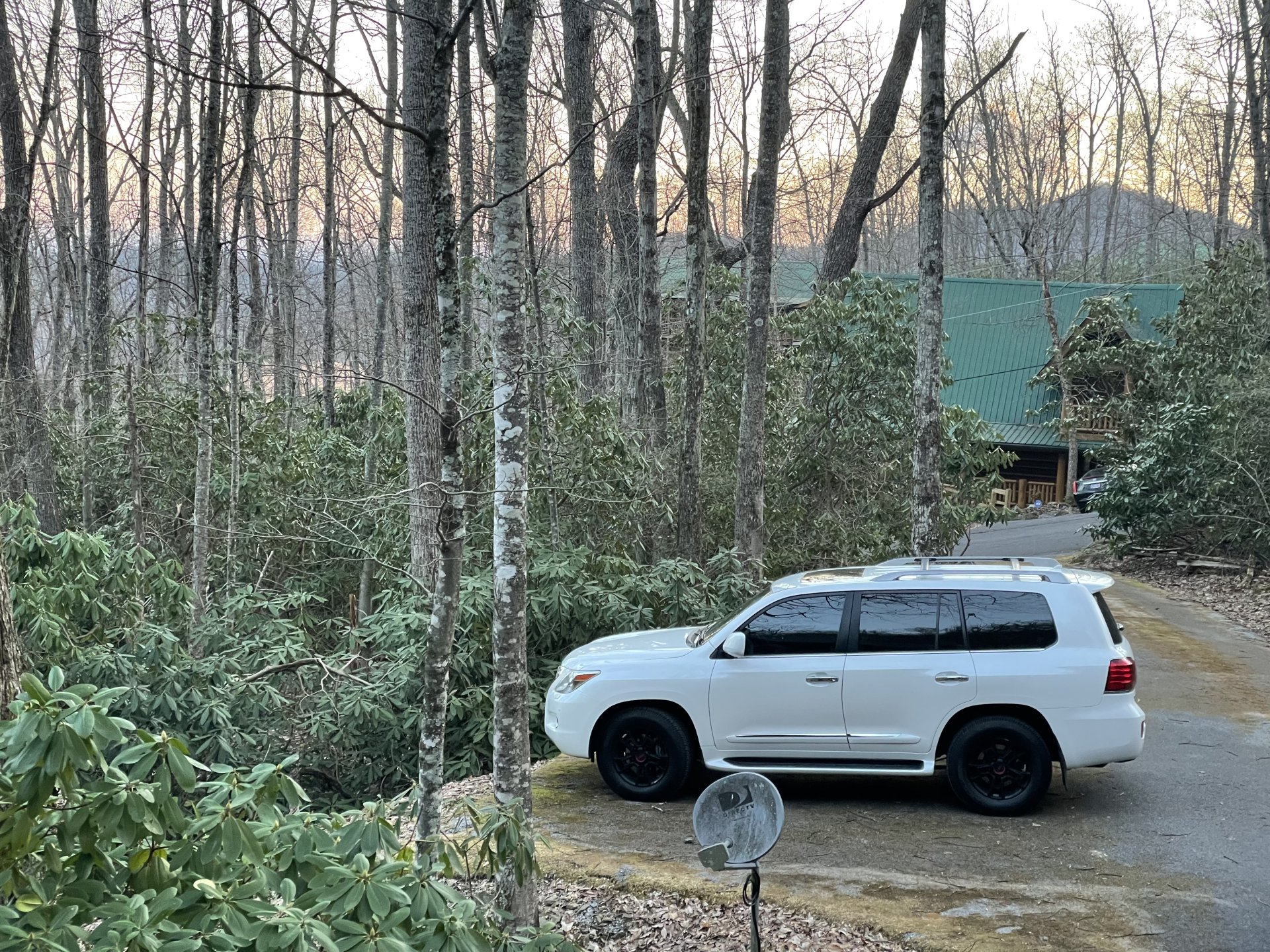

Heading out to Big Bend tomorrow and this was our view as we left the neighborhood.

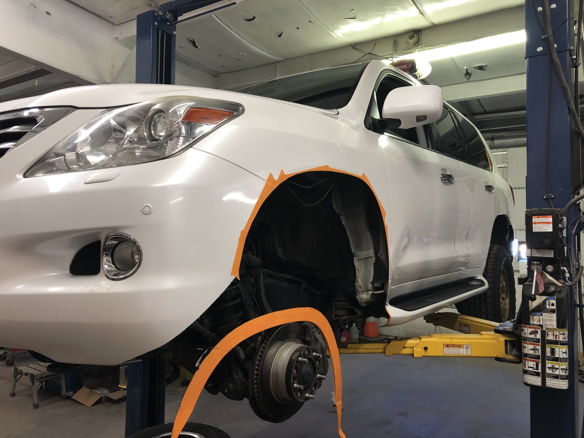

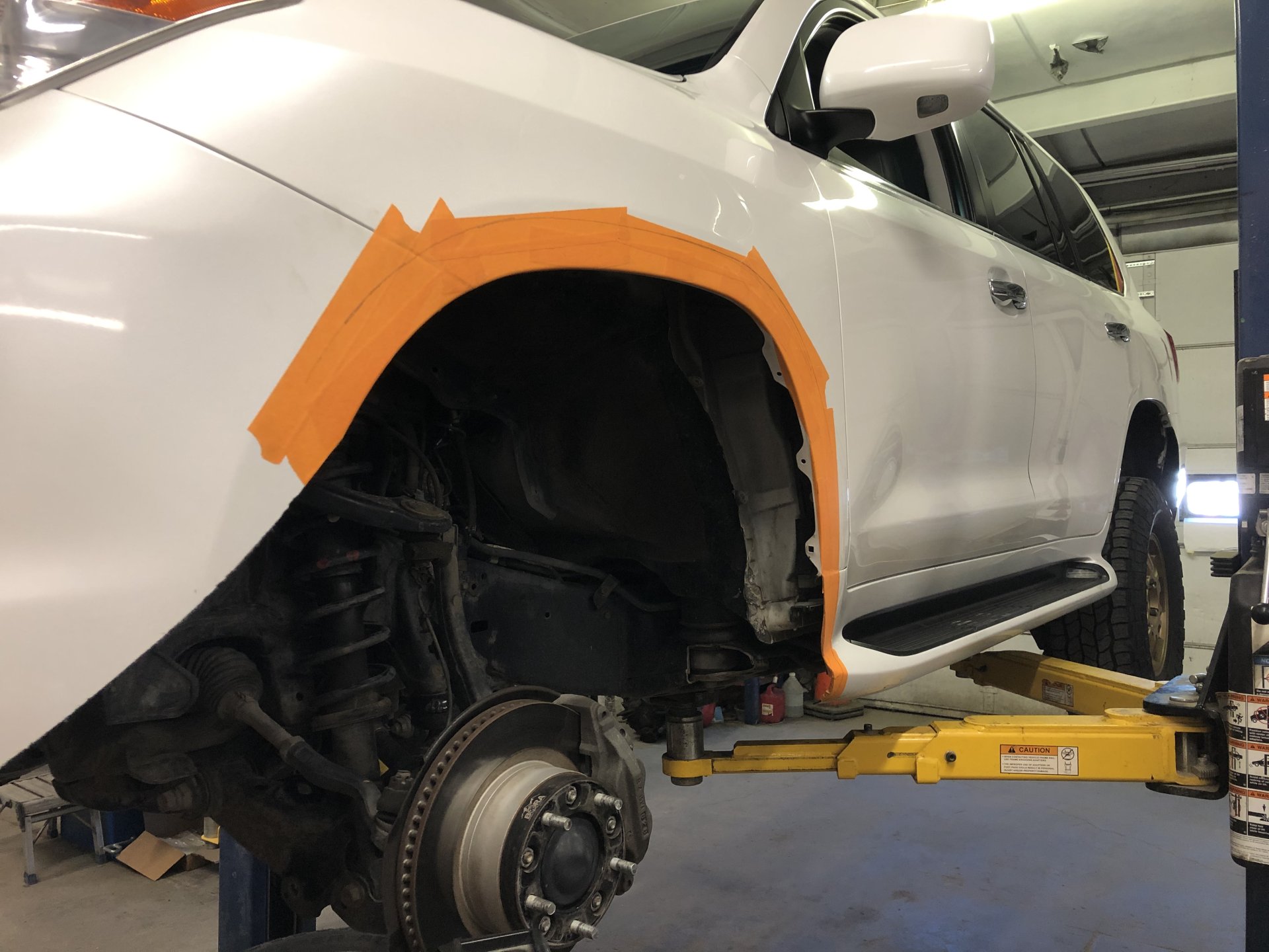

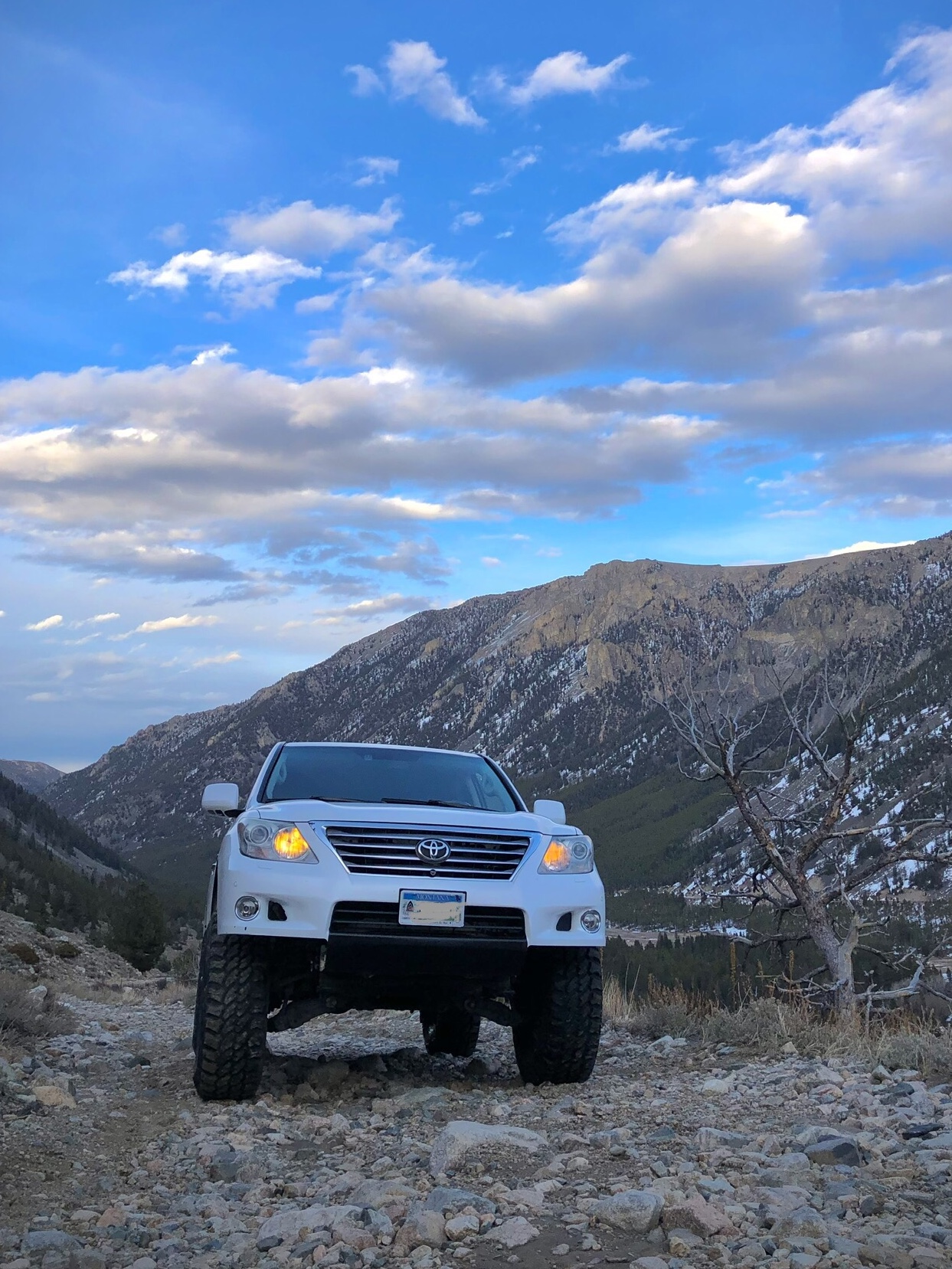

You’re probably already aware but the front outer fenders are already cut ~2” at the top, more along the back edge in front of the door. Rear fenders are still unmolested so I can measure them for you.
And just another current photo for the fun of it…

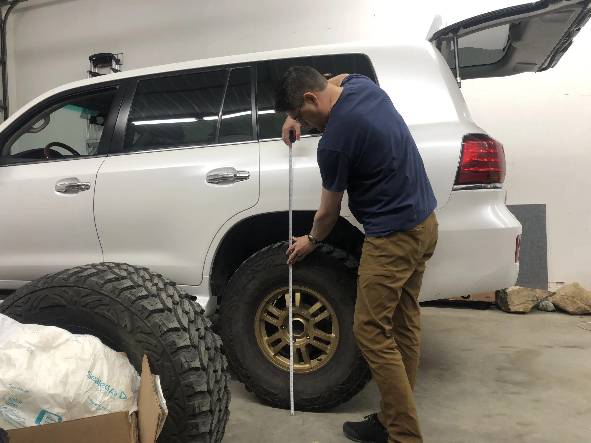

42” from ground to rear fender in High on driver’s side. 25 1/4” from hub to fender. About 3/8” higher on the passenger side 🙄
Edit: …which got me curious, and the front is 43 1/4” ground to cut fender, and 3/8 higher on passenger side too …for those curious.

😂 If you couldn’t tell from the photo, I’m pretty tall and I’ve got monkey arms, so I don’t have to jump to reach much 🤪 And I can just squeak into the garage in AHC High, with the little shark fin thing touching the door seal 😉 I’ll have to stay in Normal if I have the 40’s on it going into the garage.
It always surprises me how close most other built 200’s are. My rear fenders are only 1 1/2” over yours, which my body lift is about 1 3/8” around that location, so even with these tires, that’s only 1/8” if you remove the BL from the equation 🤷🏻‍♂️
Can’t wait to hear if you succeed in lengthening an AHC shock 👌🏼
And one more recent photo since this is that thread…
