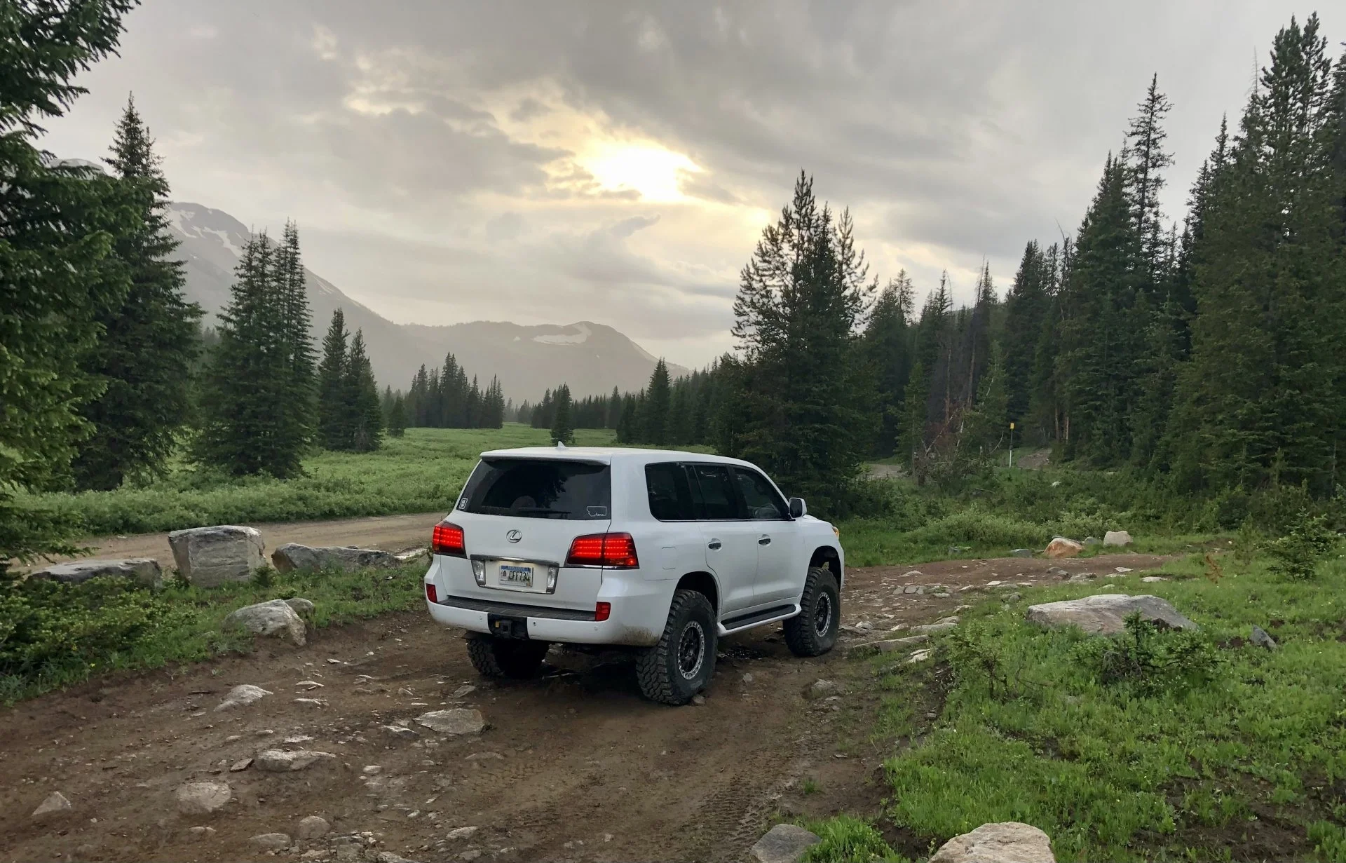

I’m guessing driving my vehicle without anything behind it is like what you feel like when towing 😆 so… probably not ideal for towing …unless you added a SC 🤔
Otherwise, your description is exactly my design philosophy. This is the first real trail I’ve taken it on with these tires and it blew me away how well it did. Dropped to 8psi and it really rode well. The harshness I had felt in AHC high seemed to disappear.
I’ll try to keep sharing photos and progress.
...and I certainly live vicariously through others that drive the Rubicon trail and Moab 😉
