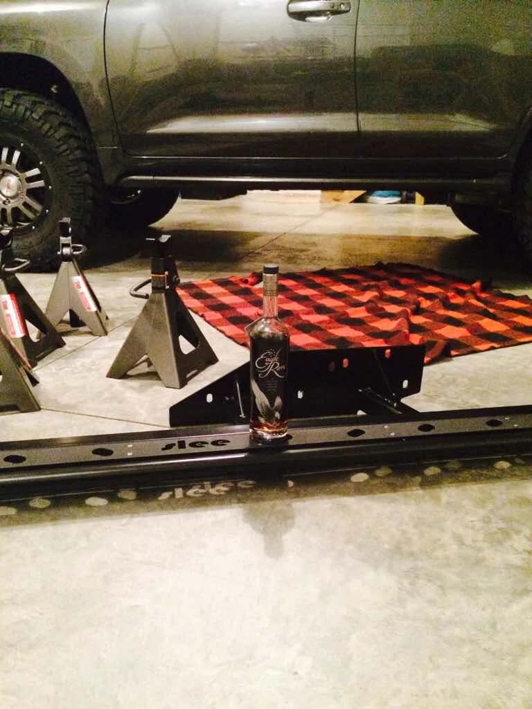

Step one
I do like me some Eagle Rare! 10 yr?
Yes sir
