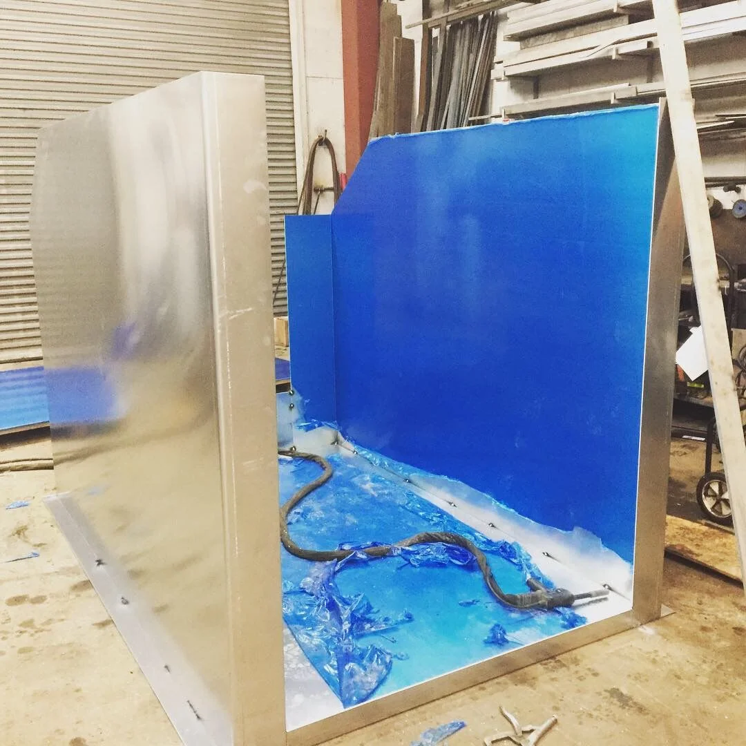

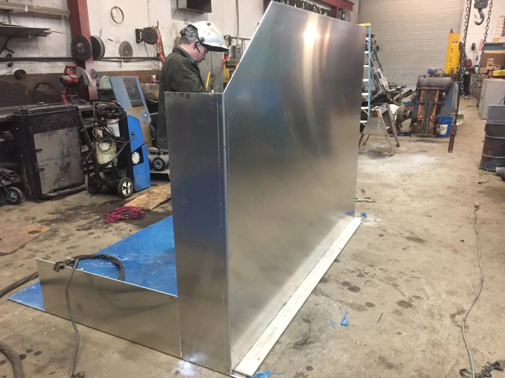

I used 3/16” Aluminum body panels with supports above and below.

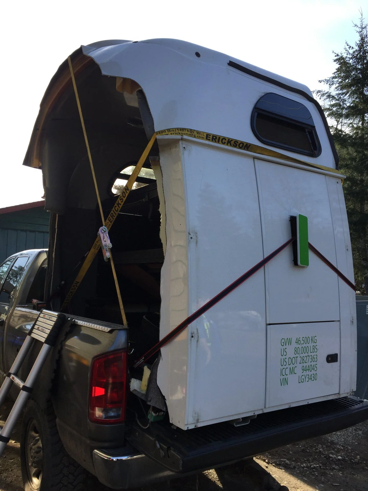

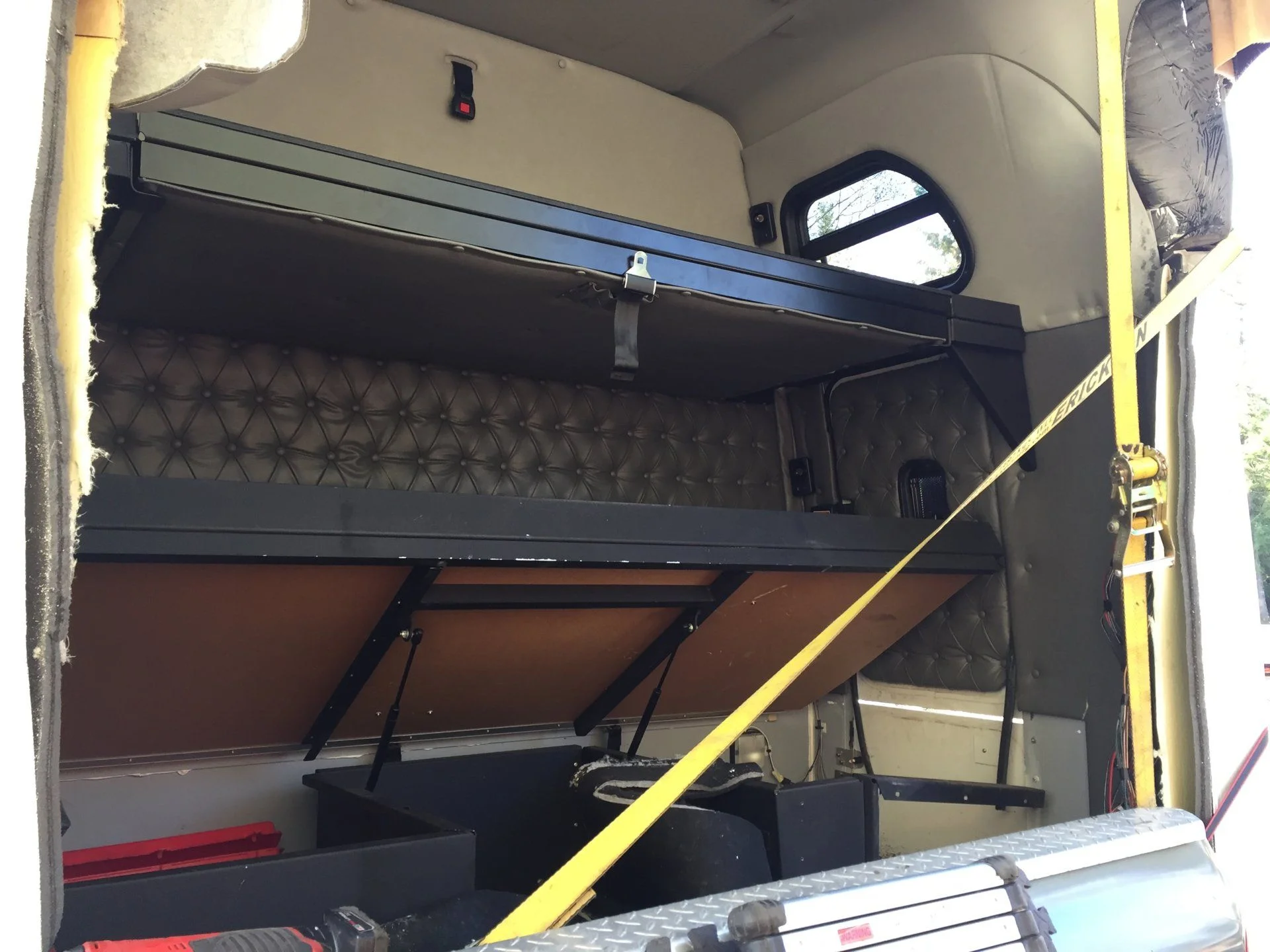

My buddy tells me to come over and pickup my new bunk bed system for the trailer yesterday so when I get there there’s this...we’ll see what happens.

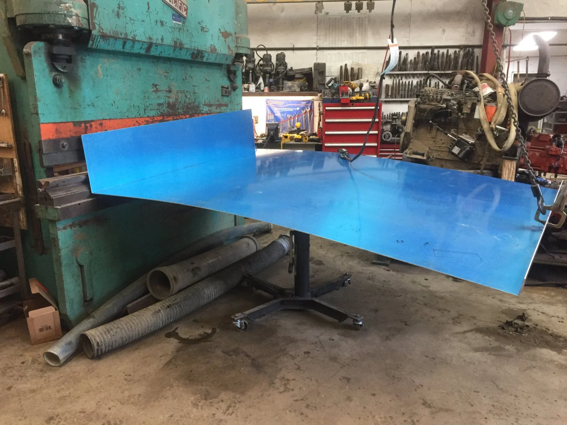

Awesome Paul! Can't wait to see how this thing turns out. I'm looking forward to your updates as it progresses. I never would have thought to look at a sleeper cabin from a freight truck for bunks, but makes total sense! That is quite the shop btw; what a HUGE press brake.
Yeah, that brake can bend 8’ wide and 1/4” thick steel. It’s a beast.
I’m very fortunate to have a friend as resourceful as him...never ceases to amaze me what shows up there. When he said he had bunks for me I had no idea.
I guess see what the bunks weigh, what a semi can haul is somewhat less weight sensitive
than your off road trailer.
Are you saying a BJ74 isn't a semi? :)
I'm betting the bunks are reasonably light as they are mounted to a tall (frameless?) fiberglass structure.

I can't imagine those semi bunks are too savagely heavy, ya gotta build them out of something either way.
hopefully plywood rather than particle board but even then the frames would be useful.

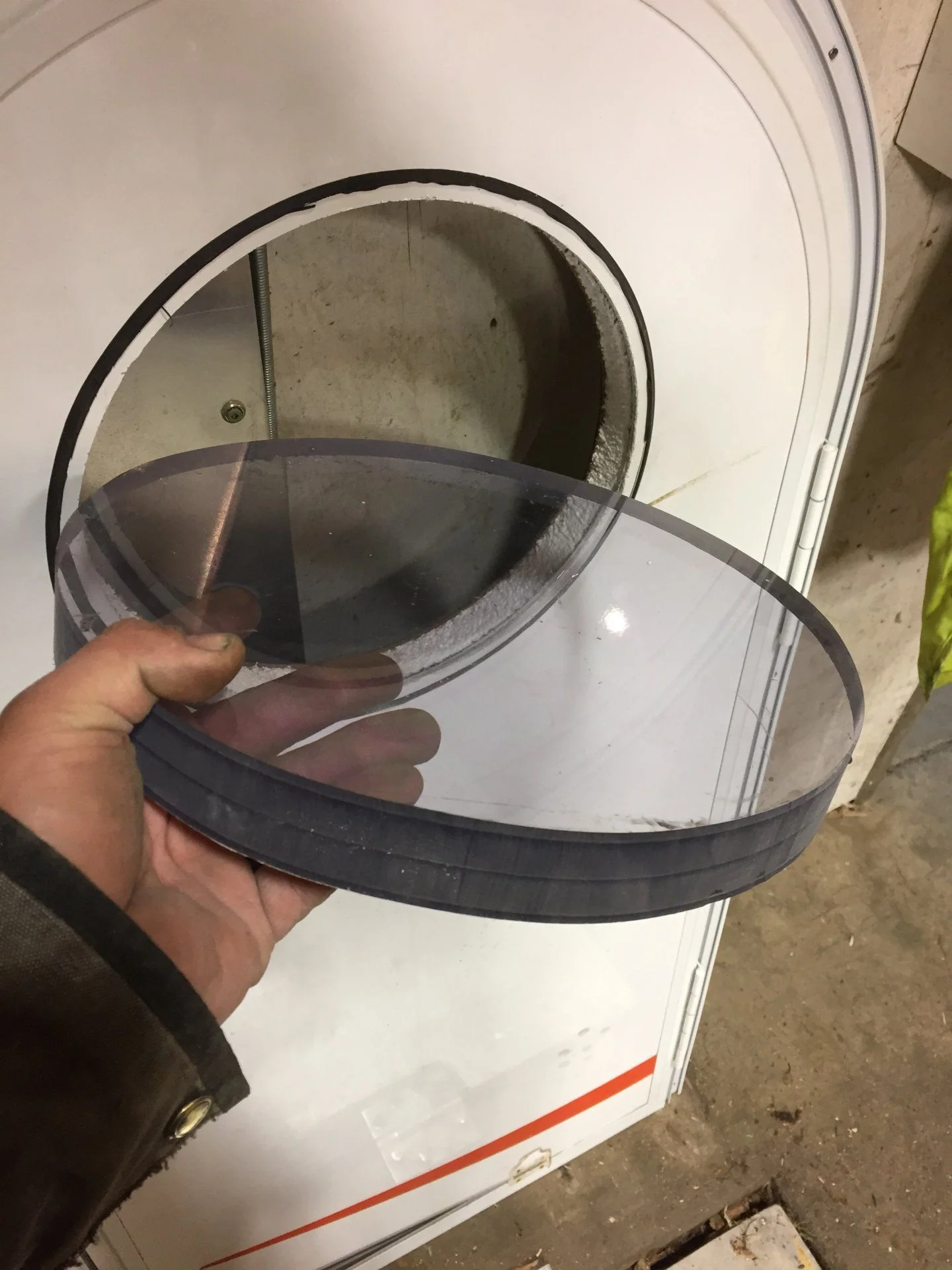

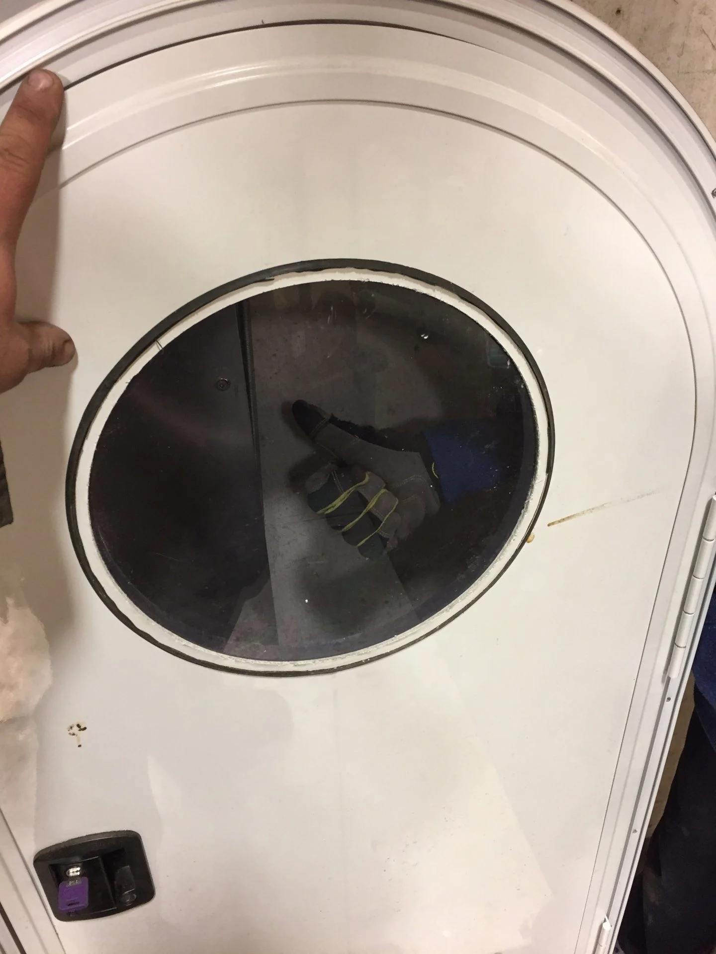

Picked a couple of these matching doors up from a local RV place because some rain had penetrated between the plywood and rubber wall adhesive covering and made a small bubbling effect. I paid a drastically reduced price compared to the $800+ retail price! They came with the frame and keys for the locks too! I’m only going to use one for this build though. However, they kept the window for some odd reason.
That’s okay though...had some 1-1/2” thick bullet proof plexi kicking around for the past 20yrs that finally found a new home :)
Some Sicaflex should hold it in there half decently.
Ever thought of using the brake to bend up some 1/4 panels? I’ve been wanting to replace mine for years... torn between 1/8” and thin sheet metal that can be rolled.

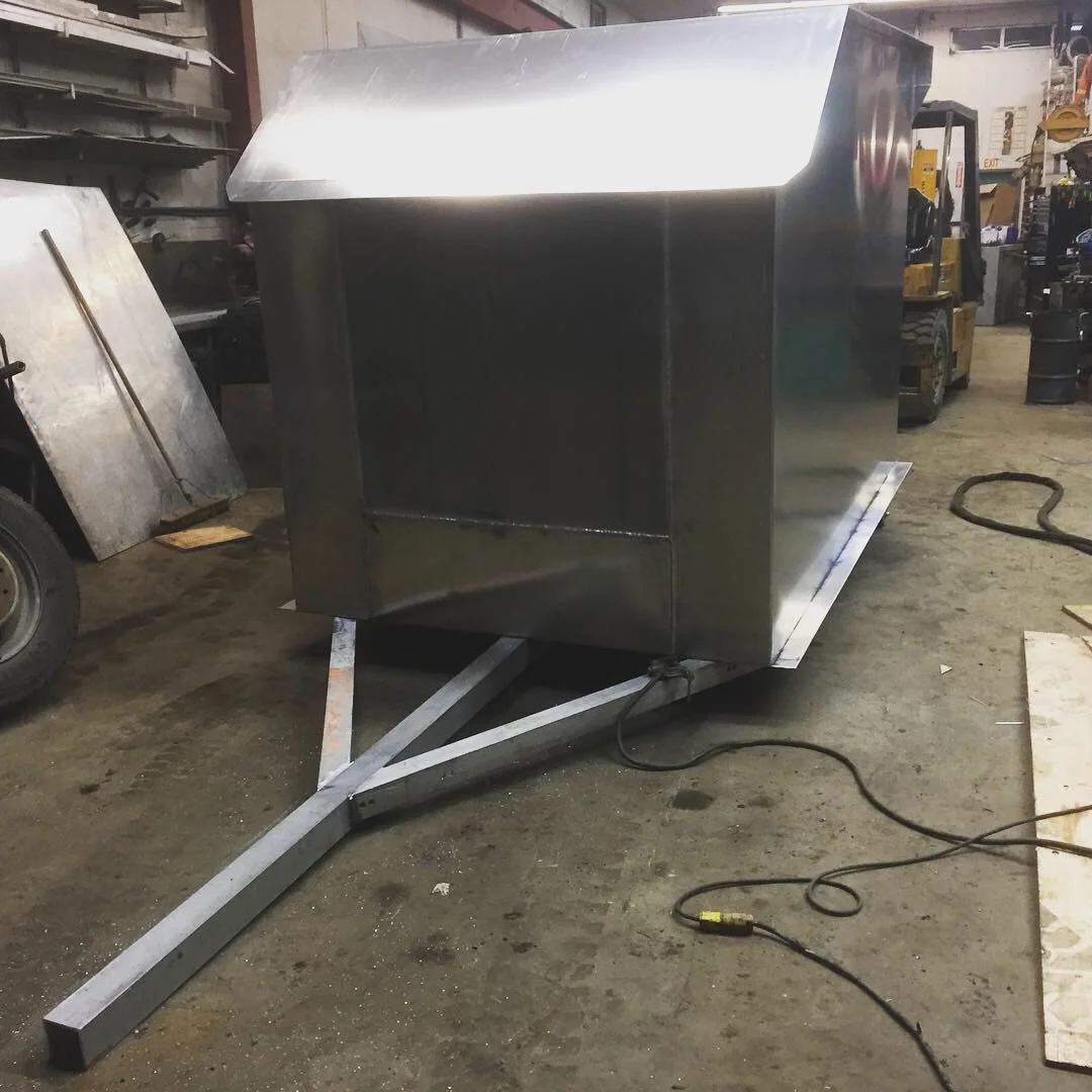

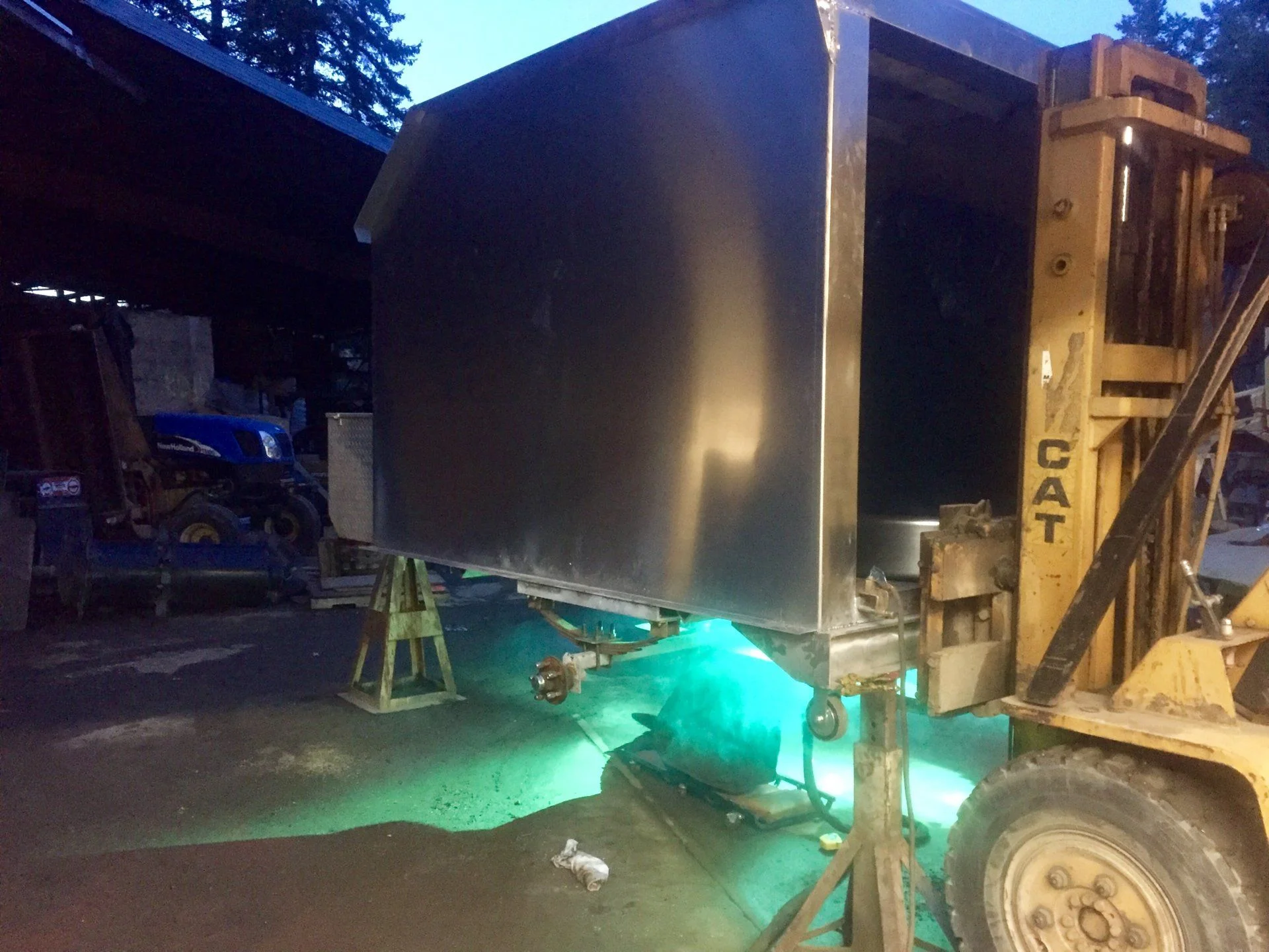

Axle installed last night. For those wondering, this is a low budget build so regarding the axle, it was free so that’s what went in. I mean, I rebuilt the hubs and put new ubolts on so there’s that.
Changed some bed setup plans and rear door ideas so back to the drawing board for those.
Because it’s 3/16” Aluminum, I’m thinking about welding some hinged folding shelves onto each side for added space to do food prep or fish cleaning or whatevs. We’ll see...
Looks great Paul, if you get a chance take some more pictures in better light...Those jack stands are seriously beef.:):cool:
Yeah, everything he has is pretty beef! I’m hoping to get back there during daylight but I’m mostly heading over in the evenings so light is sparse. Soon it will be rolling and I can bring it home to do the finishing touches.
