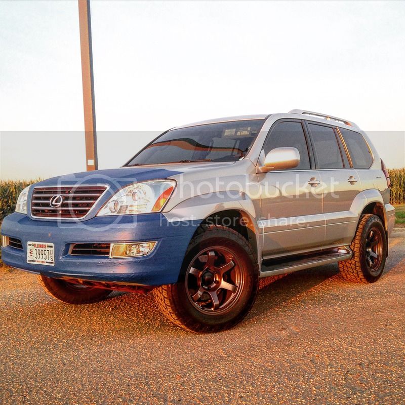

If you look at my pics in my thread I have -12 offset and 4.5" backspacing. It brings them out to an awesome stance (but will rub without a body mount chop on 285/75R17)

I think I have pics posted of my mount chop...but here is how much I got rid of.
