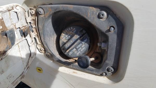

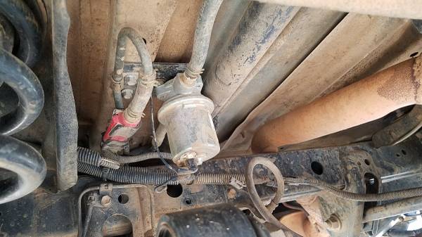

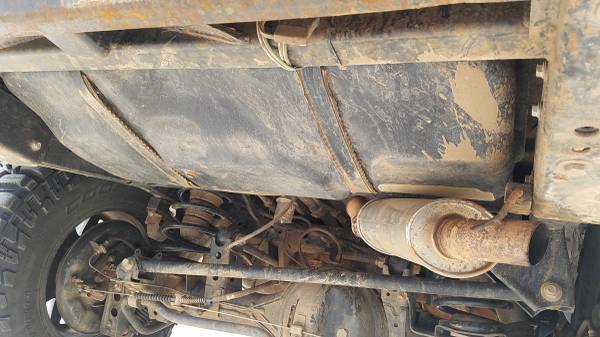

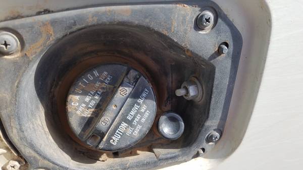

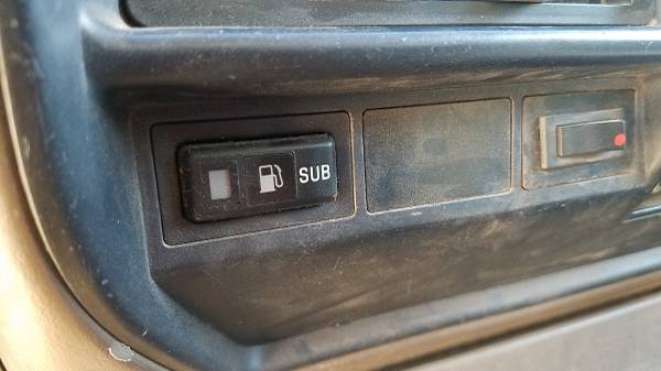

For those members who have the money here is a complete factory toyota sub tank system that came up on Craigs list. I'm not selling this, nor do i know the seller, so please don't contact me. I'm only posting this to maybe help out another member who is looking for the factory 80 series Toyota sub tank setup. Below is a copy of everything from the sellers ad, seller is located in Payson Arizona.
  • contact name:
    Kyle
  • call or text:
    ☎ (928) 358-8833
  • Toyota land cruiser 80 series and lx450 factory 15 gallon sub tank.
    Complete kit, tank, dual filler neck, simple transfer system using oem switch, napa transfer pump(6 months old), and a flow switch, wiring, and all fuel lines. Works great.
    Fuel tank had all baffles fixed(common with the spot welds coming apart) and resealed. Pickup tube and gasket recent with oem parts.
    Asking $1200

Question though, has anyone used the factory fuel switch without using the sending/fuel cut off feature? I’m just looking for On/Off and illumination when the key is on.
