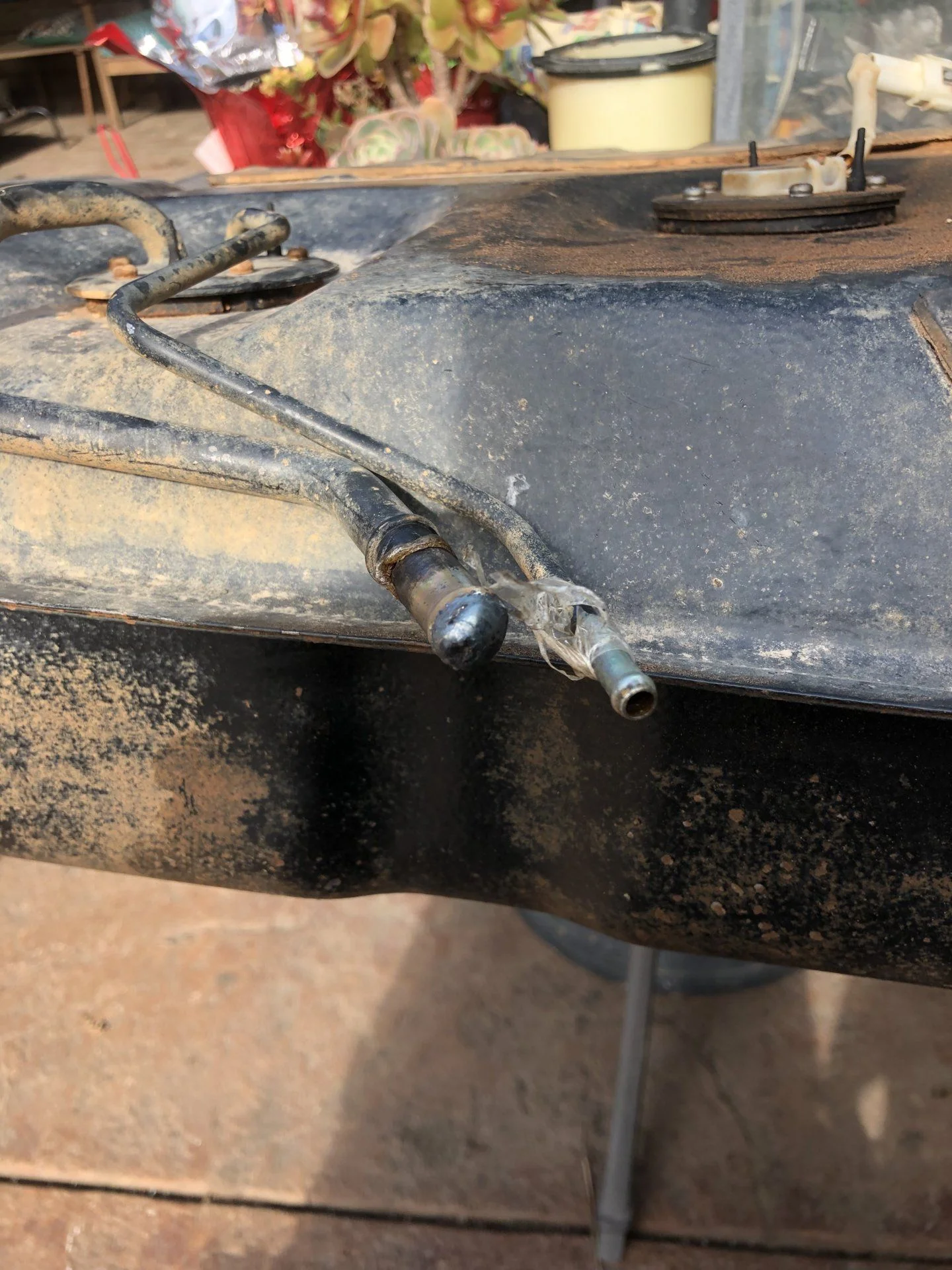

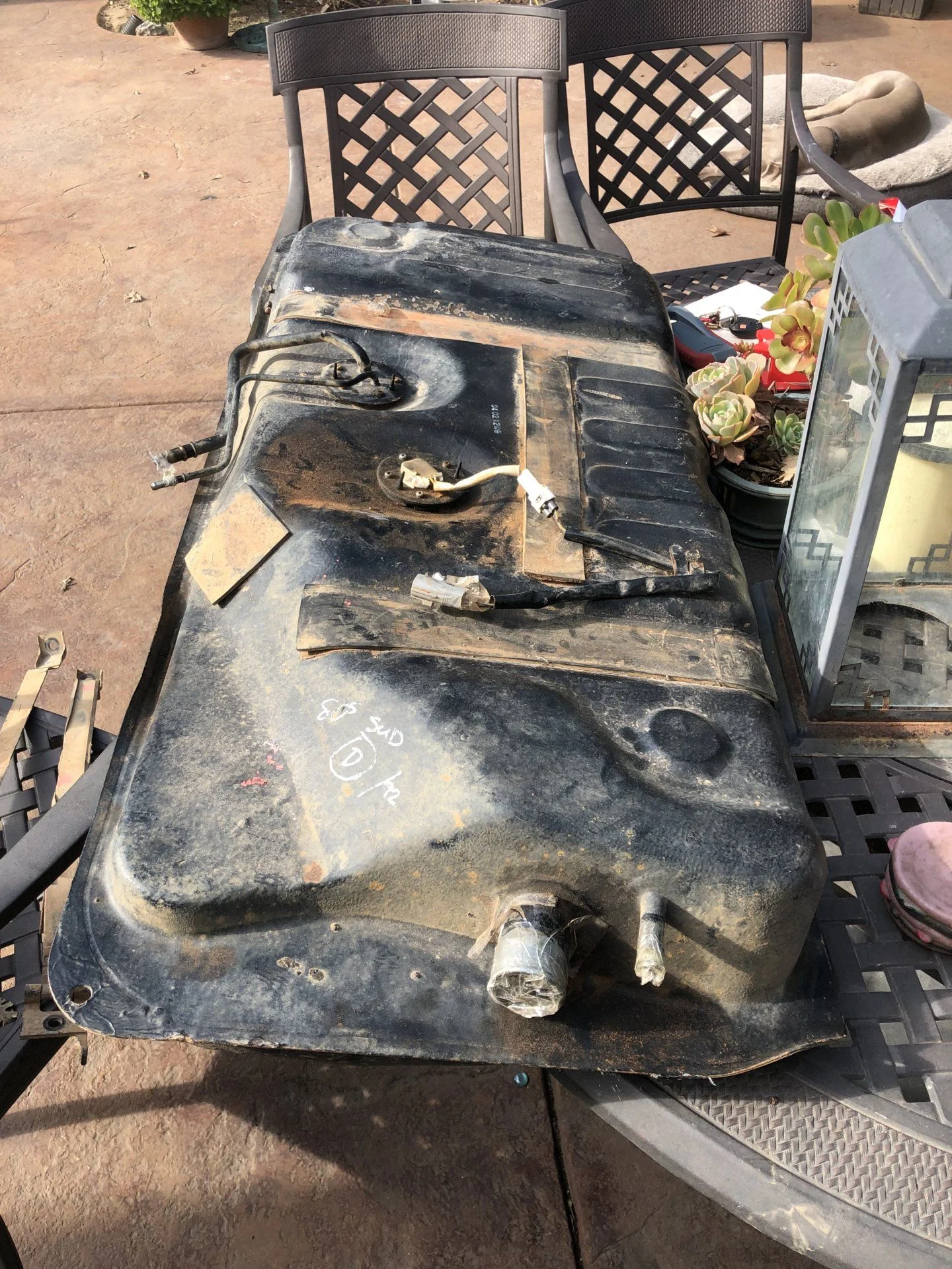

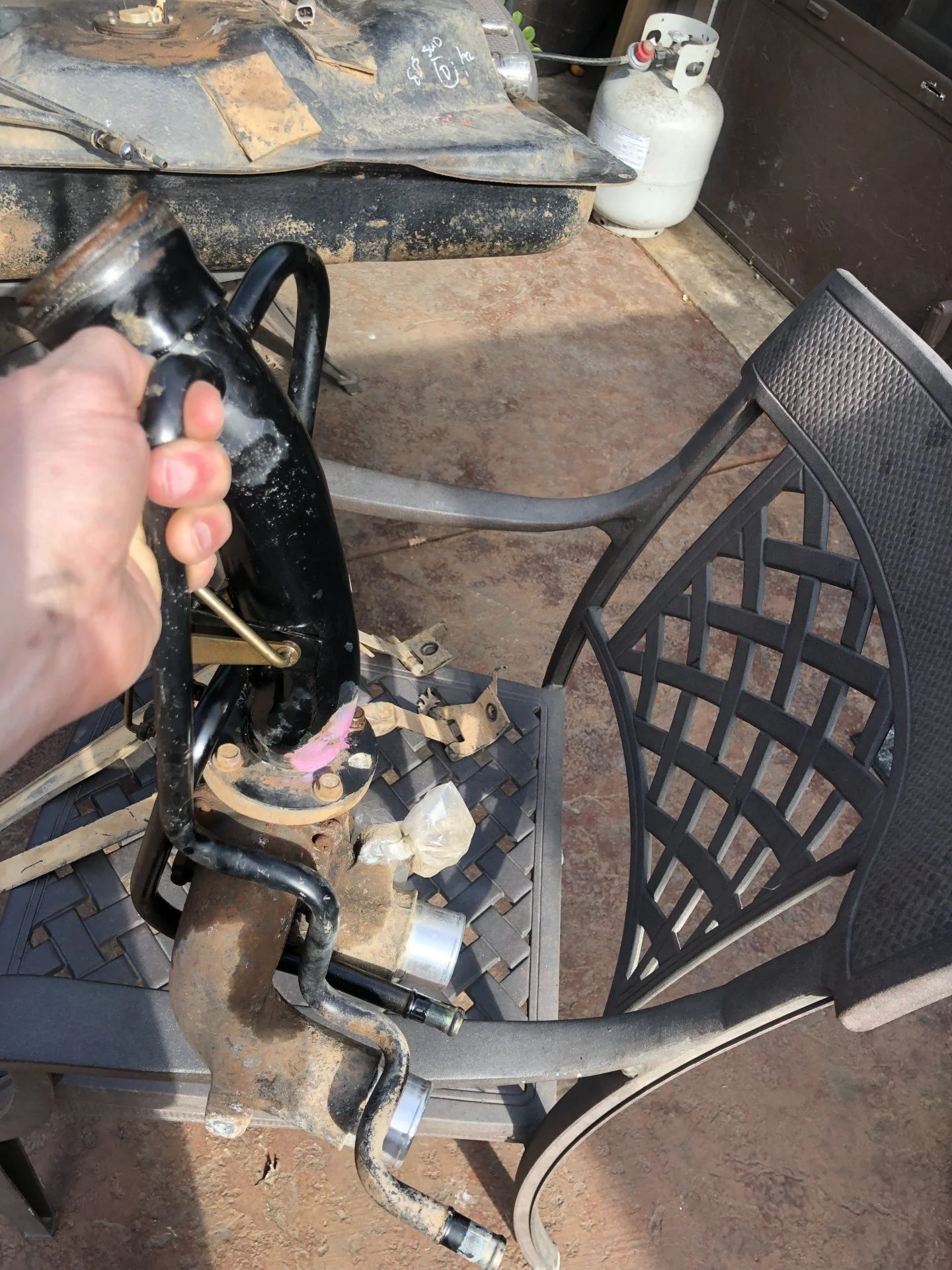

Some picks. I welded up the diesel fuel pickup today. Leaving the 5/16” pickup open.

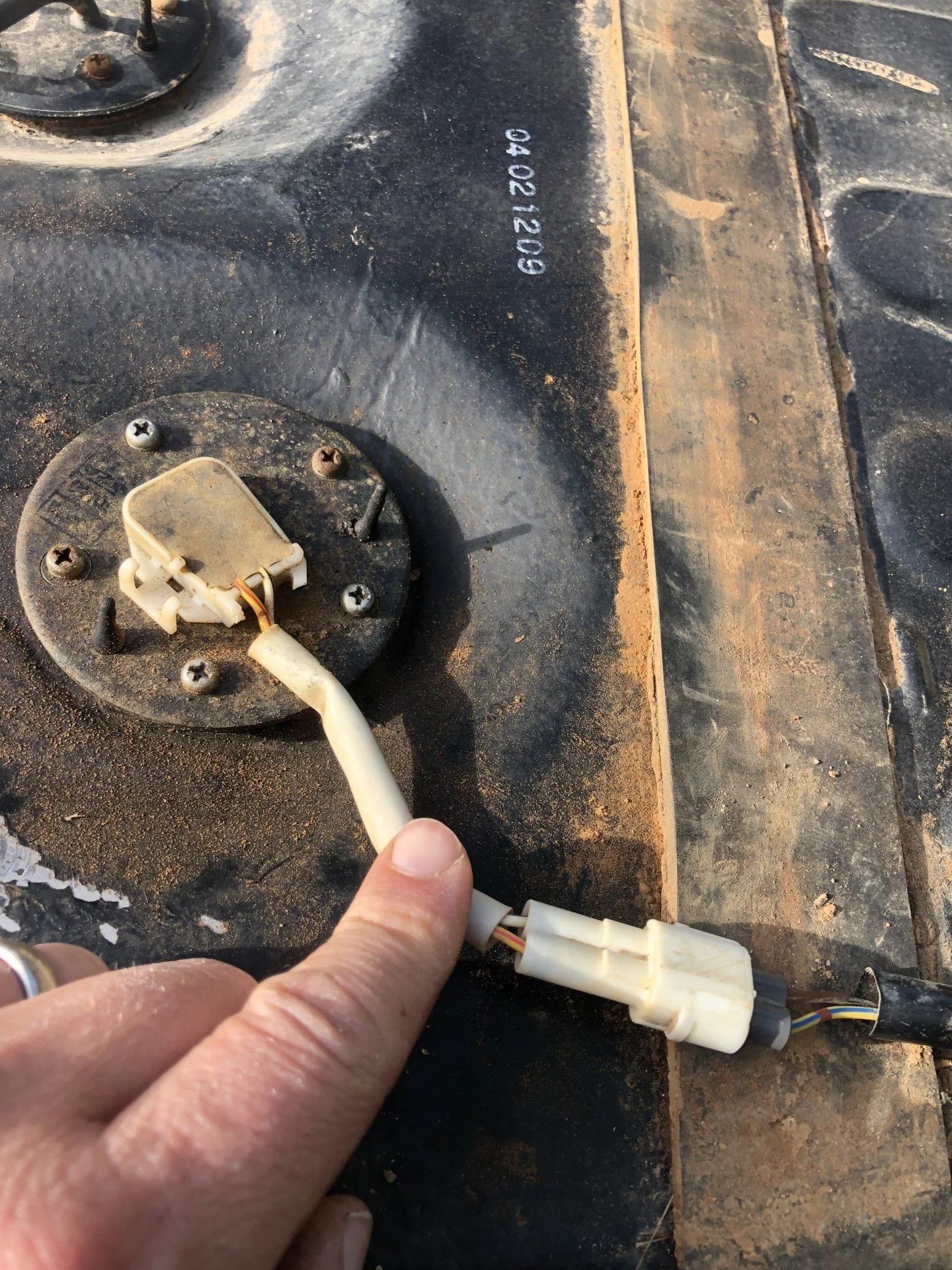

Does anyone know what wire does what on the diesel fuel sender?
Are you sure thats a pickup and not just a return? did you check if it went all the way to the bowl?
So.. now Im wondering why it has two pickups? why the smaller one?
Not to sharpshoot you but it does look like its a retrun.
"On a diesel tank there should also be a return line, since on the diesel the engine can draw fuel from either tank (so a return must exist). On the petrol it is a transfer system when fuel is transferred from the sub to the main, so only one fuel line (outlet) is required."
But if it does go all the way to the fuel bowl in the bottom of the tank it should work great!
It’s funny, I’m thinking the same thing. Luckily I can cut the plug and use it as is

Well.. if you pulled it and checked if it goes all the way down like the main one.. use it!!
And let us ( me! ) know how it works!
