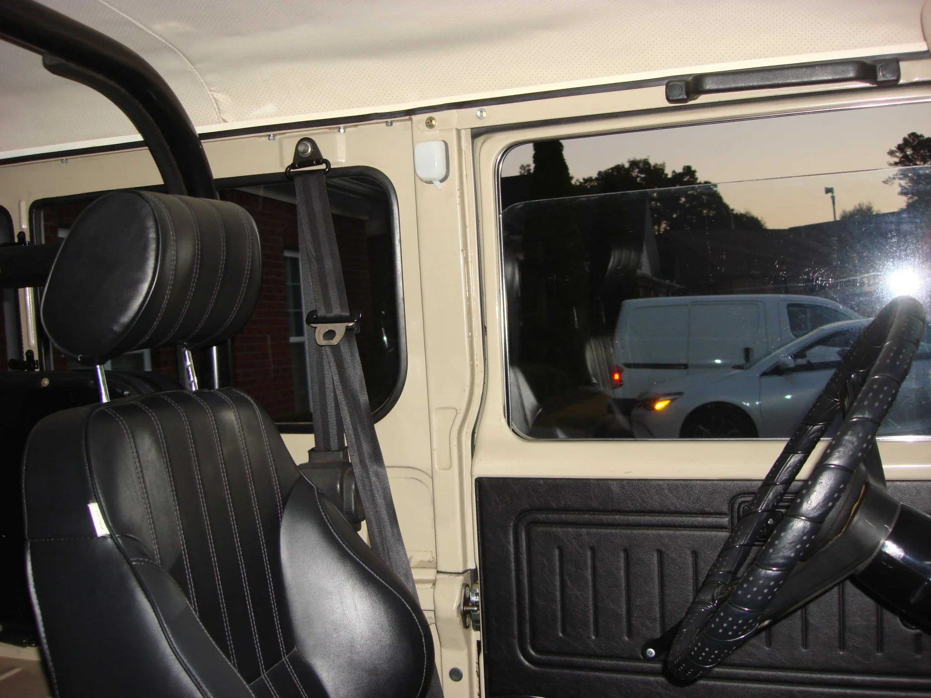

Thanks...and the retractor looks like it's mounted to the side of the hardtop, correct?
Wait...that's how the '77 was mounted, not the '78. '78s were always mounted to the roll bar both top and bottom (mostly sure :hmm:). My 8/77 mounted to the hard top as shown but I bought a 78 roll bar and swapped it in to get the seat belts mounted to the roll bar.

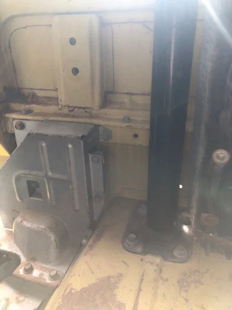

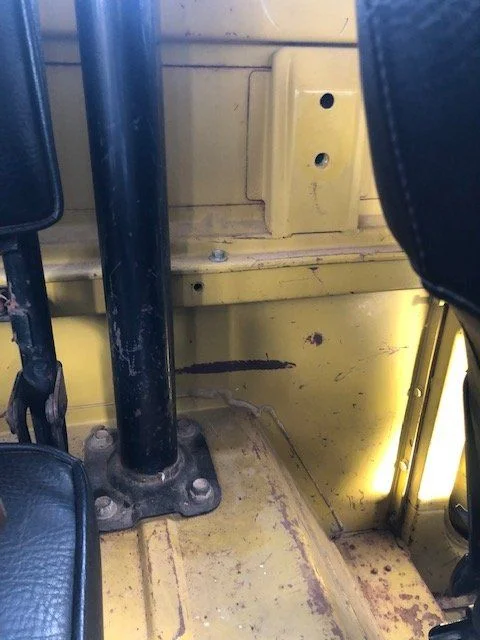

@78Mustard - Do you not have mounts for your retractor at the bottom of the roll bar?
Yep ‘78 mounts to roll bar. Mine is a ‘10/78. ‘76 and ‘77 mount to side of hardtop
I bought my 78 new in Dec. '77 and the seat belt retractors were bolted to the hard top as shown in post #2. There was no mounting bracket on the rollbar. I added a mount to the side of the tub several years later for use when the top was off.
Same here, 12/77 manufacturing date, mounted to the hard top

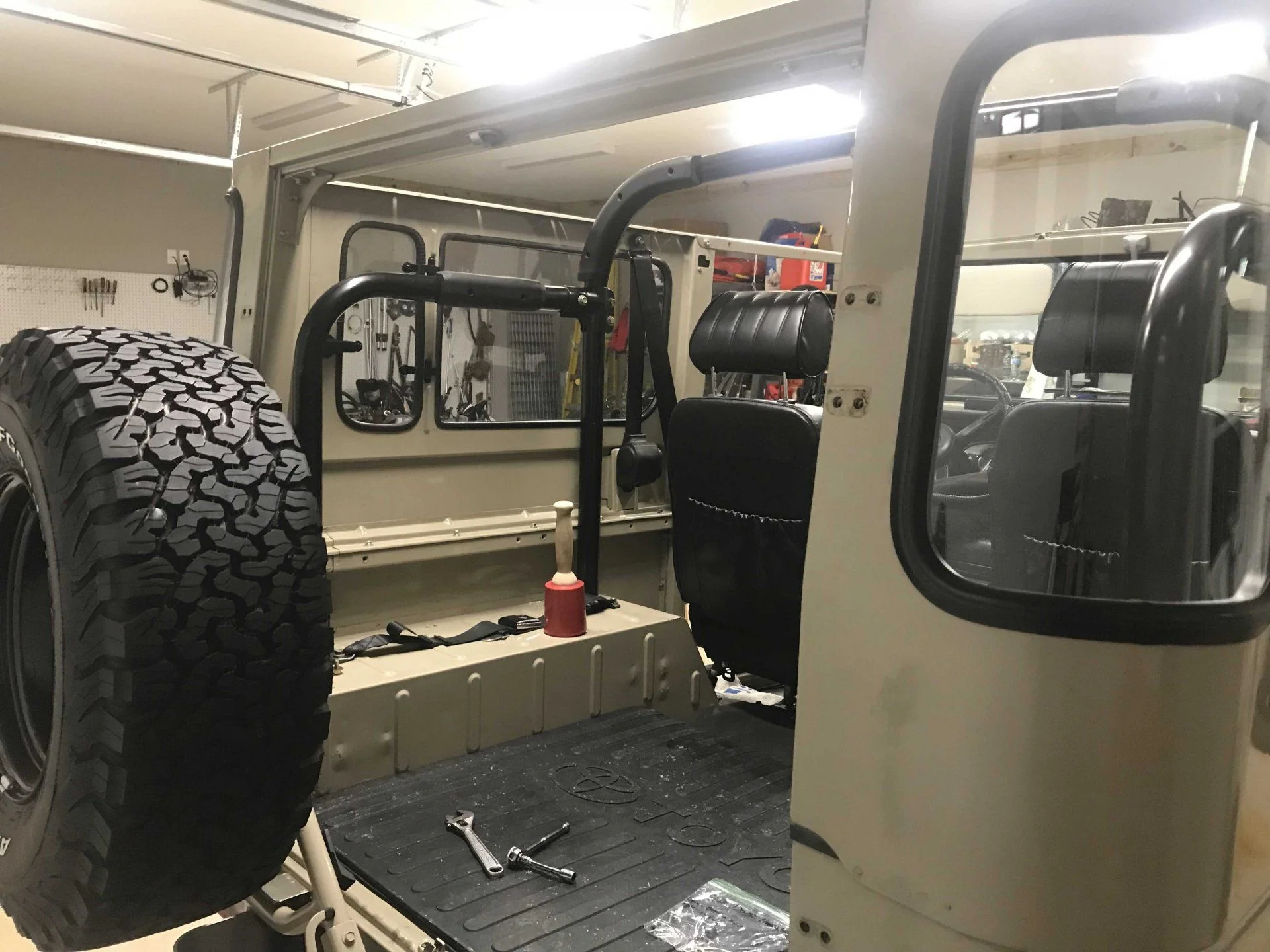

That or somewhere near the base of the rollbar. I didn't weld at the time, so I formed a bracket that bolted between the inside of the tub and base of the rollbar.
Was it common for people to move them from the hardtop to the rollbar when the top was removed? My 7/77 had them mounted to the rollbar but the top was off of it when i bought it too.
10/77 build and it doesn't look like I have mounts for the retractor. Looks like I will need to mount to the side.
Yeah, must be a mid cycle, "use all the parts we have until they're gone" thing on the 78s. Since the builds for 78s started 9/77 it looks like the 77 roll bars and jump seats went through at least 12/77 on the 78s.

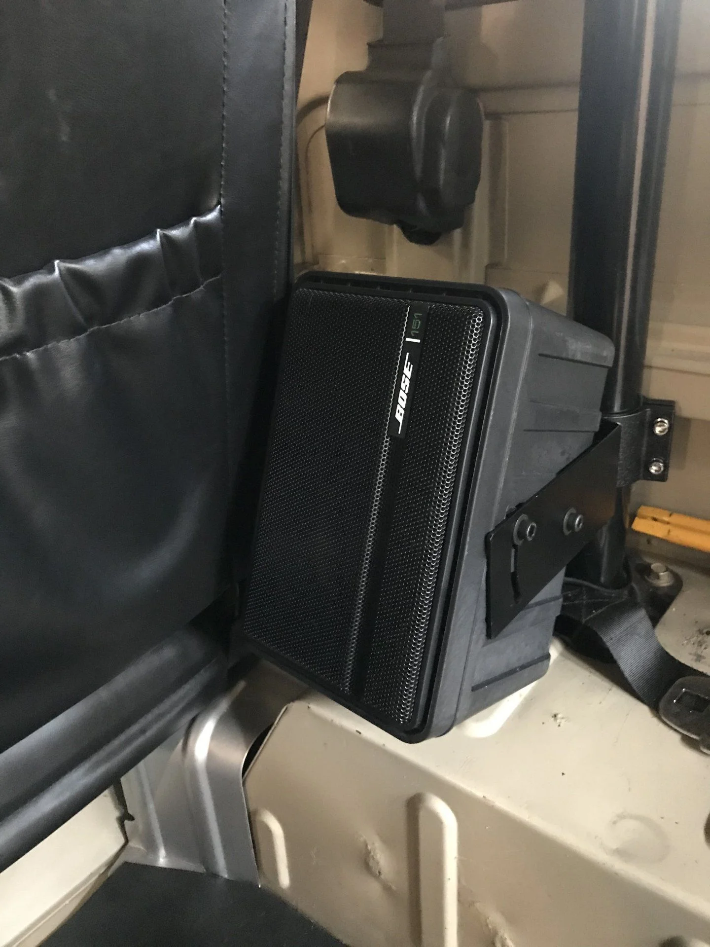

Here is what I did.
The retractor is on an "L" bracket that is attached with one of the roll bar base bolts.
