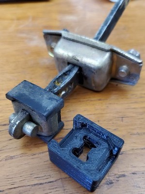

My issue was not the metal bits on the door check limiter, but rather the rubber/plastic bushing bit disintegrated. Below is a link to replacement I used with great success! Maybe a mud member? Great fit!
Yes, I saw those and mine were hardened and/or missing. But the bit that really wears is in the pressed metal housing. Obviously I don't know the condition of yours, but If you put a new door check in you might be surprised at how worn your old check evidently is. My doors are now firmly held in place at the maximum opening.
