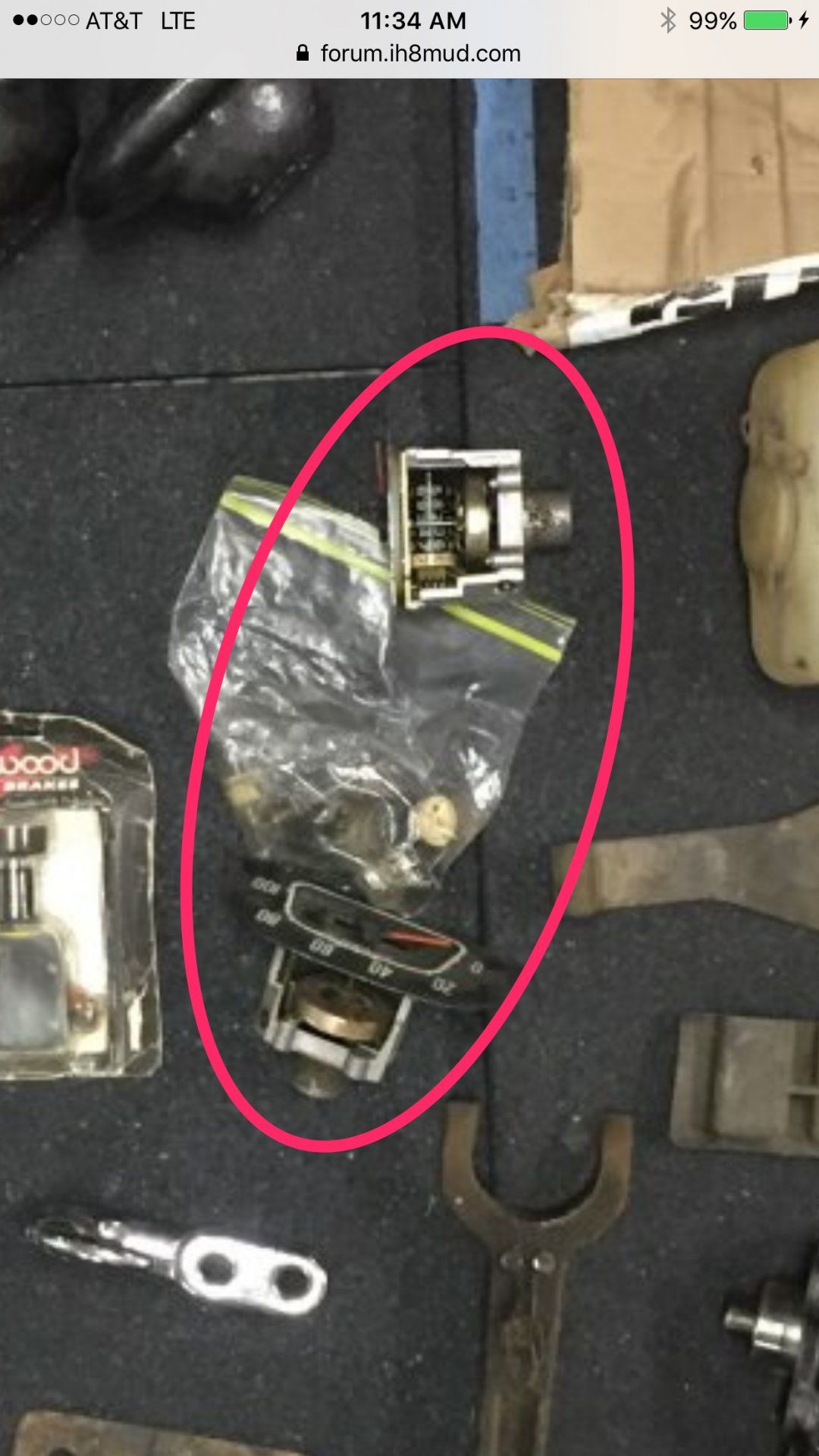

I did not do that, but I did take it all the way out and cleaned it thouroghly. All of he numbers turn fine except the white tenths won't turn the next digit. It is like the gear inside the odometer is worn down. Ideally I would like to buy an odometer from someone. Thanks..
Found it in a photo. PM me and we can work things out. I will test it tonight.
