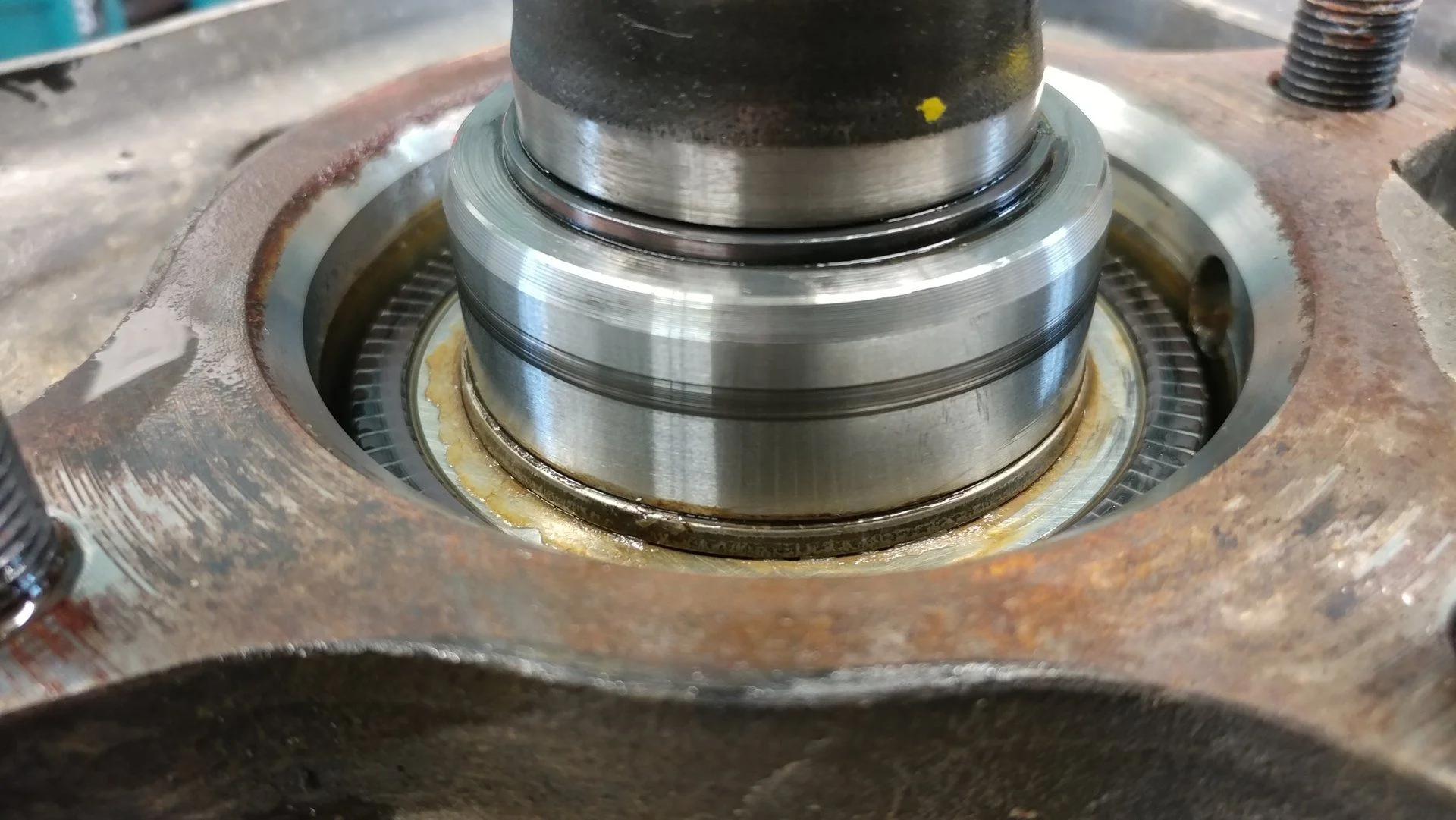

Just heard from indy- he's gotta pull the bearing to replace the inner axle seal and doesn't have the tool to do it. Tool guy is on vacation until Thursday. Do we think this might be a fun project to play with vs the diff bushings?
rear axles seals are a 1-2 banana job.
Seals yes, but if (as noted) the bearing has to come off, then this goes from 1 banana to about 10 bananas.... If it is anything like the GX, the retainer needs something like 50 tons to press off, it WILL destroy the bearing in the process and to press the new ones on takes a special jig.
It may not be like the GX, but that looks like all the other toyota semi-float designs I've seen and every one I've worked one required a torch, chisel or grinder (or combination there-of) to get the retainer off.
I have never looked at the hundy rears, but it sure looks similar to the GX rear. What does it look like inside the backing plate? Anything like this?
It's pretty similar if not basically the same.
That's kind of what I was afraid of. I was referred to one shop in town that can do the work but not until Monday.
I'm going to double check to see if my breather was clogged. Highly possible. If so I'll clear it and have them button everything up, and monitor for a week or two before digging into that project. Hundy guys say that just clearing a clogged breather can fix a leak from pressure.
If it's already clear, I guess I'll deal with that then...
In our case the seal was fine-ish, the little black ring you see on the retainer is a groove that was letting oil get by. The bearing was likely fine, but getting the retainer off basically destroys the bearing. The seal is a knock-in into the end of the axle tube, so if the retainer is not grooved the seal is pretty straight forward.
