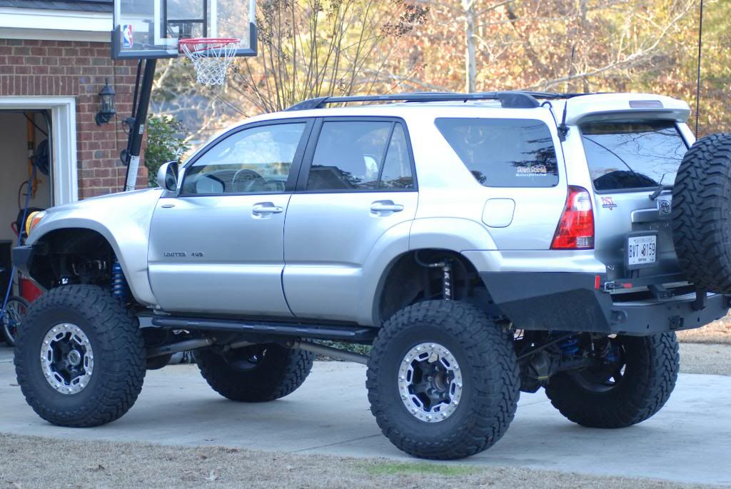

well, the fenders really help for stuffing at flex but at ride height I've only been able to bring it down about an inch or so. The front fenders look so much higher because the rear wheel wells are still stock. If I bring it down too far the truck looks like it has a crazy rake to it. I actually like it where it sits now and it's onroad manners are really pretty good.
I can also only bring everything down so far due to the panhard and steering arms proximity to stuff under the engine bay. Also the 37's are a bit tough to get in the rear wells too far.

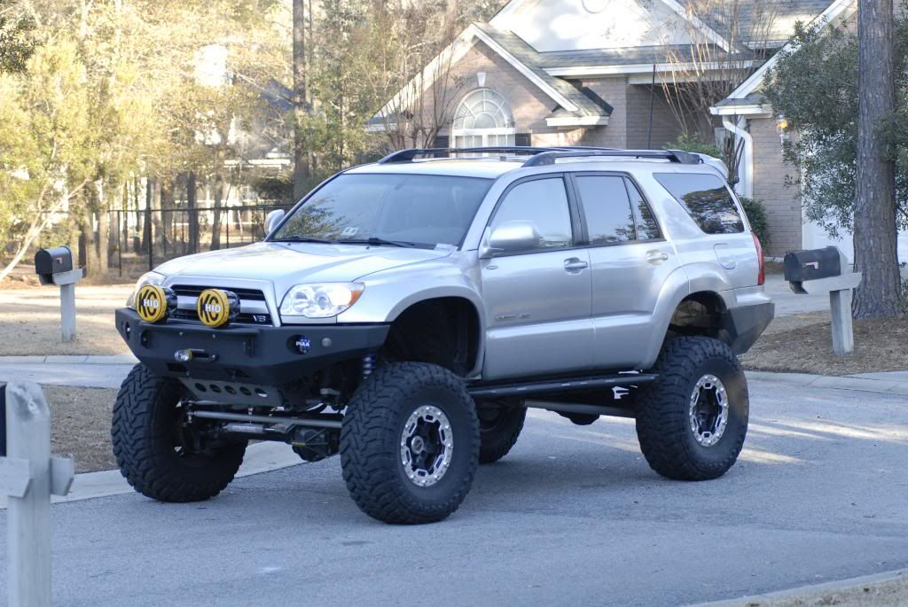

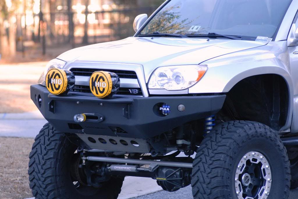

I recently changed up a couple things, decided the truck needed a little bling!! picked up some rock rings from OMF for the new beadlocks.

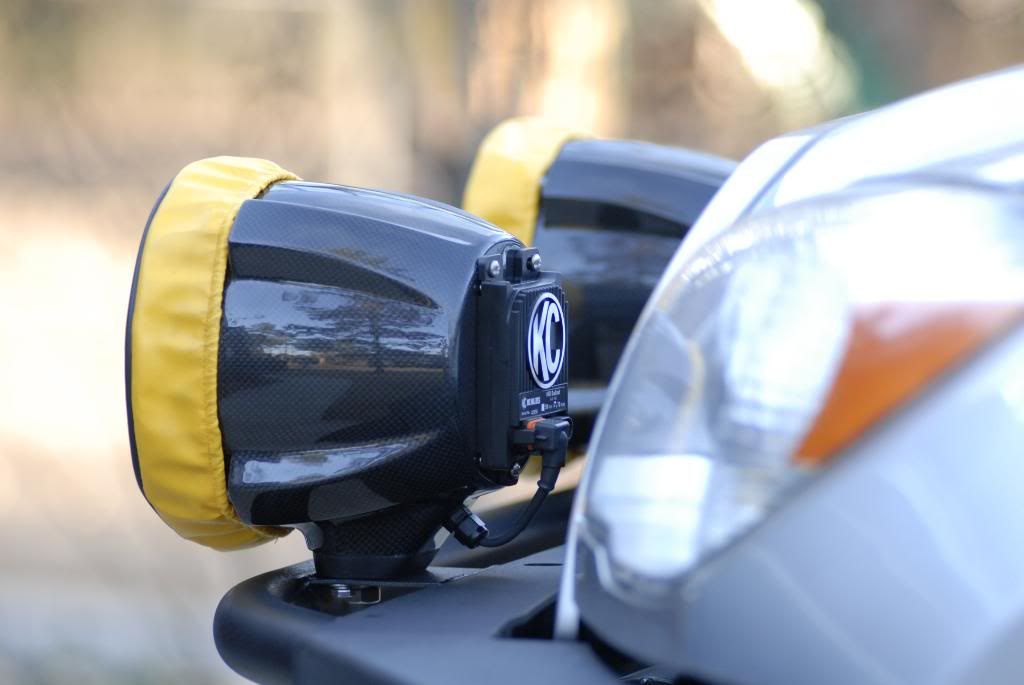

Also some bling lights. THey're 70W HID's, supposed to be the brightest lights available. I don't have them wired yet though, hopefully this week. They're too deep for the bumper so I just added a small tube to make a light bar. Later I think I'll come up with some more tubing for protection. The lights are too expensive to run all the time so I'll substitute something else for daily use.
