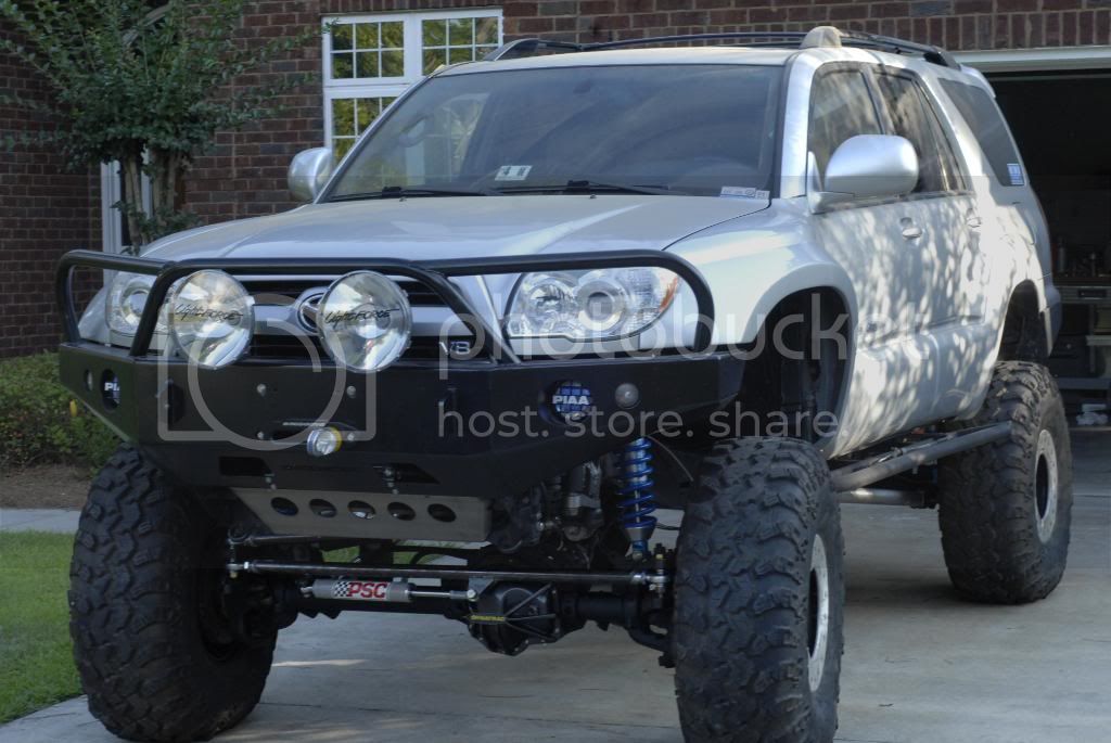

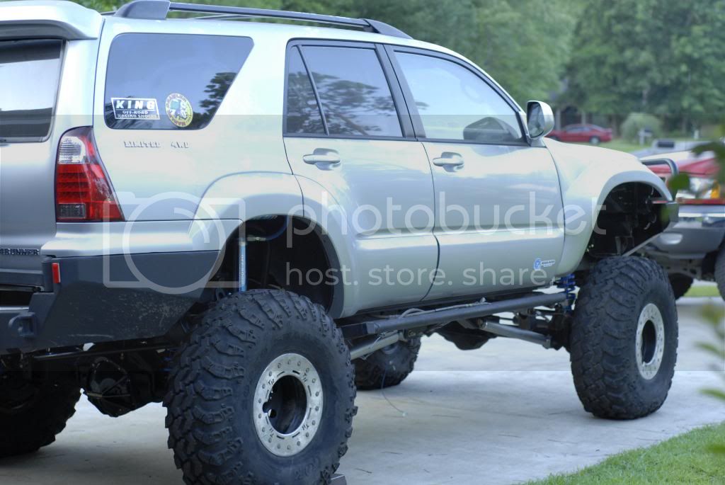

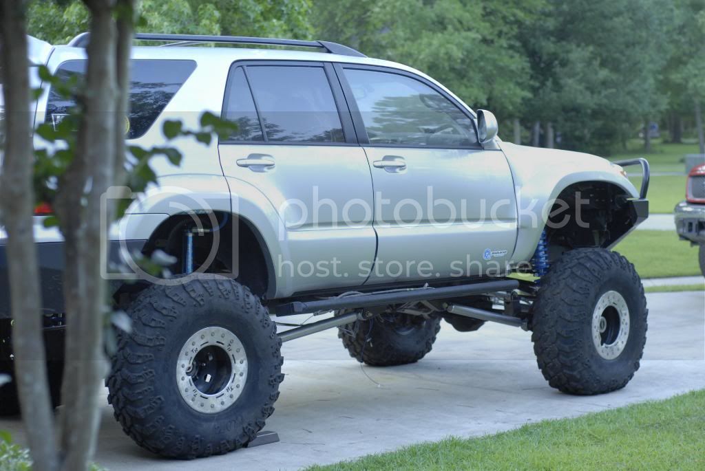

anyway, here are the latest pics, I just got it out of the garage for the first time today so needless to say, it was a big deal for me after spending nearly every second of free time over the last few months getting it to this. My kids nicknamed it "THE PUNISHER!":D
Here are the basic specs for the SAC:
Front/Rear 3-Link
Front/Rear Dynatrac ProRock Dana 60's (4:88 ARB rear/Detroit front)
Front 14" King coilovers/ rear 12" King shocks and custom springs
Branik Motorsports Alluminum links (2.5" main links/2.0" 3rd links)
Mix of Ballistic joints, Poly bushings and heims for the main links
PSC Hydrualic assist
15x10 TrailReady beadlocks w/ 37" Iroks
Marlin Crawler Lefty 4.70:1 XD gear set (twin sticks)
Front/Rear Double Cardan driveshafts
...not drivable yet, but it's getting close

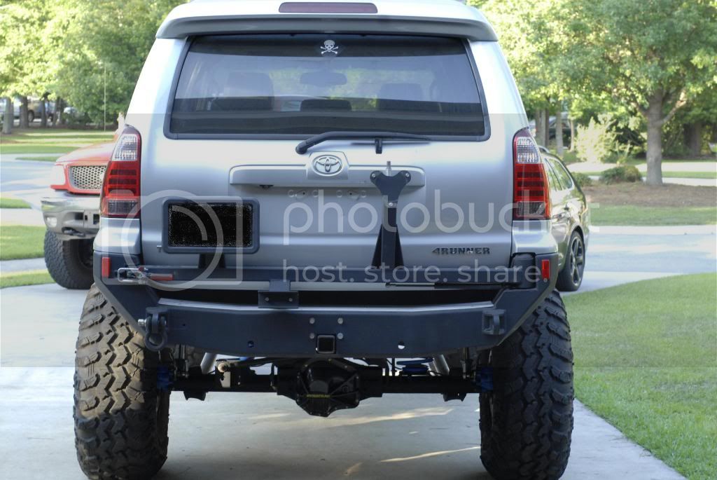

Man that thing rocks, nice lines on the bumper:popcorn:

Nice rear bumper ..
it reminds me of the one IPOR did sweet

I am keeping the auto trans. I put in the new Marlin Lefty (same as the Inchworm with slightly different internals) and I honestly haven't got all the electricals hacked just yet.
I copied another guys spring rates that had a similar setup to what I built. I wasn't sure what my weight would be, he is around 6000lbs, I may be a little less over all but slightly heavier in front with the V8. The rates are 300 over 350s. He said the one thing while valving and messing with the springs he learned was no matter what he did to get it to be better handling on the street, it would still flex about the same off road. ...got my fingers crossed. I figure I'll probably have to re valve/ spring at least once or twice to dial it in.
Thanks about the bumper, that was the first real project that made me think I could take on this rediculousness in my garage:hillbilly:
THat's my friend TIm's, his was the first ever late model 4R SAC. Thanks to him and IPOR, a lot of my problems got addressed prior to me getting to them. They built a seriously bitchn' truck, just wish they didn't take so damn long to get it done.

The fronts are 15 over 12 with one bleed closed and the rears are 12 over 12 with all bleeds open. I have a sway bar in the rear but not the front. I really need to drive it a bit and go from there.
Sonny at Downsouthmotorsports is who built them for me, it'll probably take a few adjustments to get it just right. We're also looking at King's new compression adjusters to possibly help the body roll on road. ...we'll see.
I'll post up the shock tuning progress as it comes.

Thanks, and no problem man, gotta take the good with the bad. I've had a lot of advice and comments along the way. I will probably run this combo for a while. Any bigger right now and I have to start limiting articulation and I'm geared for 37's. As far as getting it lower, I could probably get the rear lower without too much trouble but the front doesn't have as much room to come down. I even had to put a small bend in the front panhard to get full travel and clear the pumpkin on the Pro Rocks.
