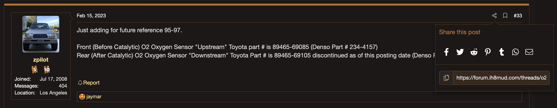

89465-69085 is the front.
89465-69105 was the rear... Discontinued.
234-4153Denso o2 sensor long
234-4157Denso o2 sensor short

I have an OEM 89465-69085 put away for my wife's truck. I just looked at it and it is indeed a Denso. Lifespan can also be affected by engine condition, catalyst performance, and environmental conditions.

Here is the Denso cross reference page showing the 89465-69105 being 234-4153 on the Denso side. I'd go with that application since OEM is gone.

Yo LBC dude, you don't have a choice, but to use a non-Toyota boxed Denso unit for at least one of 2 o2 sensors. You will pay a few more dollhairs by going with the Toyota o2 sensor that's still available from Toyota (89465-69085 / Denso Part # 234-4157 equivalent).
On my '97, I've been running the Toyota boxed o2 sensor and the non-toyota boxed denso 234-4153 with no issues, but as already mentioned, longevity will vary depending on condition of vehicle, how it's used/maintained, etc.
