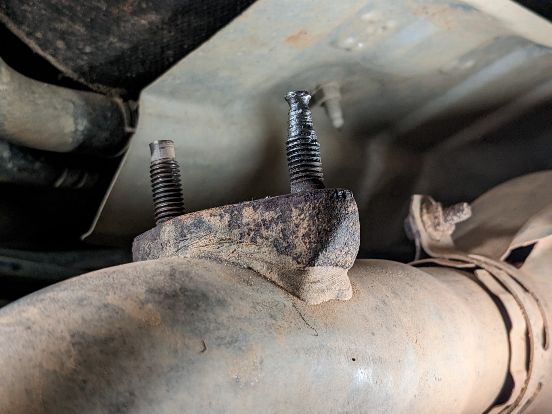

As can be seen from the photo, one of the downstream O2 sensor studs is messed up. I tried cleaning the threads, but I can't get my thread chaser started (M8x1.25). All the other studs are great. Any solutions here?
- Is the stud replaceable?
- Is it possible to salvage the stud with some other thread repair method/tool?
The studs are not serviced by Toyota. You buy the pipe to get them. If you can get it out a 90116-08020 might work. That number is an intake manifold stud for a 1FZ

90116-08211 may also work. I'd be inclined to try that one first. It's an exhaust manifold stud for the air injection pipes on a 93-94 1FZ.
Just wanted to close the loop.
I was able to remove the old stud thanks to the power of magnetism and Liquid Wrench:
New stud installed:
New sensors installed:
Only replaced the damaged stud, but used new nuts.
The stud is part number 90126-08001
And the nut is part number 90179-08059

My LX is a 2005. I'm not sure why they would change the O2 sensor bung between model years, but all is possible. I was originally going to use a torch to heat up the stud for removal, but the location so close to the body made me think twice, hence the induction heater. Once I committed to using the induction heater, there were no further issues.
Thanks for getting back to me so quickly. I looked at it again this morning and decided to remove the cat. I didn't really have a way to grab onto the stud once I got it lubricated and heated up. With it removed, I heated it with a propane torch and then hammered on an 11MM extractor socket and the nut broke free. The threads were a little damaged on the stud, so I repaired those and now it's ready for a new O2 sensor. I think I'm going to put on a new muffler, so once I get one, everything will go back on.

You can grab the top of it with a 5mm socket. There are no torque specs in the FSM, just use German torque specs. If you need to re-tap, it looks like it's a 8mm, 1.25.
also, my situation might be slightly different from yours - my stud sheared off to the point where only 2-3 threads are showing when i put the 02 sensor on. it was enough threads to where i could get some purchase with a standard M8-1.25 nut (i.e. not the oem nut where the threads don't start immediately), which i'm hoping is good enough.
do you think i'll still be able to remove the stud if i get an induction heater? given that i probably have just enough stud surface to grab with a pair of channel locks...
!! and you did it all without removing any exhaust components?
Nope. I did it on a LX that I sold and I did remove the exhaust section.
I would think it's possible to do it with the exhaust still attached, but only if you have minimal rust.
I'm about to do it again on a LC and I'm going to remove the exhaust and do it right. Re-tap the threads and properly torque the nuts.
